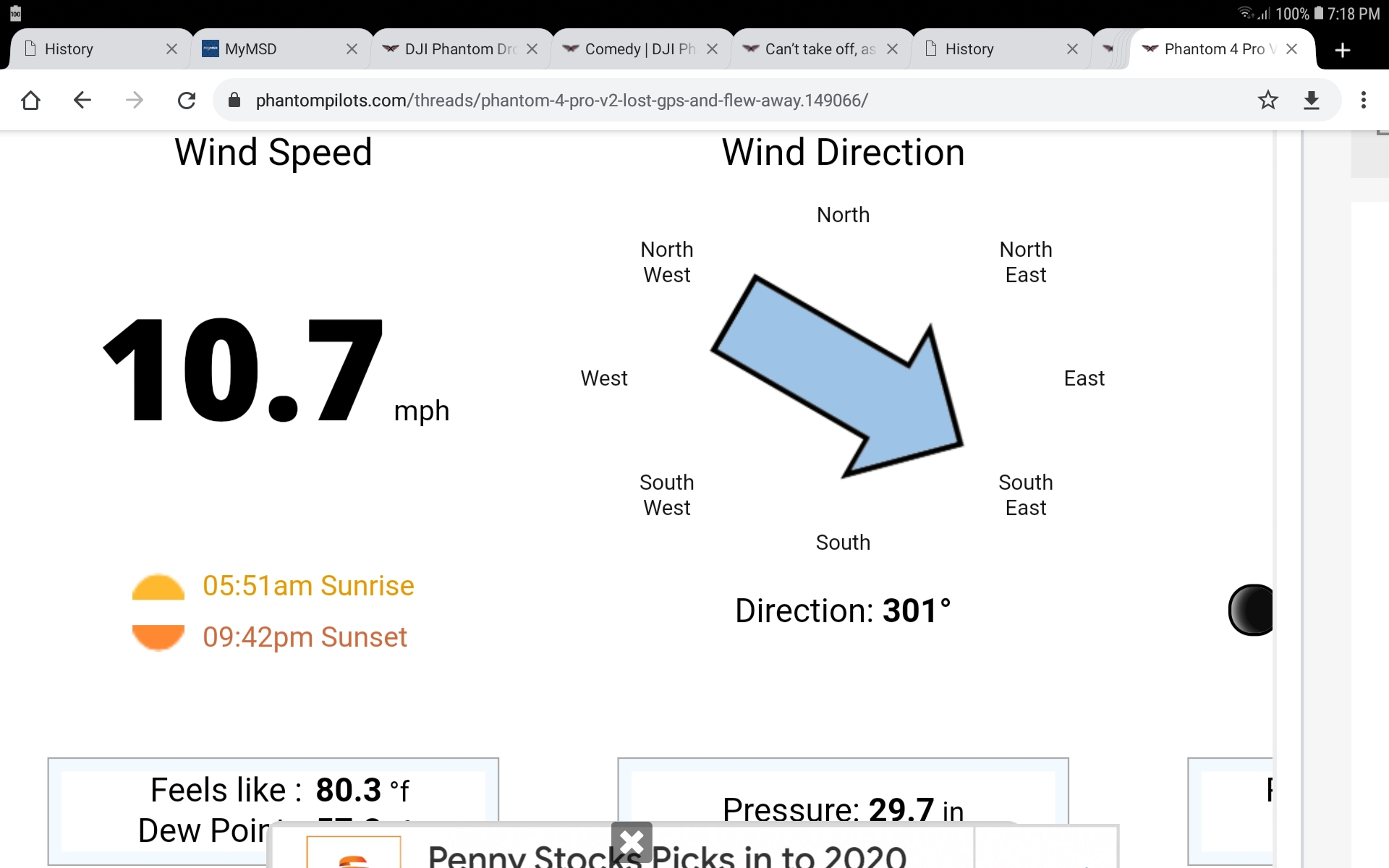

Is it possible to calculate battery remaining time at 9:16 when pilot give up with amount of wind speed and direction ,,if the wind stayed south east direction till it autoland or (crash),,,,,was just crazy idea I was having but I would go that way south east for a while if possible,,,,if it was traveling at >100mph if would have covered some ground,,yip just a thought,,,best of luck @Cori51.

Unless it had 60mph tail wind I doubt it ,copyed that from above post,since the pilot gave up I presume it be drifting in atti mode at wind speed,,,,,this is a area dji should look into,,a failsafe RTH, because it only works when it has GPS,,it should work with or without GPS with a press on the RTH in these times,,toy drones have one key return and often dont use GPS,,phantoms which cost 30 times more dont work like that,,why is this ,,

Um bad data good data the wind say which way it went ?,it wont fly into or against wind in atti mode so grab the dog and go for a walk

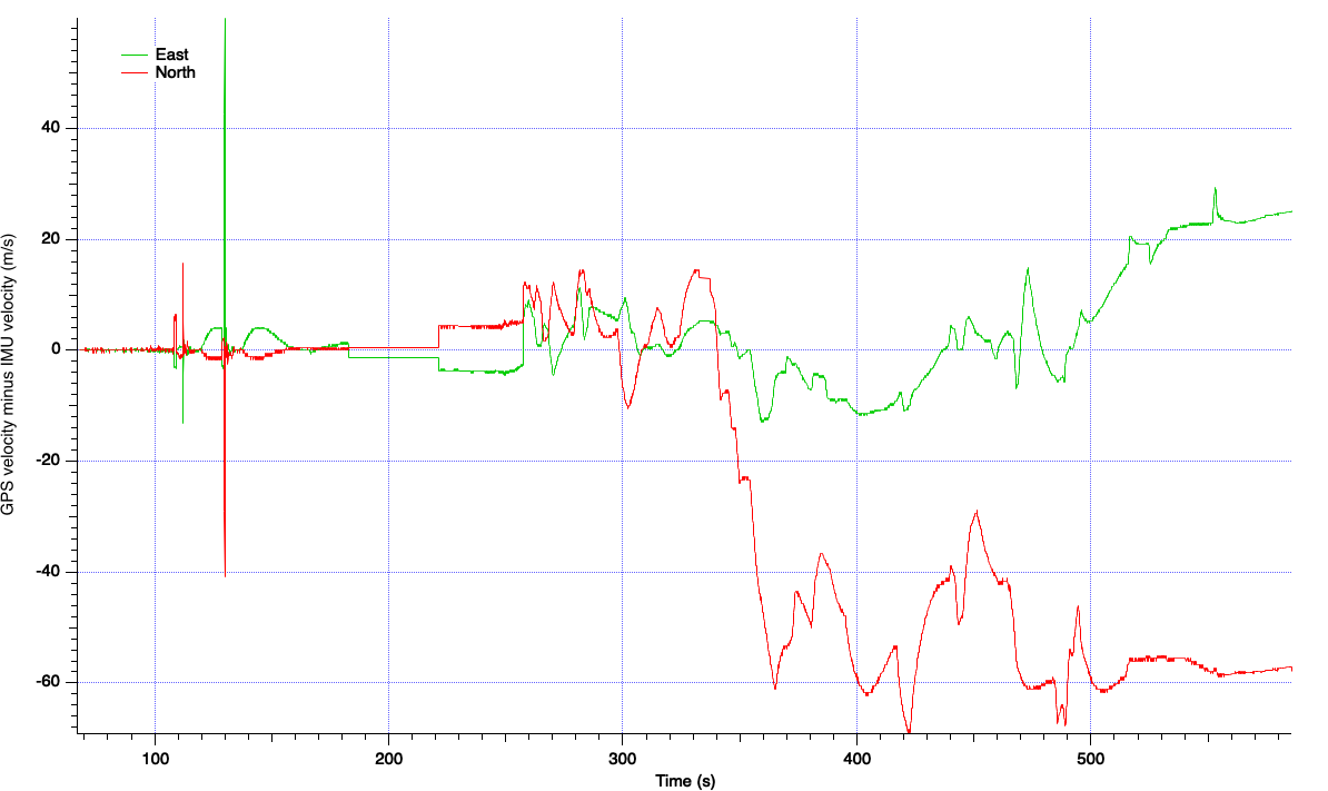

I'm afraid that this one is going to remain a mystery. The aircraft switched to ATTI due to the GpsPositionNoMatch flag, not because of a lack of satellites.The txt log doesn't generally continue to report position when that happens, so I wonder if it is a slightly non-standard implementation of the DJI SDK.
That said, I think the position reporting is incorrect, since it leads to the following velocity record:
That has the aircraft moving SE at 62 m/s, or around 140 mph. The winds at 110 m were nowhere near that speed, and so it really isn't physically possible, which in turn means that the position data are worthless. All we can say is that it likely drifted some distance SE, and then will have autolanded on loss of uplink (default failsafe in ATTI mode).

Me dont need technical data anyway,,common sense say which way it went
