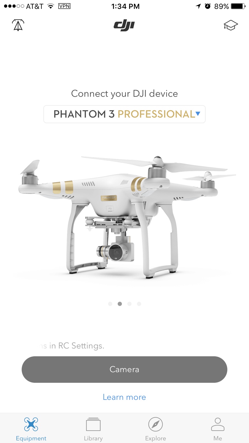

HELP! PHANTOM 3 ADVANCED APPEARS AS PROFESSIONAL IN APP
I wasn't sure, because his screenshot didn't have the little blue tick-mark next to the model name.
Yes I do not have the blue tick mark. I just had to stop posting because I really want a solution but somehow I know what I did specifically and I did nothing wrong. I upgraded with the right firmwares, etc. Recently I travelled back to my country and tried again and it showed advanced so presently here is my predicament. It shows advanced and sometimes shows Professional and this is frustrating because when it shows advanced it works fine. When it shows professional I have to wait for some weeks. It's so frustrating

This is my error ->
