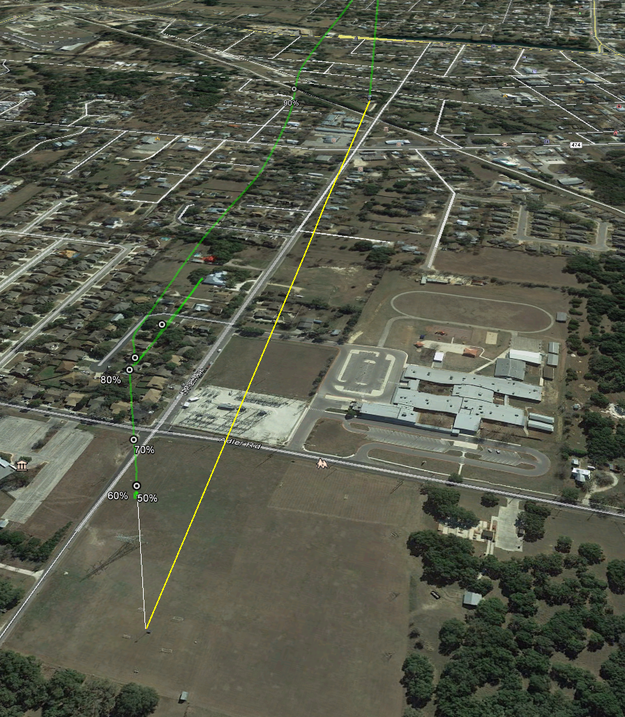

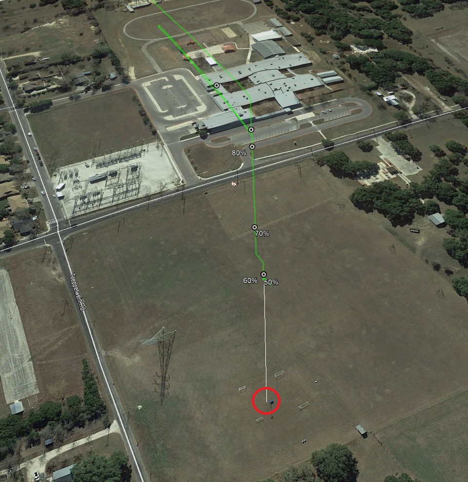

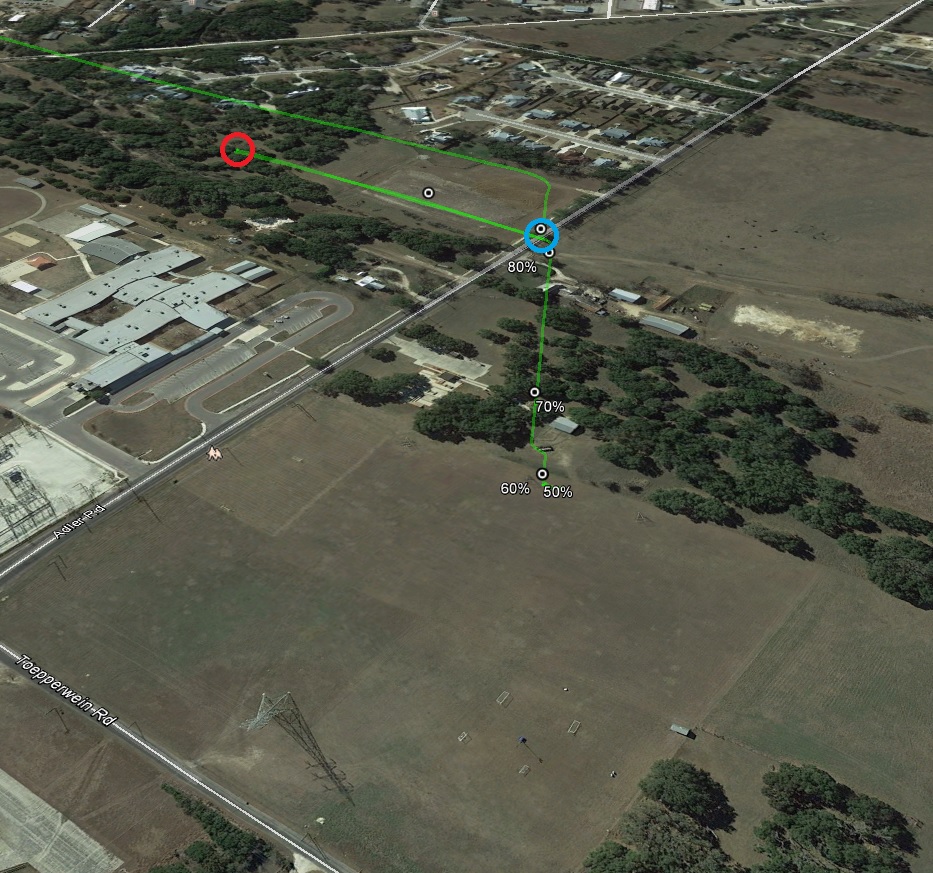

RTH was initiated at 3m 27.2s (blue circle below) and cancelled at 3m 34.6s (red circle below). The Phantom was then flown back to the spot where RTH was initiated and it hovered there for most of the remaining flight. After commanding the Phantom to descend, it eventually descending far enough for it to lose the downlink and most likely the remote controller signal.
Using the default settings in DJI GO, the Phantom will return to the home point when the remote controller signal is lost for 3 seconds. If the "Main Controller Settings" --> "Advanced Settings" --> Remote Controller Signal" lost setting was changed to "Landing" or "Hover", the Phantom would have landed here:
I'm assuming that was not the case though since the RTH at 3m 27.2s looks like it occurred due to a lost remote controller signal. I think it was just too windy for the Phantom to make it back to the home point. Weather Underground is showing the wind speeds were around 15 MPH with gusts around 23 MPH during that time. The flight log shows the Phantom was traveling at 40 MPH on the way to the field and was tilting to fight the wind as it hovered over the field.
Since the Phantom did not return back to the home point, it most likely auto landed on its way back to the home point when the battery reached the critically low level. If you want to track it down, walk the yellow line below from the field back to the home point until you find the Phantom.

I've done the first pass on the yellow trail- no P3. The path is fairly open, but there are some treed areas. Would it try to land, even if there are trees below it? Trying to know how carefully I should search tree tops.
If the RTH was initiated at 3m 27.2s (blue circle above), should I be searching that area as well?
Assuming it had enough battery, would it have traveled on the yellow path past the initial takeoff spot (home)?
These are going to be dumb questions, but just remember- I'm the looker, not the pilot.
Yes it will land regardless of what is below,once it reaches critical battery, so yes it could be in the trees.

Msinger, you are Sherlock!!! I found it, completely unharmed, right along the yellow path! You are amazing.
I am so incredibly grateful and appreciative of the effort you all put into helping me. What a great community! Now, I'll get to reading on how to make sure this doesn't happen again.
