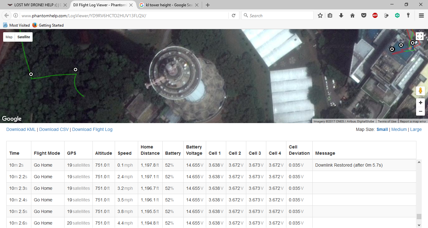

KL Tower is the seventh-tallest tower in the world by pinnacle height at 421 m (1,381 ft) according to Wikipedia. What I don't understand is it started to "Go Home" at 10m 2s. 13 seconds later it goes back into GPS. It was headed straight for the tower when it changed direction, almost as if it was going navigate around it.
It briefly lost downlink at that earlier time and went into RTH, which was cancelled when the downlink was restored. I don't think that was related to the final loss of signal or subsequent behavior. It had no way of knowing that the tower was there. The direction change was due to right aileron being applied at 10' 21".

It's pretty clear that you lost signal because you flew behind the tower and it was well below the top of the tower.
Your Phantom initiated RTH and attempted to fly straight home right through the tower.
It was already higher than your RTH height setting so would not have climbed any higher to come home.

Look , you flew behind the tall building and lost signal, you RTH altitude was set below the altitude you needed to clear the obstacle and it flew straight and level into the obstacle just as it is designed to do......what more do you want?????

I have to agree with the other comments here. Ignoring any issues surrounding the legality or advisability of flying at those altitudes in that location, you set your RTH height too low for the intervening structures and then flew directly behind one of them (the tallest in the area in fact), lost uplink and downlink (not surprising) causing RTH with a model with no obstacle avoidance. It may be embarrassing but all the evidence says that it was entirely pilot error.
