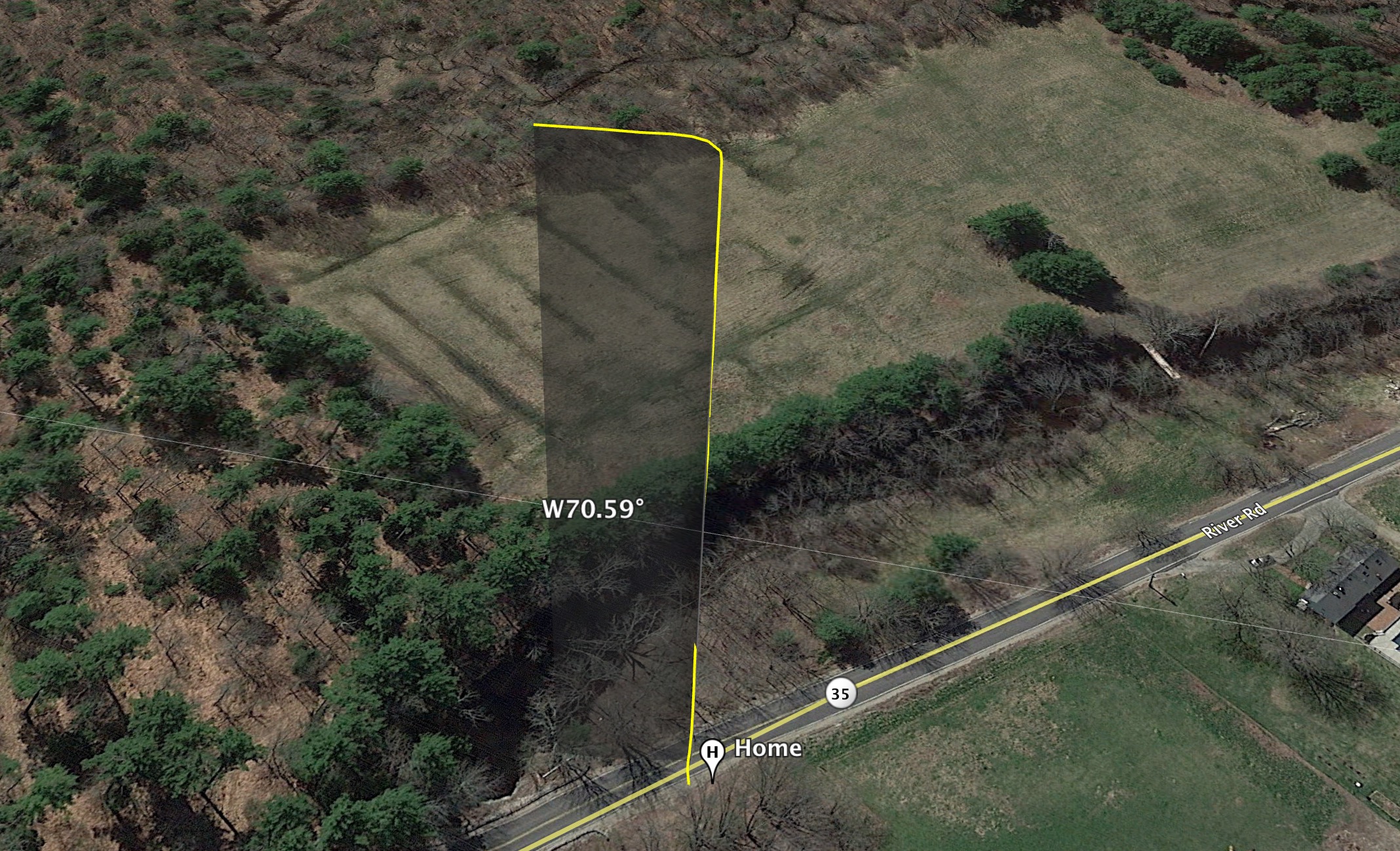

So the picture of the travel of the drone is where it crashed ?
So you didn't hear the motors stop, for example?
The image shows the final recorded location, 390 ft AGL and 80 ft south of the home point. There are no data in the log to show what happened after that. If it lost power then it would have crashed pretty much directly below that point - perhaps 20 ft further south. That looks like the most likely explanation based on the available data but I would have been more confident if you had said that you heard the motors stop.
Well yes I didn't hear it and then I heard some leaves chopping that's when I knew it crashed...
So I should go look at the location at the end of the yellow line ?

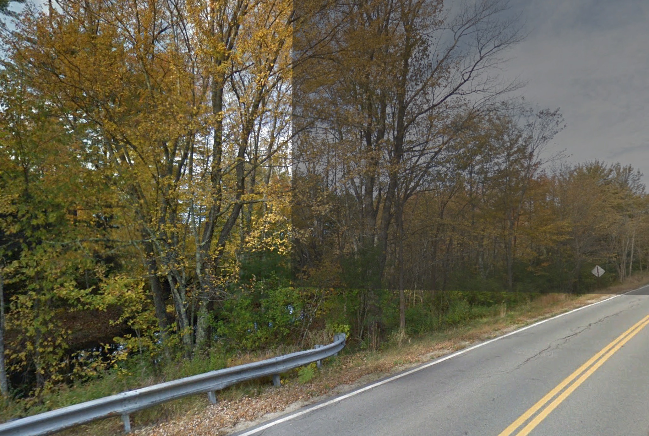

In that case yes. It should be 30 ft or so from the edge of the road where that crash barrier ends.
