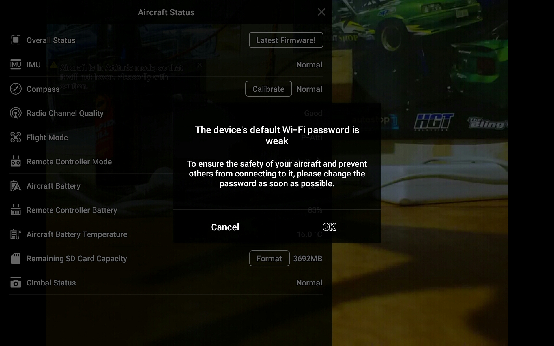

Um yes just tryed mine out of curiosity,,I turn airplane mode on then select djigo,I click on p3s on the list , turn my wifi on and couple seconds it shows searching for wifi then conects to phantom with blue cam logo,,have you tryed just going into app and apply the wifi password that way,,,,one thing that happen while I was trying this I get a prompt..gezz I didn't know someone else could conect to it,,anyway that's how mine conects,,hope you can sort it,be watching[.ATTACH=full]103002[/ATTACH]...just add to this prompt,,,I think it talking rubbish because if somebody trying something they would have to link their remote with this craft so I see this as a big wrong on dji,,a prompt with no purpose

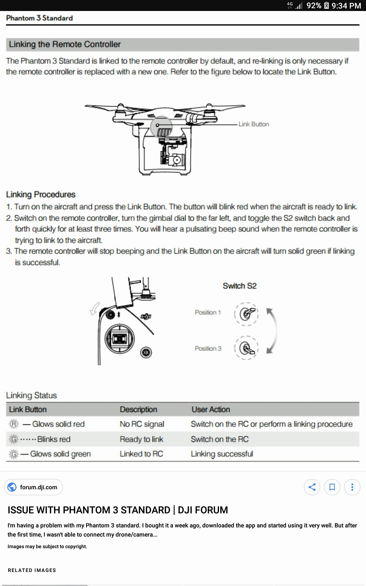

Can you please describe infinite loading,or a screens shot,you say it linked,what colour lights going on,can you tilt cam with gimble,if so it sounds linked,I was thinking lastnight of a manual link,tryed that,just in case here's a pic,try the manual way before opening or trying to open the app

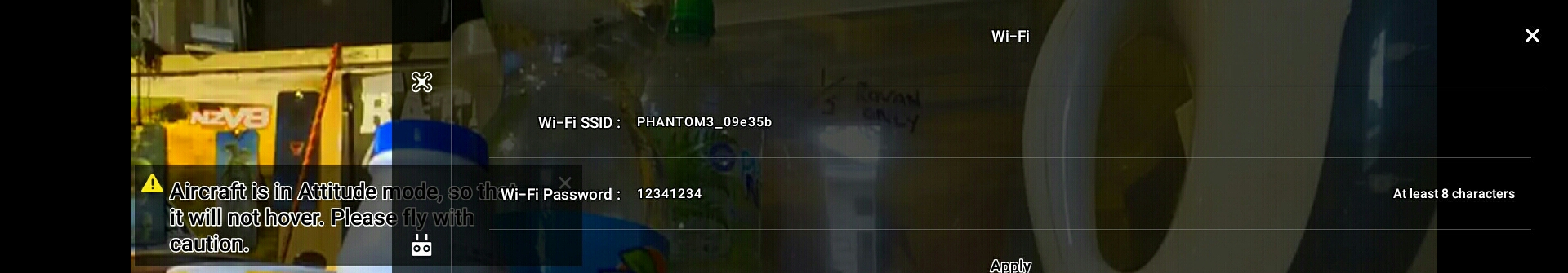

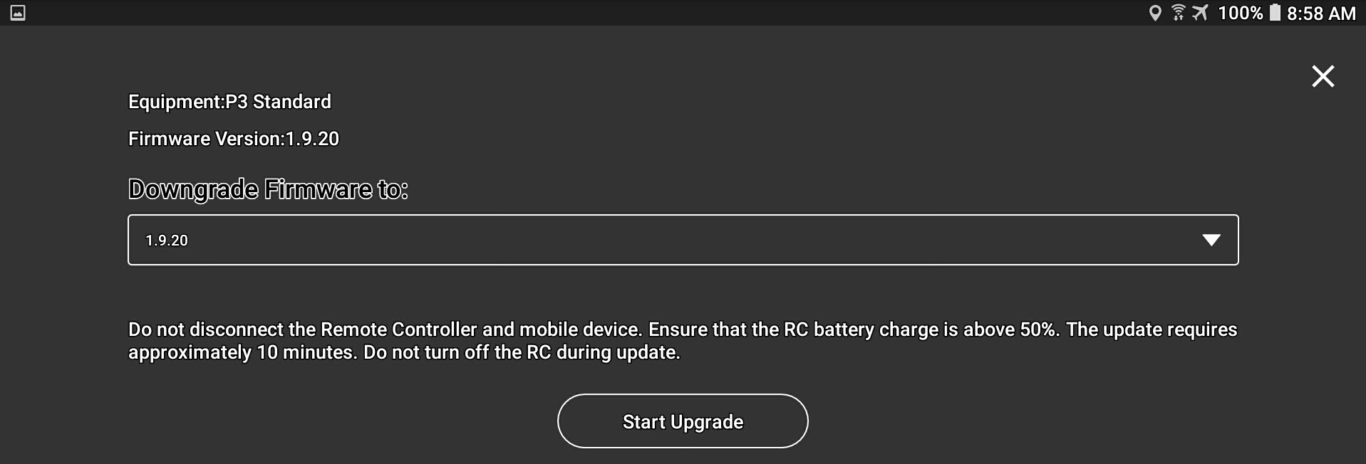

Um mm hands full on this issue,unsure on what phone you got still no metion but don't think your phone at fault if it conect to other ok,,we're you able to see what your wifi password was set at,mine read this,,this original from couple years ago and still same, when your phantom is on home screen have you tryed holding those 3 black lines top right to bring up firmware change,,have you tryed this with any result,,,,me going to have to have good search,,almost thinking something gone bad with the wifi somewhere in drone or rc,I have to have a search me still very green on this subject cause I always avoid it but time to learn,off searching now

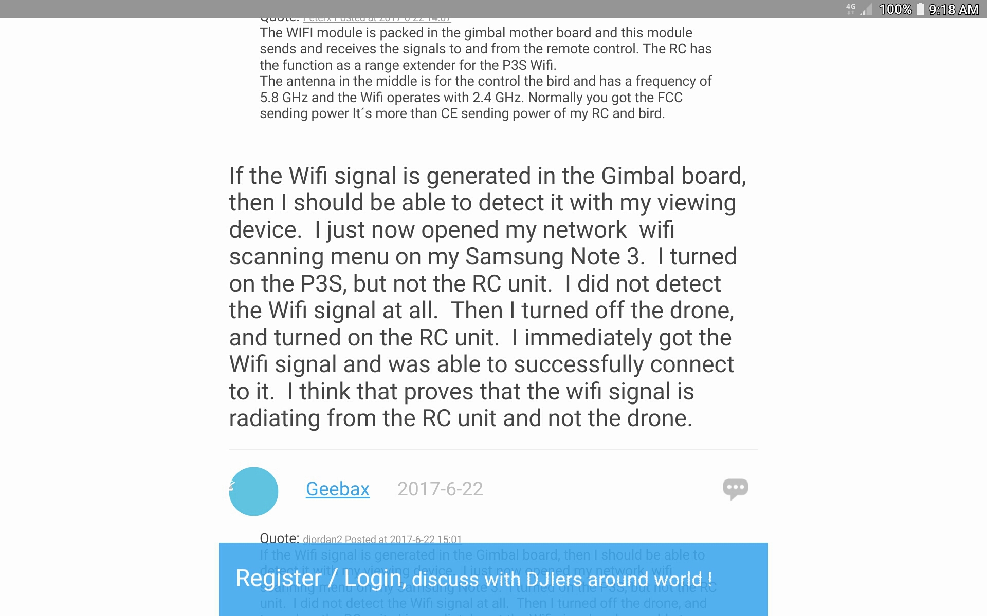

OK me find this,,,mayby this gimble board thingy at fault,,,try method this flyer used,might work,just turn on ac and leave rc off
,,,,leave airplane mode mode off for now it could be somehow cancelling out something,
