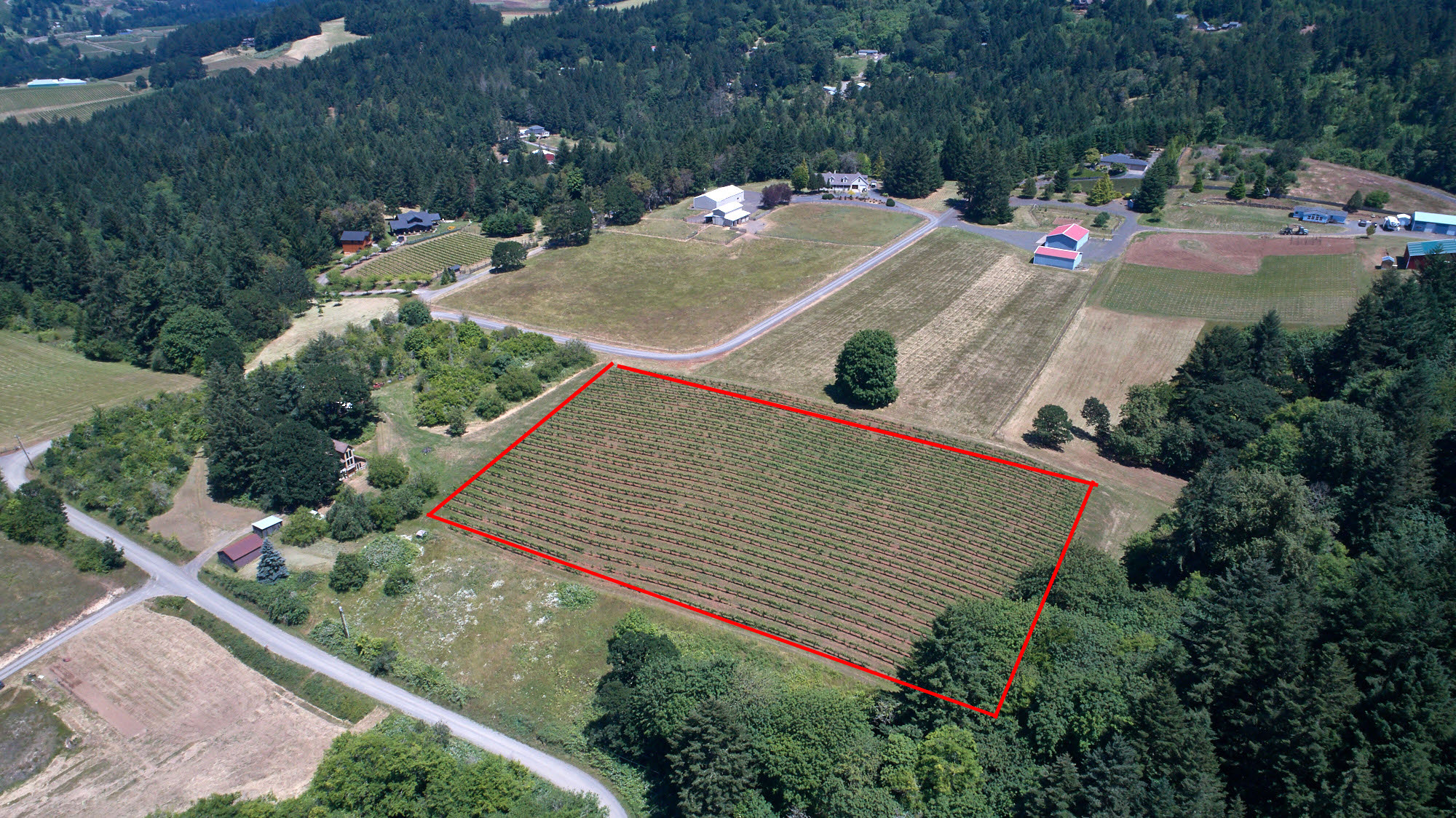

The attached image shows a 3 acre vineyard in the foreground. While not pointed straight down, my P4P could have easily covered the 3 acres from a legal height. With the angle there is probably well more than 50 acres in view overall.

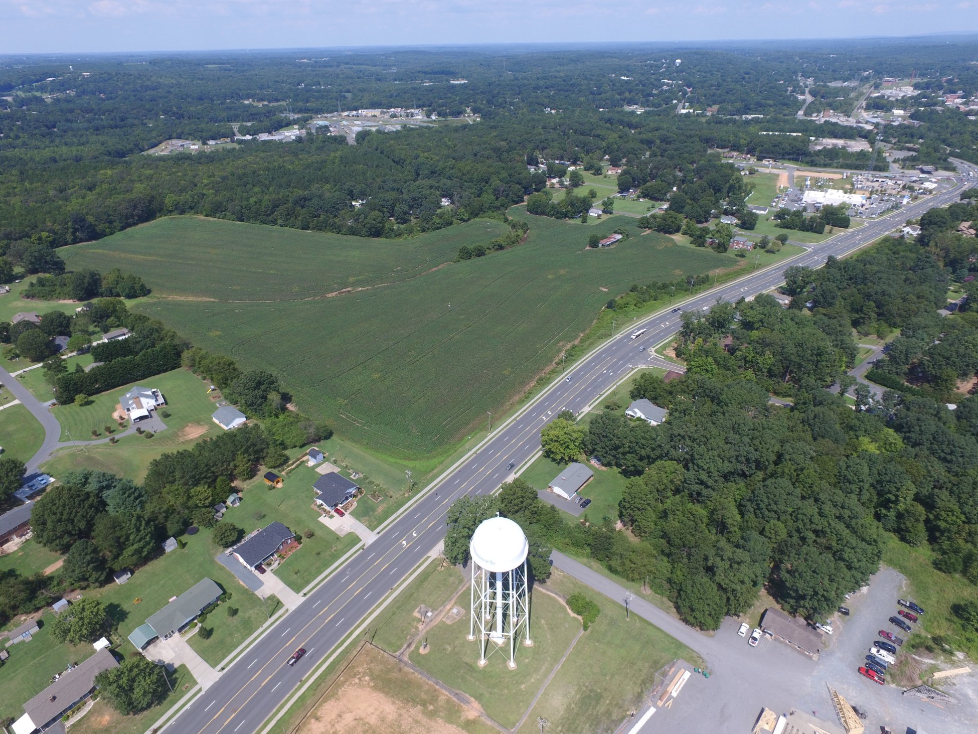

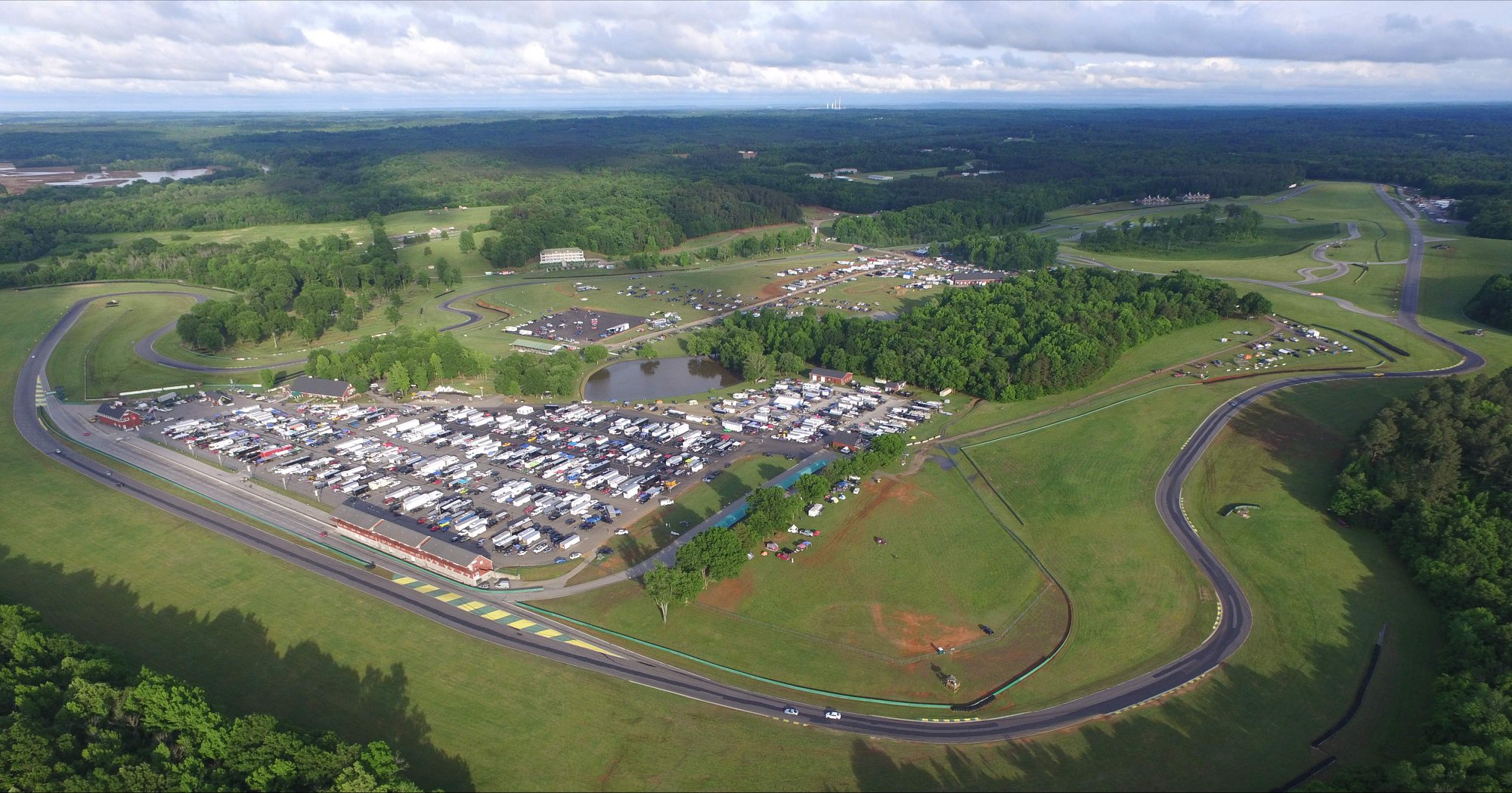

from experience, 50 acres is easy at 400' with my P3P. Larger properties must be shot further away or as Panos. I have several hundred acres of land, and often shoot automotive race tracks, and wish we could go higher.
