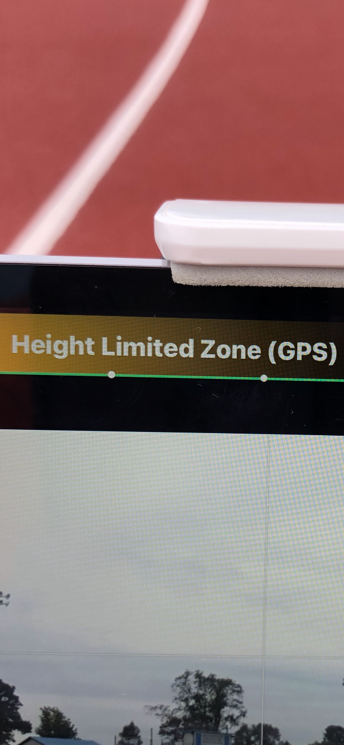

This was in the top left were (good to fly) usually is .Height Limited Zone ( GPS ) & Altitude Limit 492ft. ????

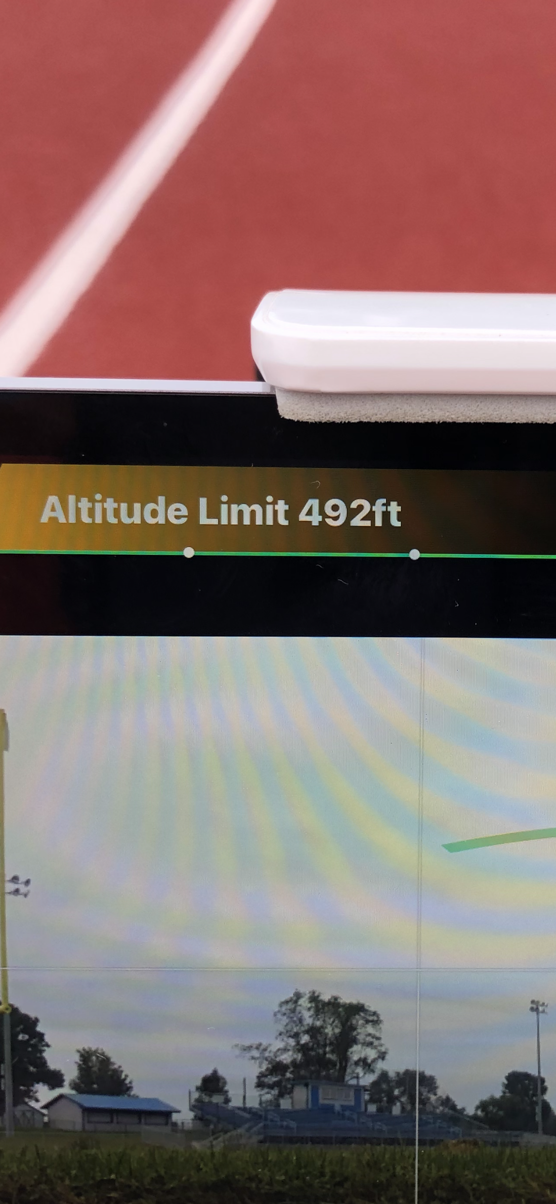

Setting the upper limit to 492ft is nonsense as it is generally allowed to 400ft.
That is a GEO Zone warning when you fly within the range (5 mi.) of a tower controlled airport in the defined triangular-shaped landing/takeoff zones aligned with the main runway. I see that warning all the time in those areas. It has nothing to do with the controller altitude settings.

Yes, I understand that but sending the message about 490ft limit to the drone which legally must not fly above 400ft is nonsense, or at least hard to understand. Or this is for manned aircrafts not to fly under that limit? But how should that be relevant to the drone?
I did check my controller it was set for 400ft.Were I was flying there are no airports around for 10 miles +
The drone did fly with no problems. I just never seen this message before and I have been flying this P-4

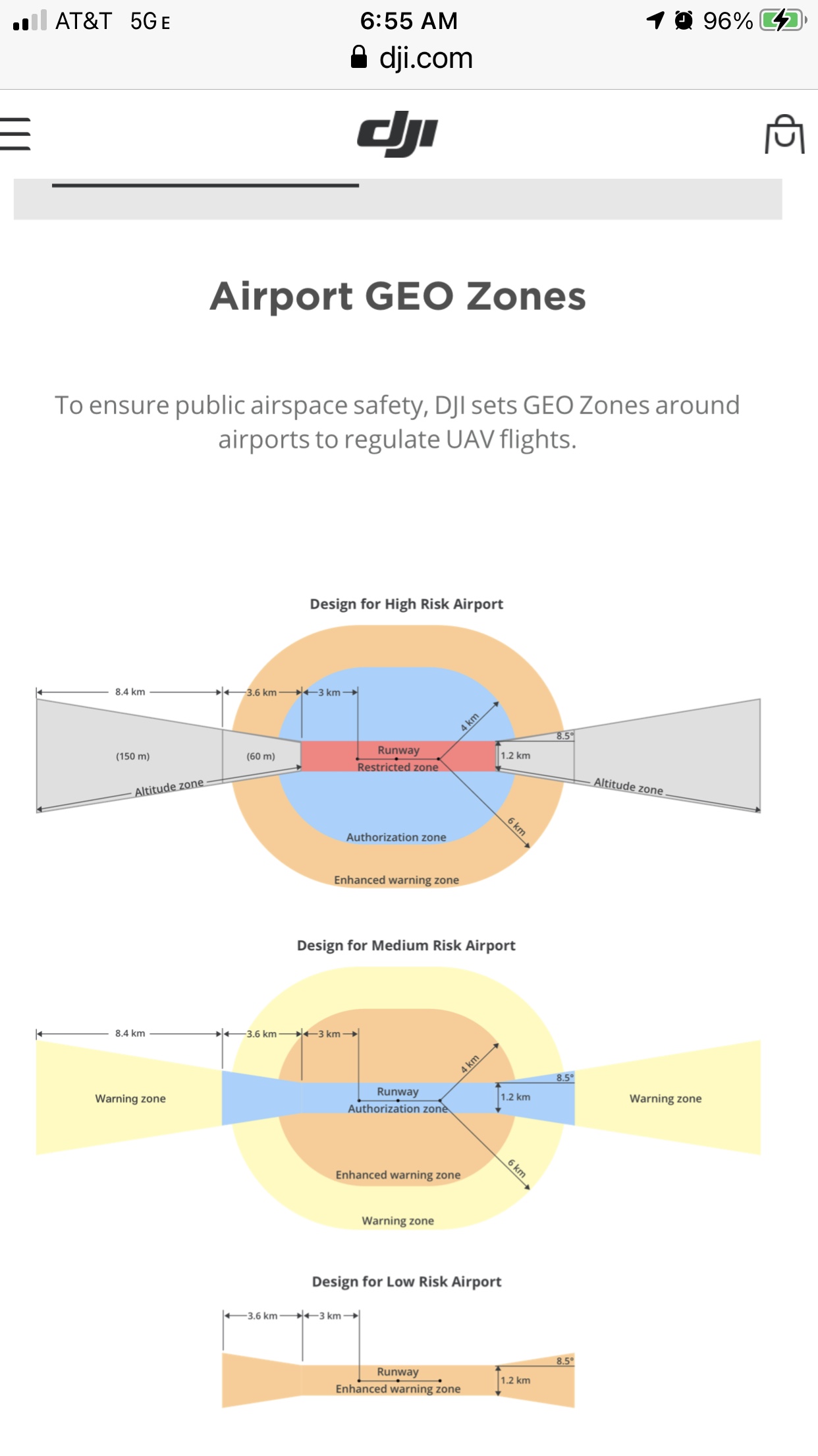

Thanks to dawgpilot and EaglePrecision I went to DJI Fly safe GEO zone map and saw I was at the end of a flight pathway. I was about 8 to 10
miles from the airport this was just warning me to be careful. I guess I was never in one of these zones before or this is something new that I did not know? Oh well I know now. Thanks everyone

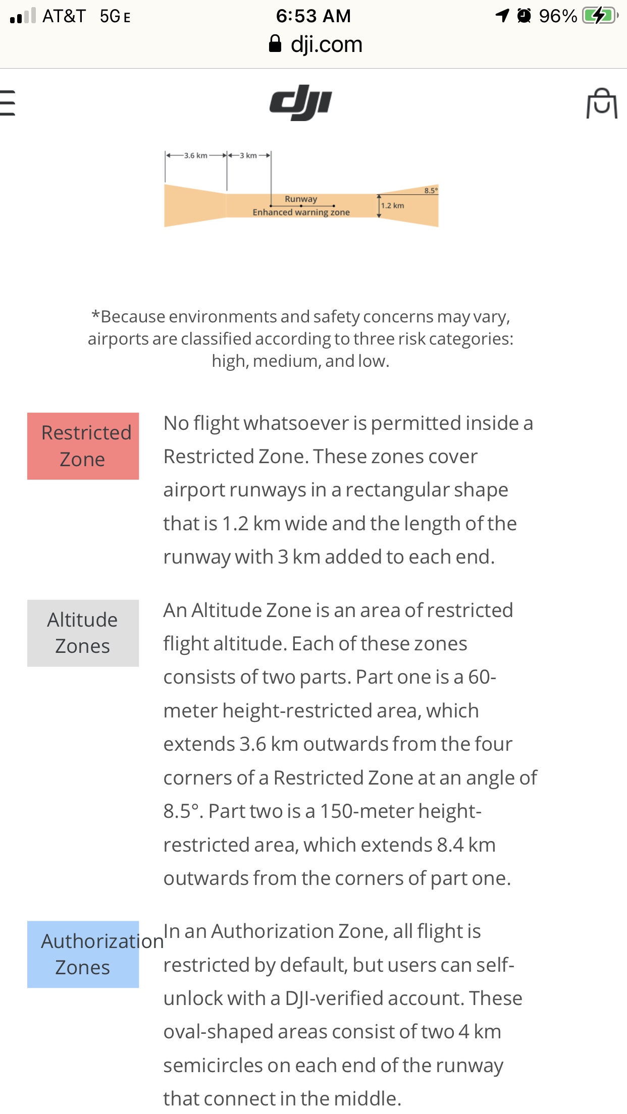

Altitude Zones have two height restrictive areas. Part two is 150 meters or 492 ft height restriction.
