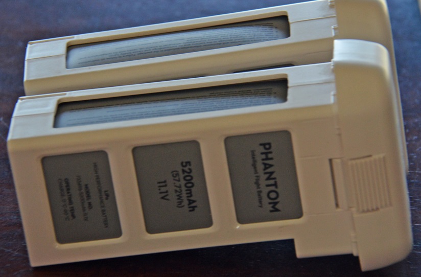

Yes. The intelligent batteries will swell if you leave them fully charged for an extended period of time. That's a challenge with the DJI batteries since they discharge automatically, but if you buy an aftermarket, whether on purpose or because what you bought was a counterfeit, it's possible the battery won't auto-discharge. And if left fully charged for, say, three weeks, it may begin to bulge out of the sides. There are youtube videos illustrating this.
Would swelling even be noticeable since packs are caged in plastic surround?
Here's an example:

I had two aftermarket Lipos for my P2V. Both were fine batteries with no issues. In fact, they were even better than the stock DJIs as they could fly for longer distances without problems (one was 5400 mAh and the other was 6000 mAh vs 5200 mAh stock). But both of them swelled after about three weeks of sitting fully charged during cold and windy weather last winter. I was able to use them - carefully - for several months afterwards. But both batteries are now retired.
