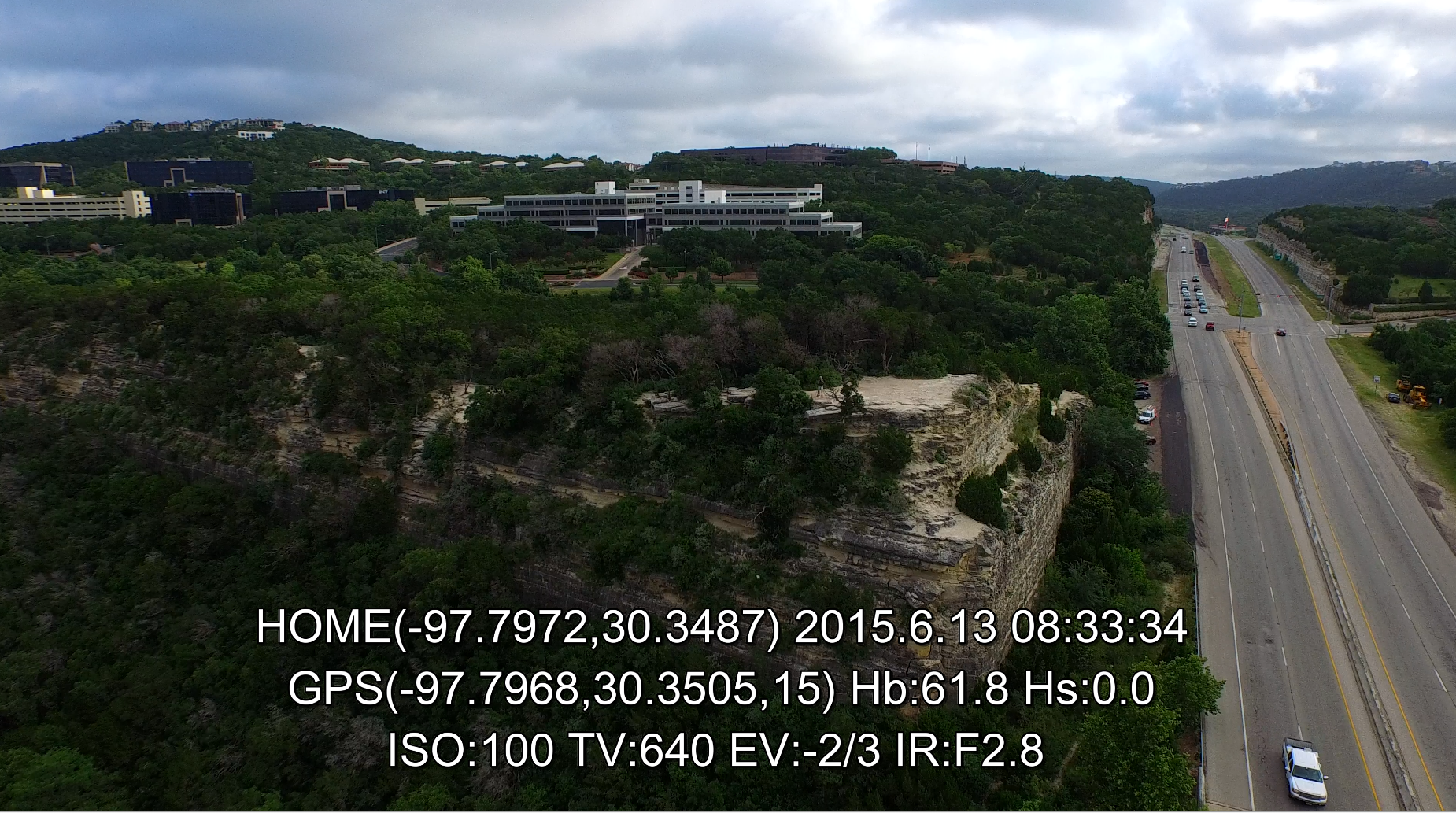

    I downloaded and ran the VLC player and was able to see the subtitles, although the video didn't really play as you'd expect. Maybe some settings I need to adjust but here's a pic of what displays.

    I saw the same thing. Would be cool if there was an add on that displayed a map. If someone knows please chime in!
