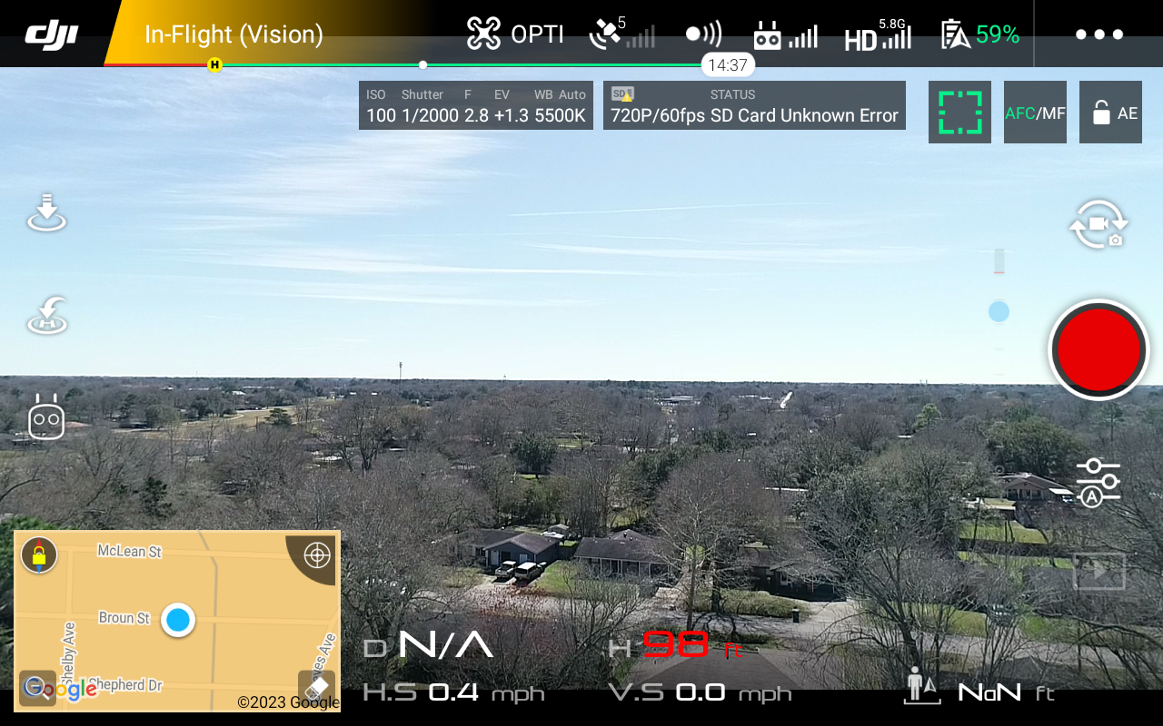

Hello everyone I have a minor or major problem and could use all advice.i have a p4p not a scratch or bump,never been crashed but for some reason it will only detect 3-4 satellites.ive tried compass/imu calibration,different USB plugs,different phones/tablets,I've tried launching from several different locations around the city.skies are very clear not a cloud in site.when the bird is launched it's in vision mode and will only climb about 24 ft before max altitude is reached unless I put it in attic mode then I can climb approximately 100ft.any help will be gladly appreciated

Anyway it matters less whether the sky is blue, and more whether a portion of it is blocked. ie. by buildings, which usually are common in the city.

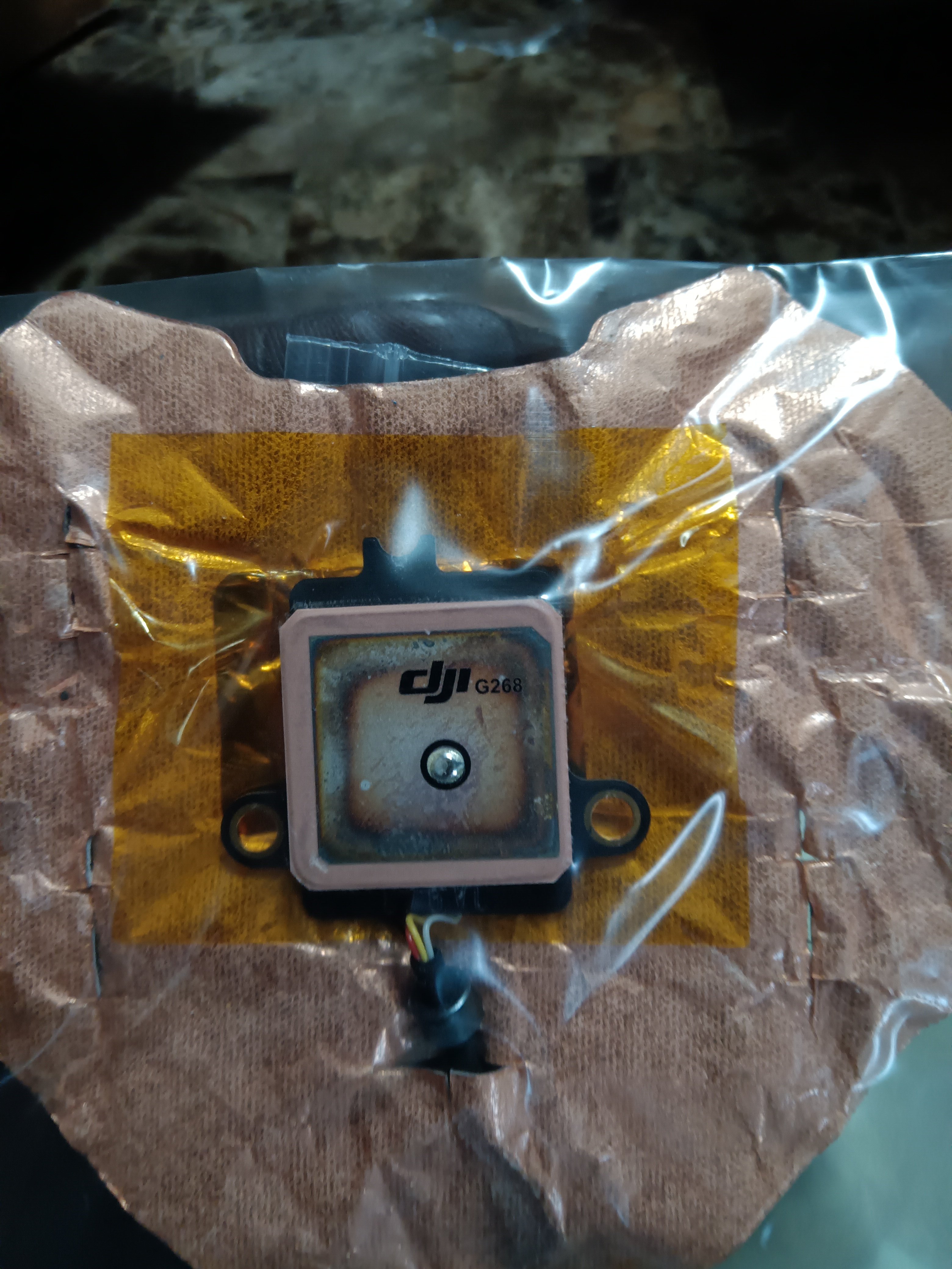

What you should do in carefully investigate the GPS board. Especially whether the ceramic antenna isn't broken, the copper patch is whole, and soldering holds.
Most people have trouble visualizing propagation of microwave EM fields; but I can tell you even a small etching in the copper of the patch antenna causes large changes in the ability to receive signals.
Yes I'm aware of the gps board location,I've torn down and repaired several p4's,but I wanted to make sure I wasn't over looking something before I dismantle the bird.i seen in another thread someone said something about redownloading firmware.do you think that could be an issue? Just kinda weird it's grabbing 3-4 satellites sometimes 5.would a defective gps board do that? I would assume a defective gps board or components wouldn't allow it to connect to any satellites

This occurred on a totally different system, but still with a Ublox GPS receiver chip. It was with the GPS in the handheld controller for a Yuneec H+ drone. The cure was replacing the patch antenna to the GPS receiver. I never could determine what internal issue caused the antenna to go bad, but replacing it cured the low satellite count that was occurring.
I am not familiar with the GPS board on the P4, but most drone aircraft have the Patch Antenna as part of the GPS board assembly. You may need to get a new GPS board to cure the issue.
Thanks for all the advice,greatly appreciated.i just ordered the replacement,will do the swap when it comes in.will let you guys know the outcome

You fellas are genius! Changed the gps module couple hours ago and instantly got 14 satellites then upwards of 20.good gps connection,home point recorded and can fly high and far.you guys are awesome thanks for the advice

My guess is an issue inside the patch antenna (flat square ceramic or fiberglass block) on the side facing the sky. I am still wary of quality control from many manufacturers. It just doesn’t seem to exist. In cases like this it all comes down to the solder, flux, and workmanship. An inconsistency in any one of them can cause failure after months of operation in the field.
