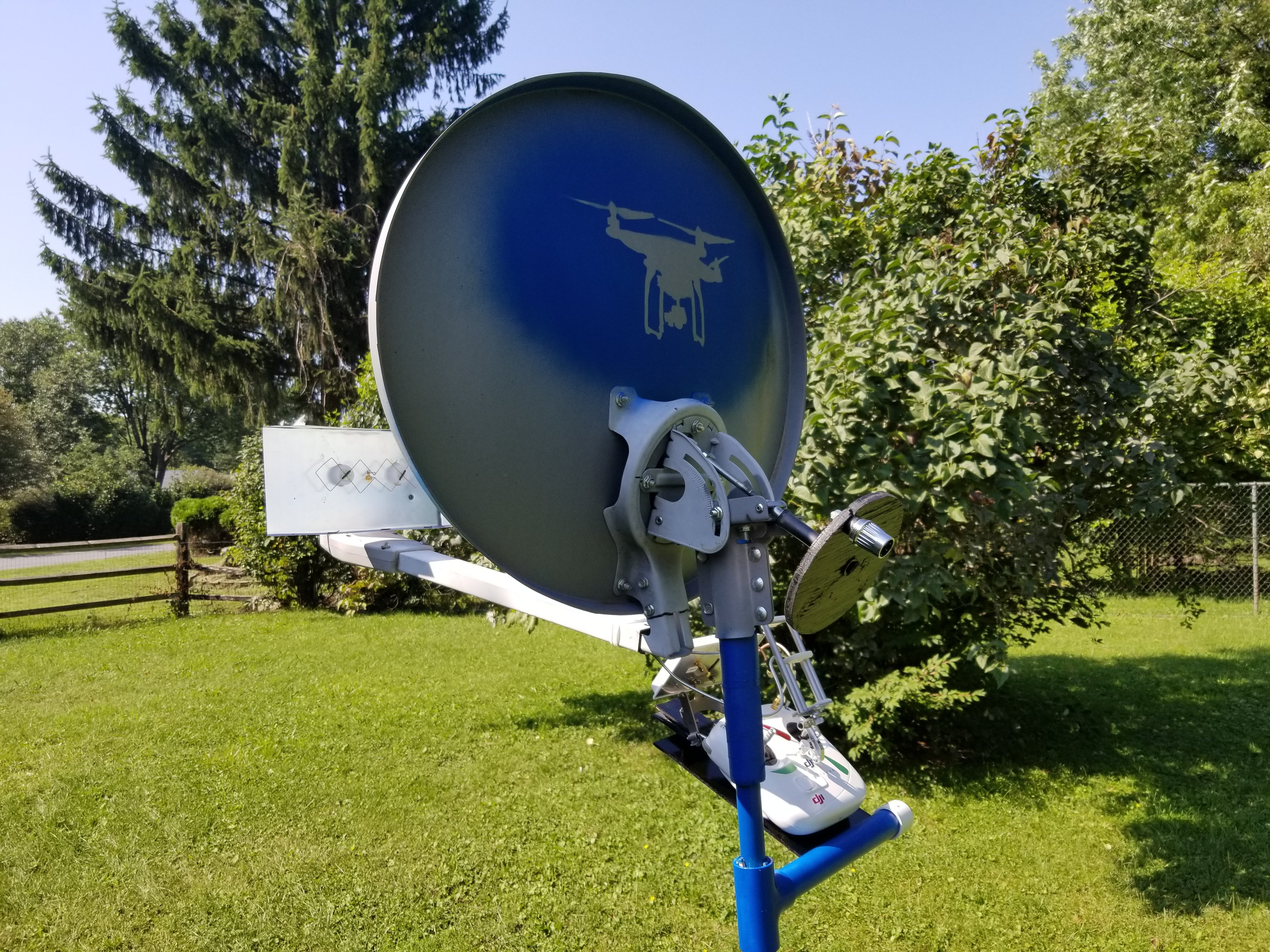

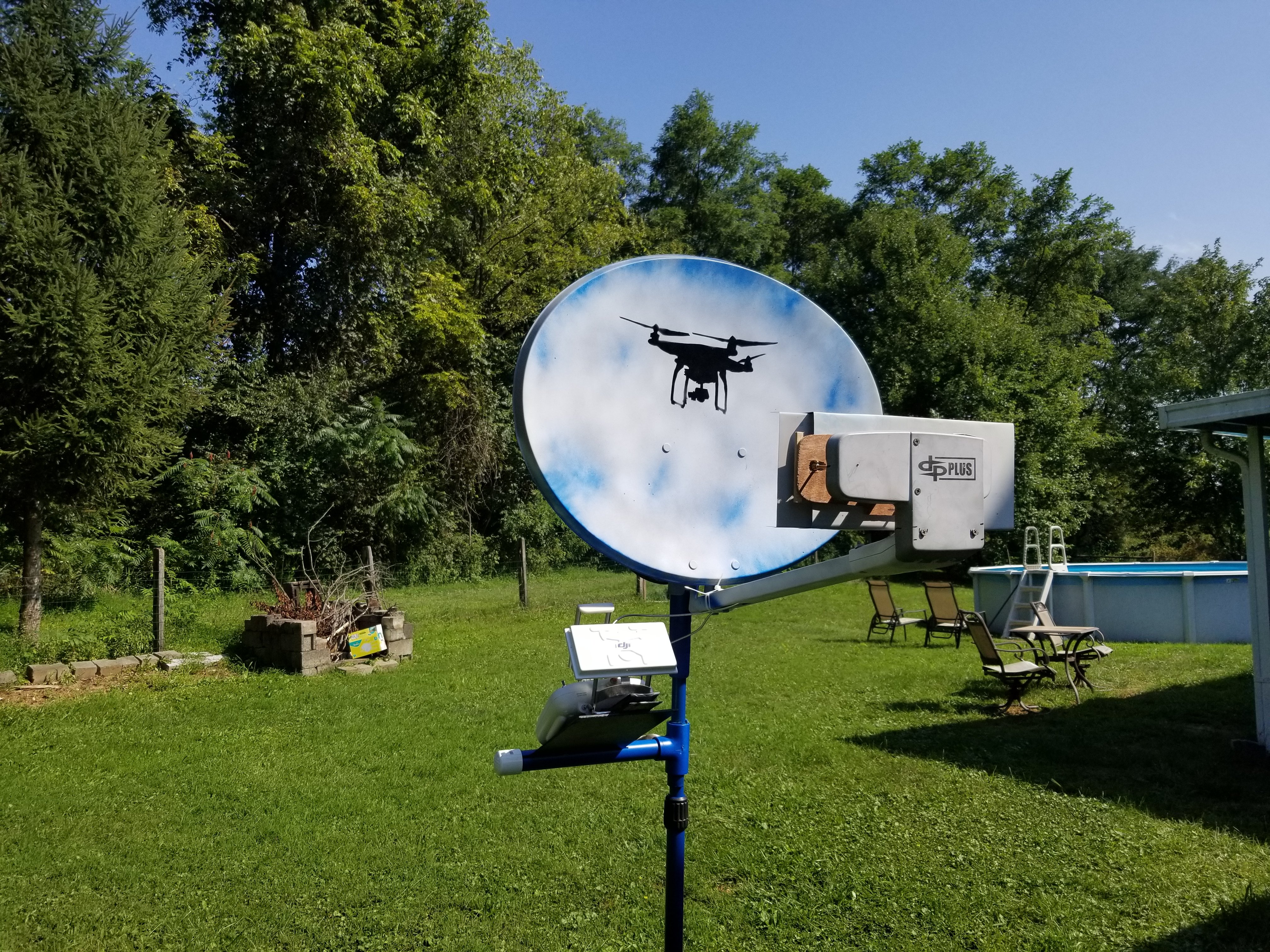

You are flying within sight aren't you?
I think the answer is pretty obvious without asking the question. That is of coarse assuming this setup actually functions. And it may do just that. Impressive, none the less.
I could do with one of those! The 500m limit the CAA grants me really does test my drones capabilities.
Actually.....look at all the trees around the yard and the BIG Pine tree.....we all know that they cause loss of signals Right....i think its phony and just for some Fun ! Hey Major Tom....hows your food supply holding UP !
You probably get better signal without the reflector- being a paraboloid segment with the panel mounted in the vertex position where the feed horn would usually sit if the reflector did work as intended it would be firing way above the AC...
Looks cool though...
I was hoping to out fly my battery with this but I didn't get the gain I was looking for. It
Works really well, I just need to make the perfect antenna for it and add the right boosters.
"And the papers want to know who's shirts you wear".
Andrew McNiel is the man when it comes to FPV antennas. There are so many I want to try.
Unless he moved the feedhorn to defocus that thing I would be surprised. IE: If you have ever tried to setup one of those things and seen how beamy and directional they are natively. Get over that though and it would be cool.
