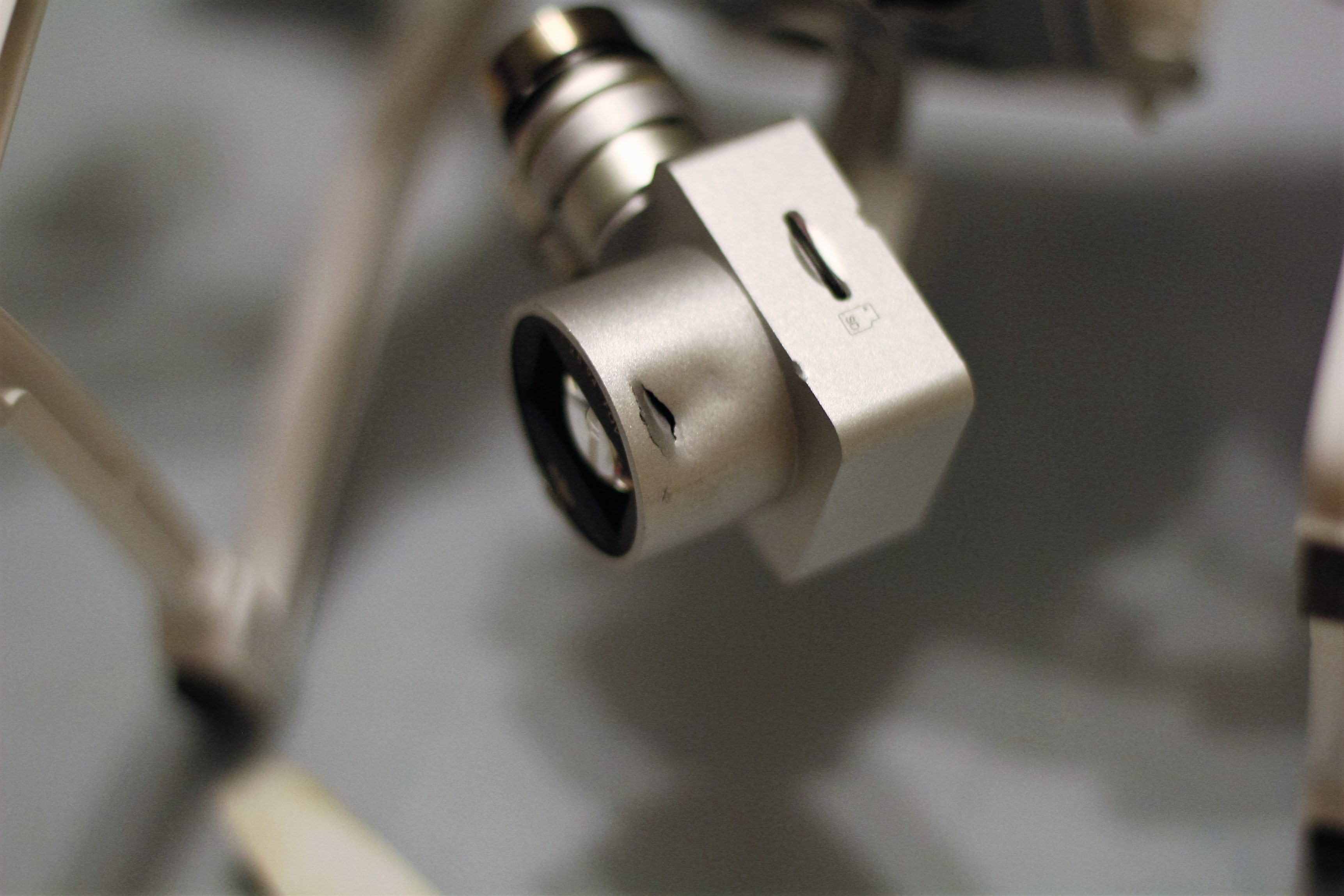

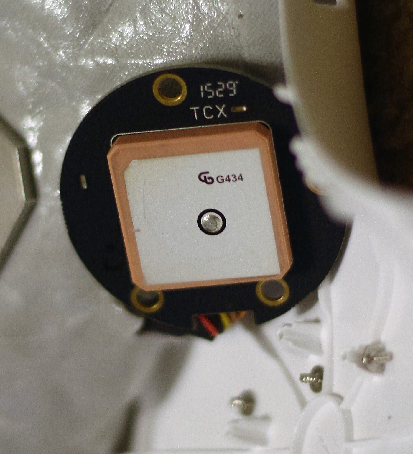

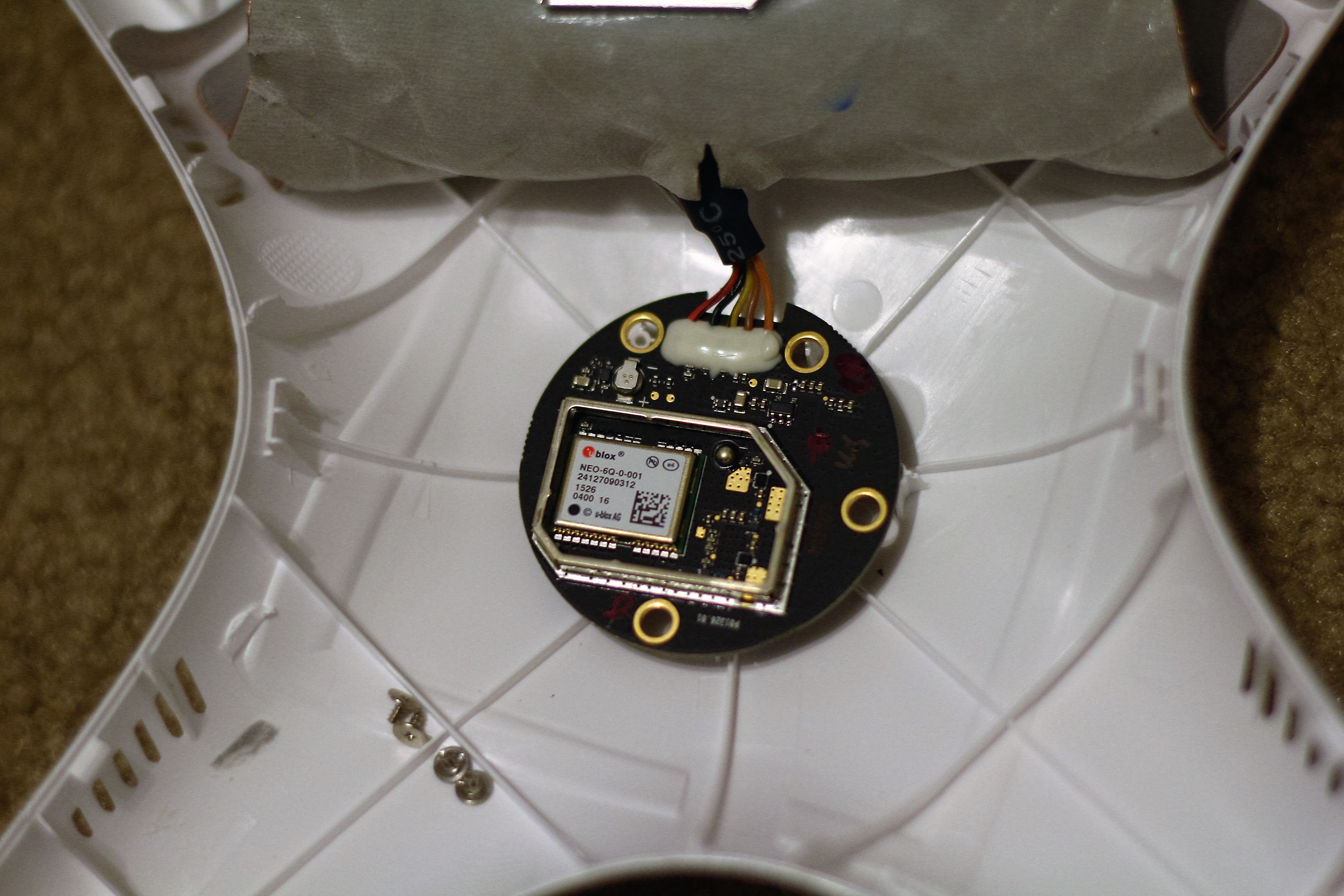

I've attached pictures below of the crash damage. The GPS unit seems to be fine, no cracks or chips.

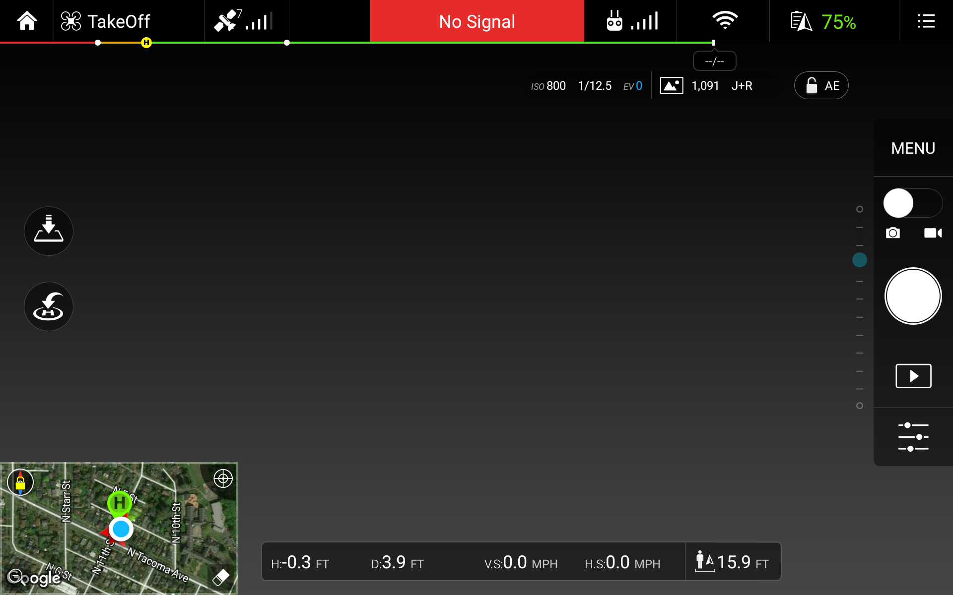

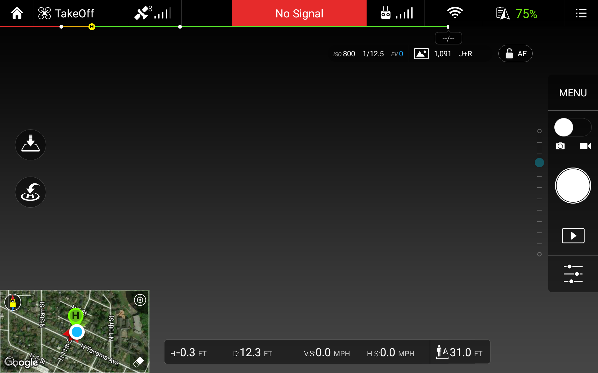

DJI App shows connection to 6+ satellites, but then shows movement drift even with drone on the ground. See app screenshots below for detail.
Lens dent - does not interfere with pictures or video
GPS "back"
GPS "Front" , apparently undamaged
DJI App screenshot (drone stationary on ground)
DJI App Screenshot after a few minutes - further distance drift ( with drone stationary on ground)
Lens dent - does not interfere with pictures or video View attachment 60763
GPS "back" View attachment 60764
