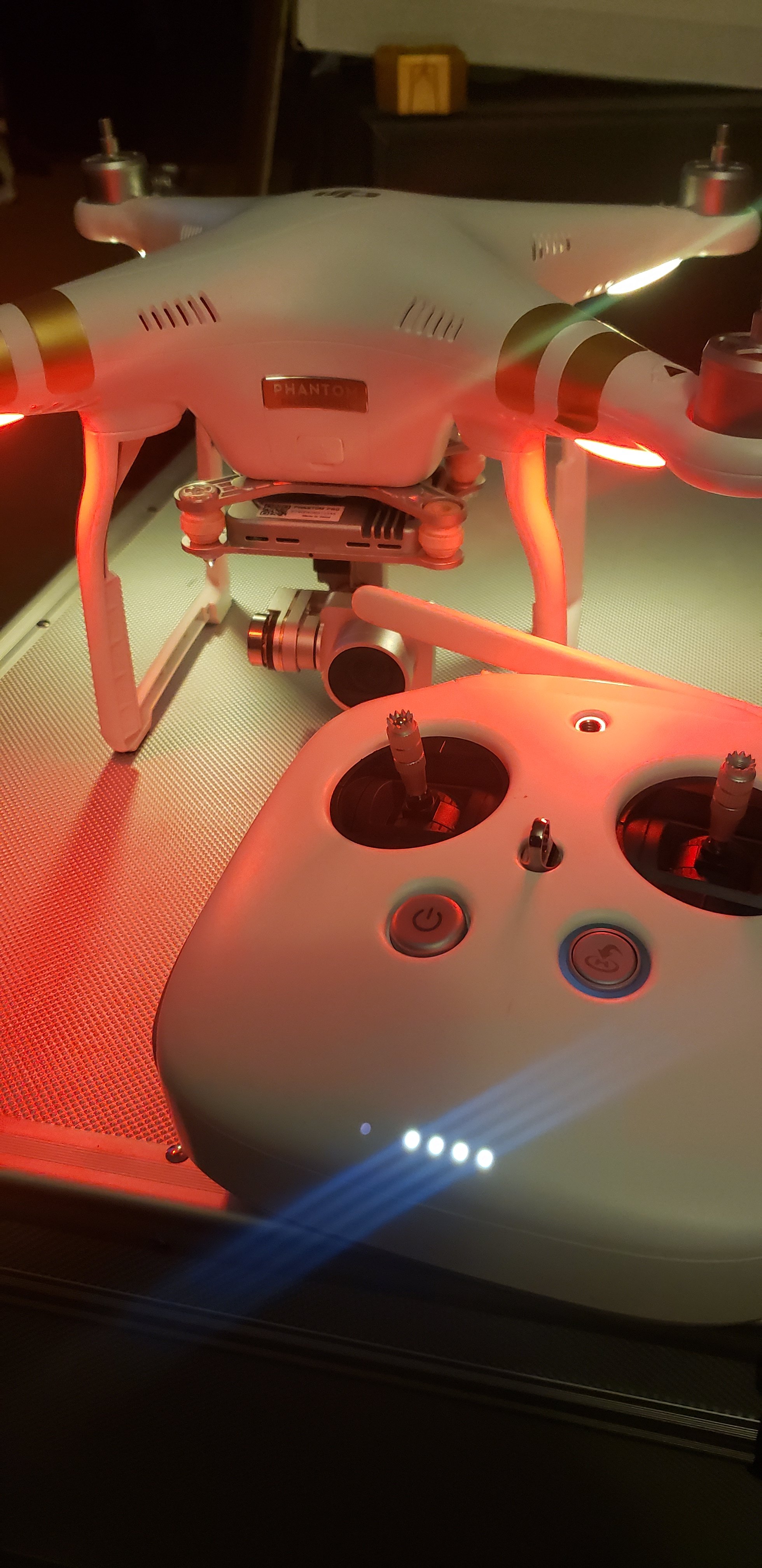

I just got this 3pro over the weekend. It worked when I got it and when I got home. Now (after trying to update it) it sounds like an old modem and won't do anything. Im wondering if it trash or how to fix it. I have tried to reset it, charged it overnight. When I hook it to my Mac, it says its up to date. I have no clue whats wrong. Any help would be greatly appreciated!!!!

What exactly are the drone and remote doing, beeping, squealing? What color and which lights are on? Does it charge?
300C is the remote. Is that what you updated? Making sounds?
Many remote problems can be solved by doing a calibration. Shown under (RC) Settings

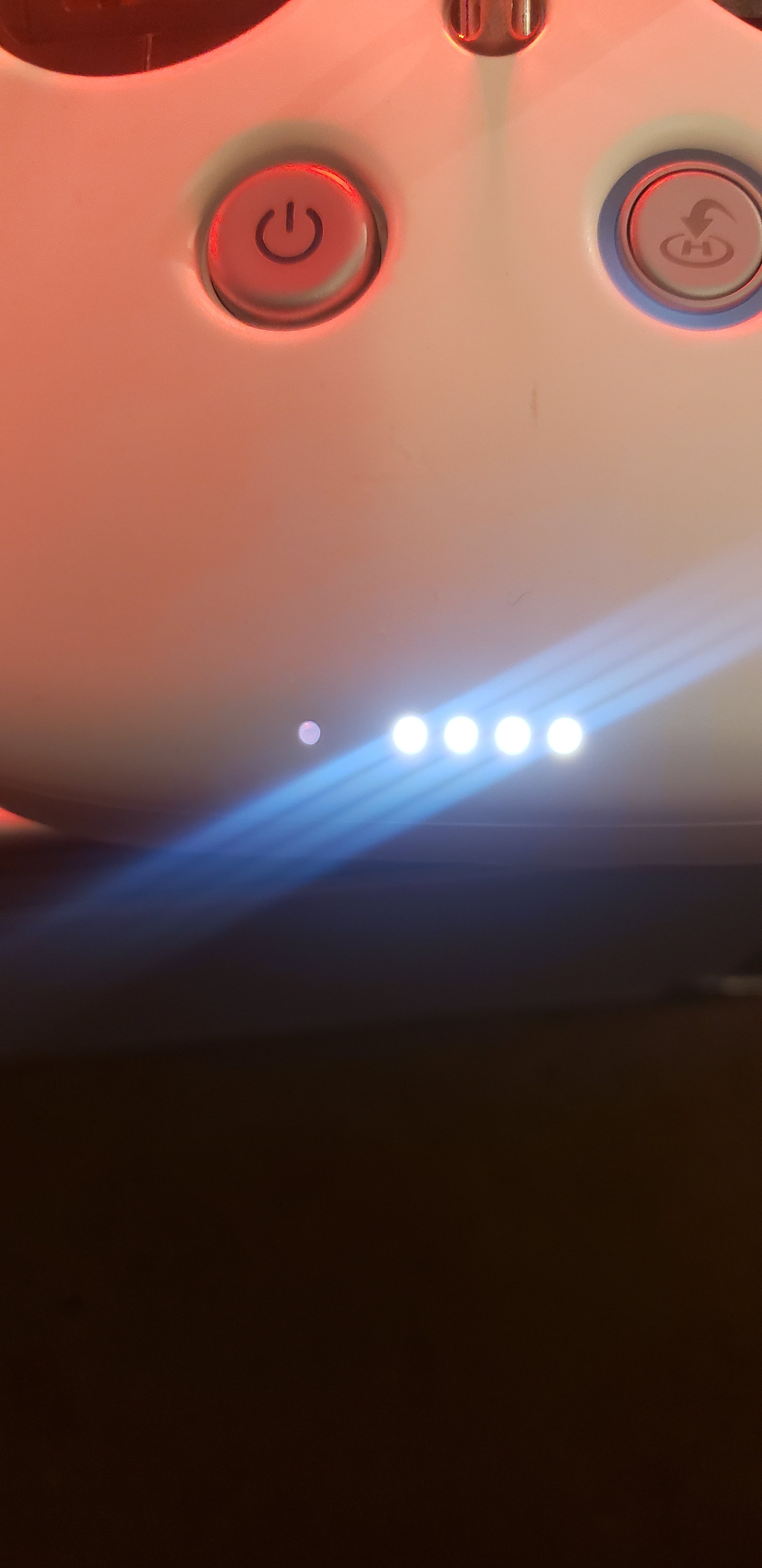

Flashing red light on the gimbal, and it looks like nothing on the RC.

When you attempt to link them together, are you pressing the link button on the side of the OFDM module? When you do press it, does the remote make a beep-beep noise? The power light on the remote should be green when the rc is paired with the ac. When the rc is wanting to link with the ac, the power light should be blue.
I’m sure you probably already know that.
