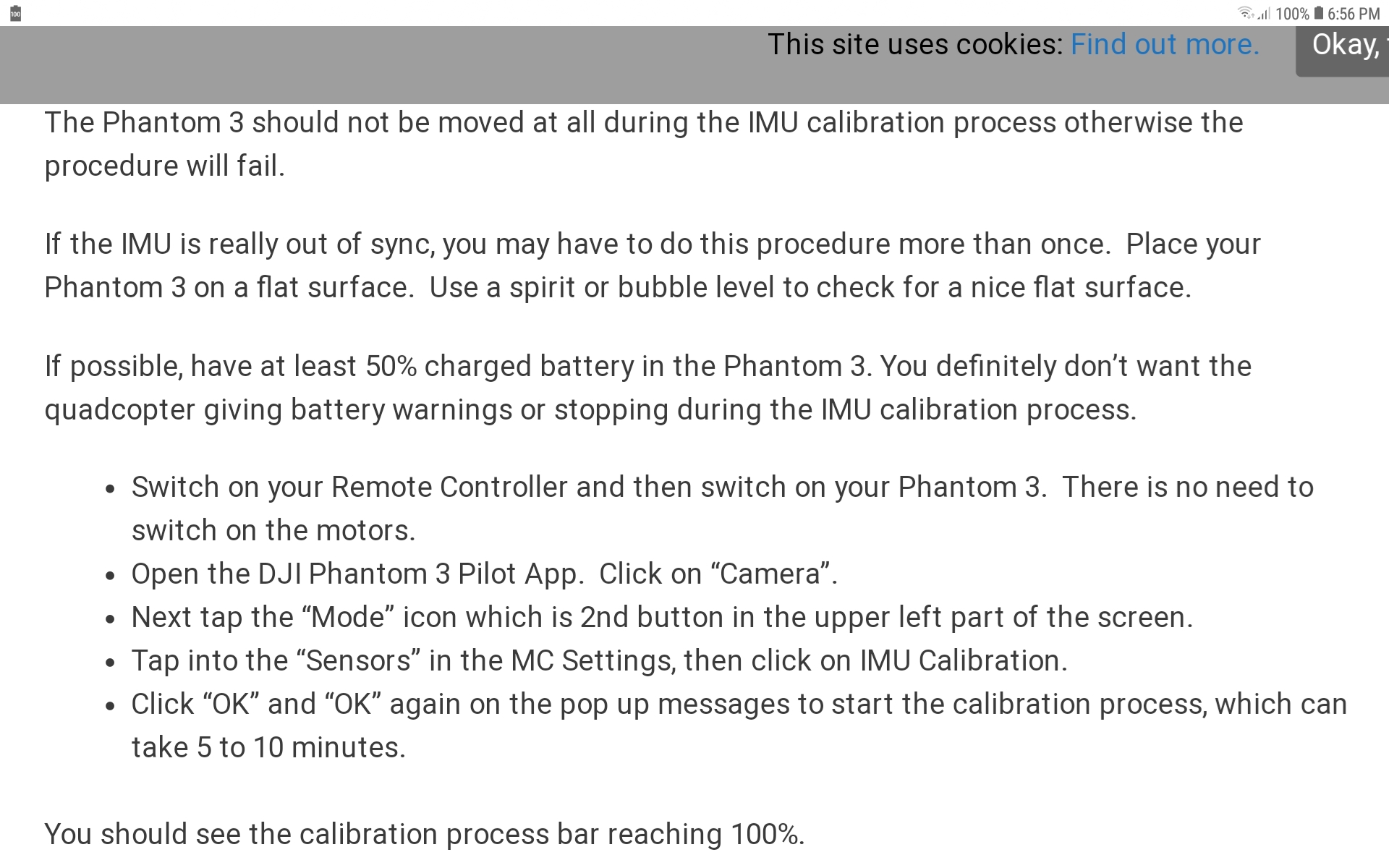

Ah, sorry I forgot to mention that I have tried to do the gimble auto calibration but it doesn't move or calibrate. I looked at the warnings but nothing has come up, IMU calibration doesn't show up and compass calibration doesn't get the gimbal to work. I know it's going to be useless but I'm gonna try some YouTube videos now and hope that someone found a quick solution to this problem.

You say gimble calibration not work,,does cam have a colour light showing on gimble mount,,red , green or nothing,,sin e not used for while do a stick calibration under rc settings to corect or reset stick and gimble wheel operation,,,,,no imu sounds bit odd,are you saying its greyed out or wont click on or wont perform imu check........the more info you can give to us here the better we will have idea of what's going on,even a small clip of what it does when powers up,,,when it's on can you feel any resistance when try move cam or it limp
