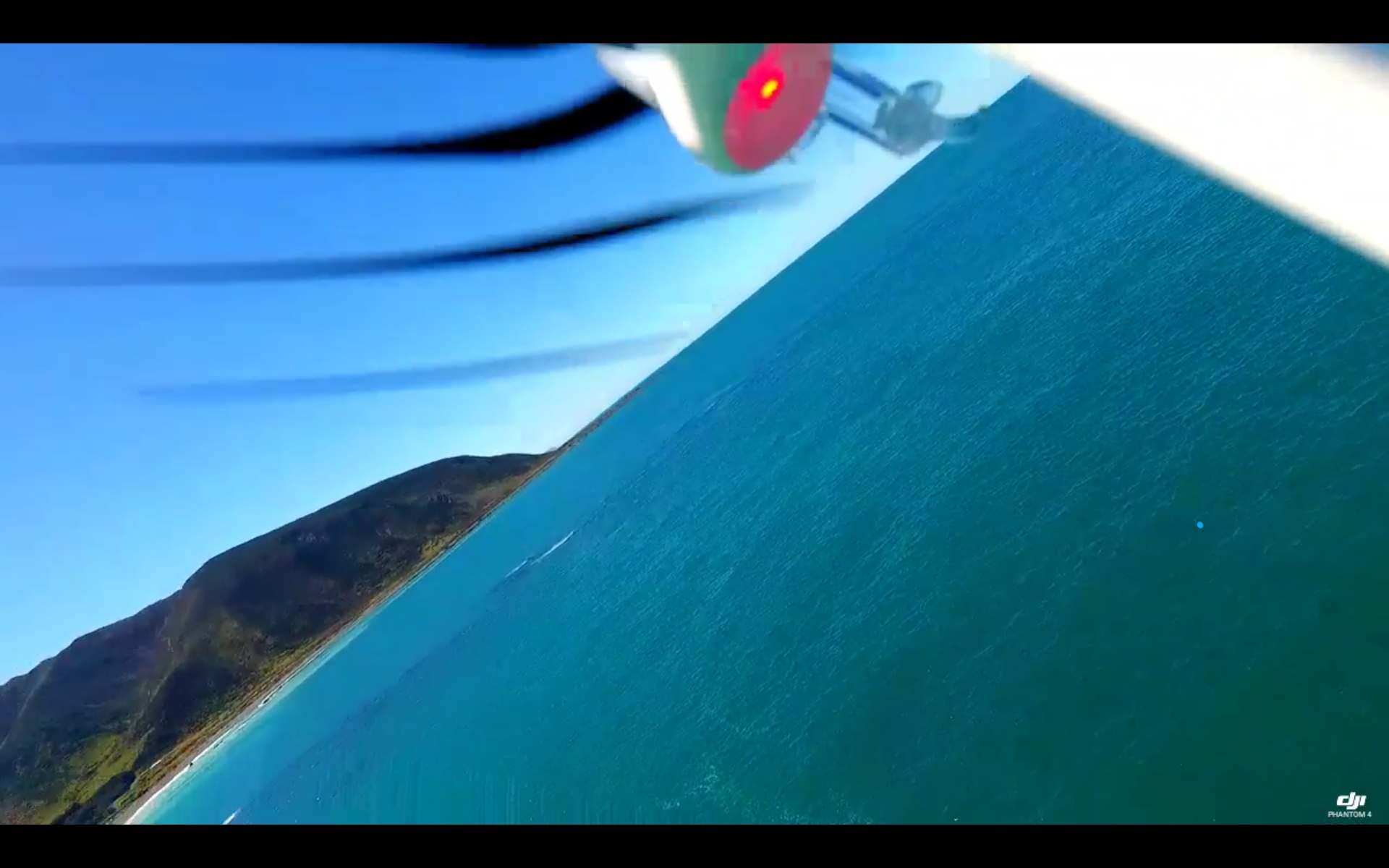

Hi everyone. I came home after work today and decided to take the drone out for a short while. I was in sport mode and in a fairly wide turn at about 55kmh when i thought the drone had lost control. The camera view made me think i was coming down. A warning came up that read gimbal roll reached movement limit. I landed and everything seems ok. I will start it back up and see if i get any notifications after my heart slows down. Any ideas? Thanks

Yup p4 bit common to have a gimble tilt on occasion,,I been there,it just seem to fix itself and has not done it since,,,,top pic I thought I was about to start swimming and bottom pic limp cam giving free fall impression onscreen,,,gimble calibration should sort it,,,,yes worrying times when it happen but best not to panic and gain altitude if unsure

A gimbal error will not crash your drone. My Phantom 4 does that all the time because I live in a valley near the coast and it is almost always over 20 mph wind every evening. When I make quick maneuvers the gimbal turns sideways and goes limp for about 2 seconds, then it rights itself, and I continue flying. The first time it happened I freaked out a bit and my reaction to something going wrong is to let go of the sticks and let it hover in GPS mode. I almost always fly in sport mode. The camera always rights itself, and is fine. Gimbal calibration is good, but don't expect it to fix the problem when you make sudden maneuvers or try to fly in strong winds. But do take action when you see your video feed do that, try to learn to differentiate between the gimbal going sideways and the whole drone going sideways! If the drone is going sideways you are crashing and need to do something about it!

It sounds like that in sport mode, the airframe has a greater 'range of tilt', if you will, than the camera gimble. IE sport mode.
Right, when my Phantom 4 is turned on and I'm holding it in my hand (without propellers of course) if I turn it too far forward or side to side, the gimbal will twitch and then flip sideways for a second. That is exactly what is happening in the sky during sudden movements such as in sport mode.

I totally concur. It has to do with the roll of the Drone exceeding the roll ability of the gimbal. So if this happens again take notice of the direction of the wind and the direction of your maneuvering. It was definitely a freak out moment the first it happened, but now it's just a little bit annoying if it messes up a shot or something. I also agree that calibrating the gimbal will likely have no effect
Twice while flying an autonomous Litchi orbiting POI mission with a P4P I've had the gimbal fail. No strong winds, no abrupt maneuvers - just a random fail for about 15 seconds and then a recovery as you can see on the following video. No other problems - it just ruins the shot. Only using Litchi at two different locations a couple of months apart. Any ideas or suggestions are appreciated.
That’s an intermittent issue. Unlikely (but not impossible) due to flat cable or controller failure - when they go, they GO. I suspect the potentiometer in the gimbal ESC board needs cleaning. It’s akin to a scratchy volume control on a radio. Remove the cover and give the pot (it has a shaft in it from the the roll motor) a blast of Caig DeoxIT D5 (any of the D5 series), GC Electronics De-Ox-Id, or CRC QD Electronic Cleaner. Rock the roll motor back and forth, blast it again then let it dry for 30 minutes. Any residual is lubricant and harmless. Replace the cover and see what happens.
