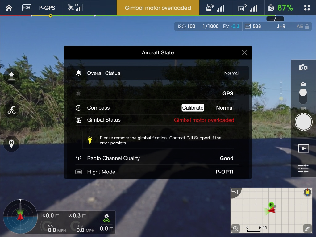

Same here, Just got my P3 yesterday and did the upgrade last night. and got this before my maiden flight this morning.
Same here, Just got my P3 yesterday and did the upgrade last night. and got this before my maiden flight this morning. View attachment 25767
In your case since its new and that was your first flight, did you remove the small piece of packing foam at the top of the gimbal?

Ever since I updated the iOS DJI Pilot App to 1.2.0 yesterday, I have been receiving the Gimbal Motor Overloaded error intermittently while flying. 2 flights now.
1. There is no packing foam still attached, I have been flying this for over a month now, about 40 flights under my belt so far.
2. The gimbal protector is not on.
3. I do not have any filters or added weight on the camera.
4. I checked the set screw that attaches the camera to the shaft and it is tight and square to the flat surface of the shaft as it should be.
5. I have done a cold IMU calibration 3 times and calibrated the gimbal 3 times on a perfectly plumb surface since upgrading to 1.2.0.
The gimbal seems to act as it always has which is pretty decent, other than the off tilt horizon which comes and goes depending on how you yaw the craft.
Any ideas on how to resolve this issue?

I won't even try to straighten everything here.. the thread is too far gone. Anyway:
1. Gimbal and CMOS sensor are separate things. Have nothing to do with each other, other that sensor is placed on gimbal. Electrically, their work is independent.
2. The mobile app receives gimbal status in a packet from the drone. If you make it no longer react on the information in that packet, it will still be sent by gimbal - the issue will still be there.
3. "motor overloaded" means "current draw is beyond specification". If a motor takes too much current, it might overheat the whole thing. That is the main concern if you see the "motor overloaded" message.
4. If motors are not hot after such message, and gimbal behaves normally - there is no reason to concern. It is possible that current sensor in ESC just gets inaccurate information.
5. The source of the issue is either in gimbal arm motors, or motor drivers. Two motor drivers have their own boards within gimbal arms, the third is integrated into Gimbal Top Board.
6. For a software fix. I'm not sure if the threshold for that error was modified between firmwares - if someone feels really bothered by the message, may be woth trying flashing different firmware versions to m0400 module (less risky than flashing the whole drone).
