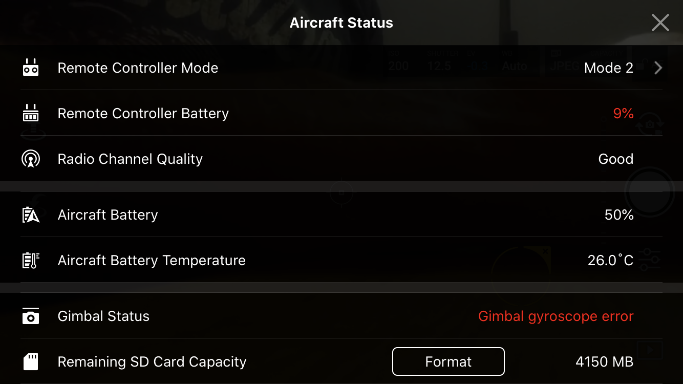

H Henrik Joined Sep 2, 2020 Messages 5 Reaction score 0 Age 50 Sep 12, 2020 #1 Hi gyroscope error i have new cable in my gimbal thantom 3 standard and this problem is Attachments B99BEBBA-84E3-46ED-BD63-0140A1304FCF.png 619 KB · Views: 323
quaddamage Joined Jun 30, 2016 Messages 1,646 Reaction score 844 Location PL Sep 15, 2020 #2 Gimbal gyro is located near the sensor, it's the chip in white rectangle: O-Gs wiki: WM321 Camera sensor board You either have issues with this chip, or still with your flat film cable, or with connectors to which the FFC is inserted.

H Henrik Joined Sep 2, 2020 Messages 5 Reaction score 0 Age 50 Sep 15, 2020 #3 quaddamage said: Gimbal gyro is located near the sensor, it's the chip in white rectangle: O-Gs wiki: WM321 Camera sensor board You either have issues with this chip, or still with your flat film cable, or with connectors to which the FFC is inserted. Click to expand... Thank you
