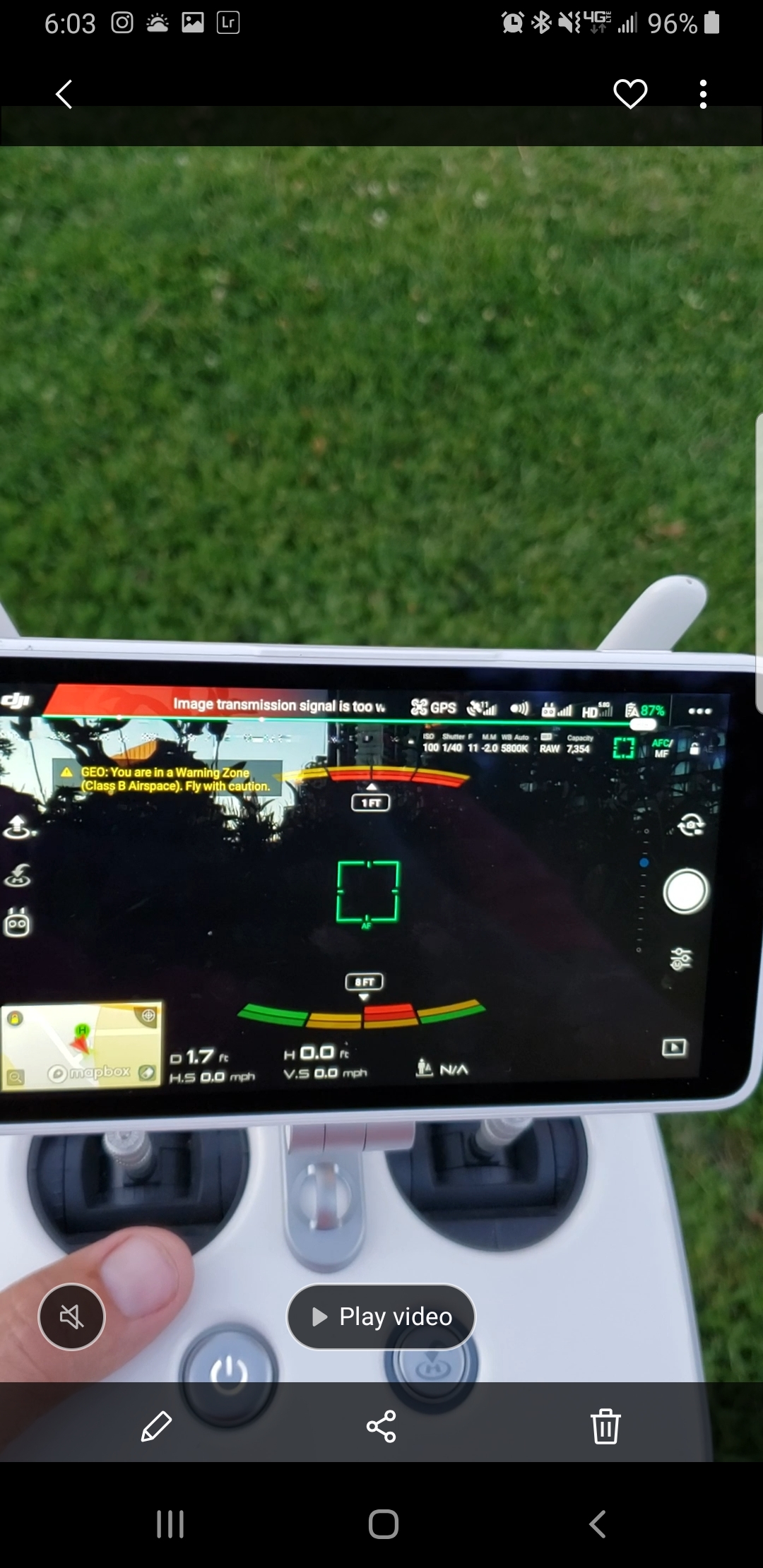

I'm not sure what's going on, I just got a new P4P via refresh and linked it with my P4P+ controller.
It's been working great up until the past few days.
I get the "aircraft disconnect" or "bad signal, move antenna" every 5 seconds, as well as pixelated feed.
I've relinked the remote, still having the issue.
Any ideas about what's going on?

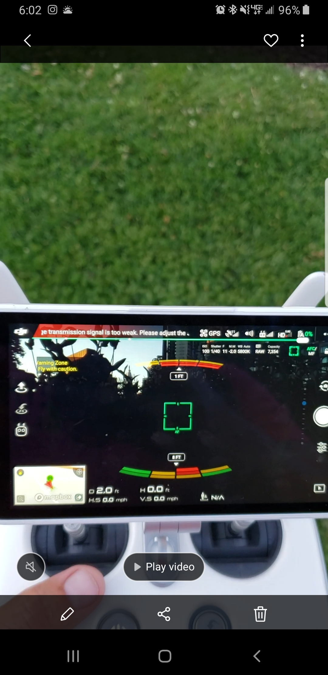

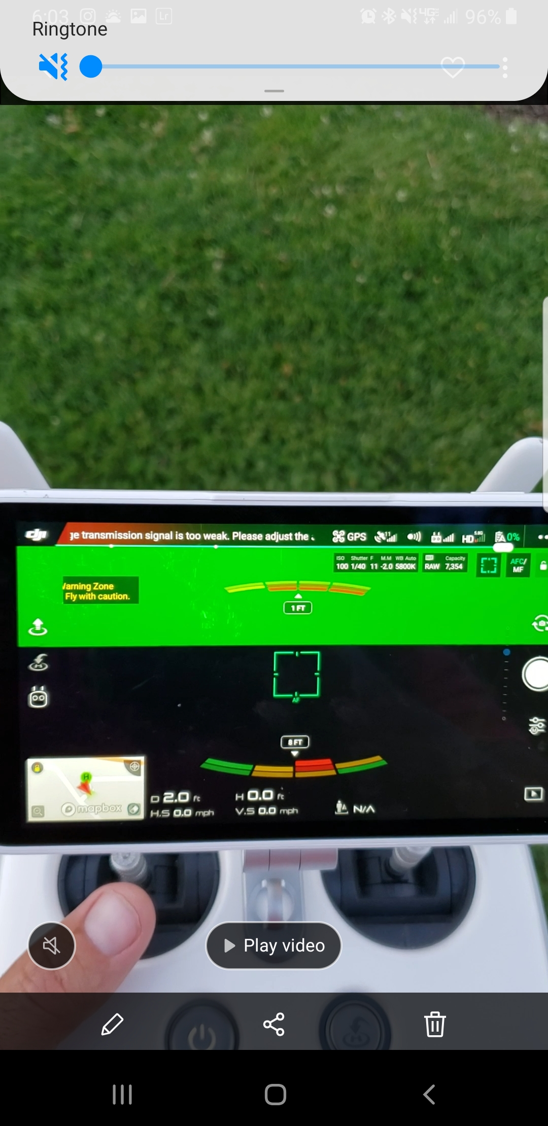

Nevemind.. it's back. Seriously. I'm pissed, this Phantom I have is a piece of junk. Literally, all day.
I change freqs to see if that's the issue, nope.
I change batteries, power on and off.... its junk. Cant fly 10 feet.
See.

Something I noticed in your pictures.
I’ve always thought the antennas should be pointed straight up.
I’m not convinced that is the solution, but you could see if it makes a difference.
