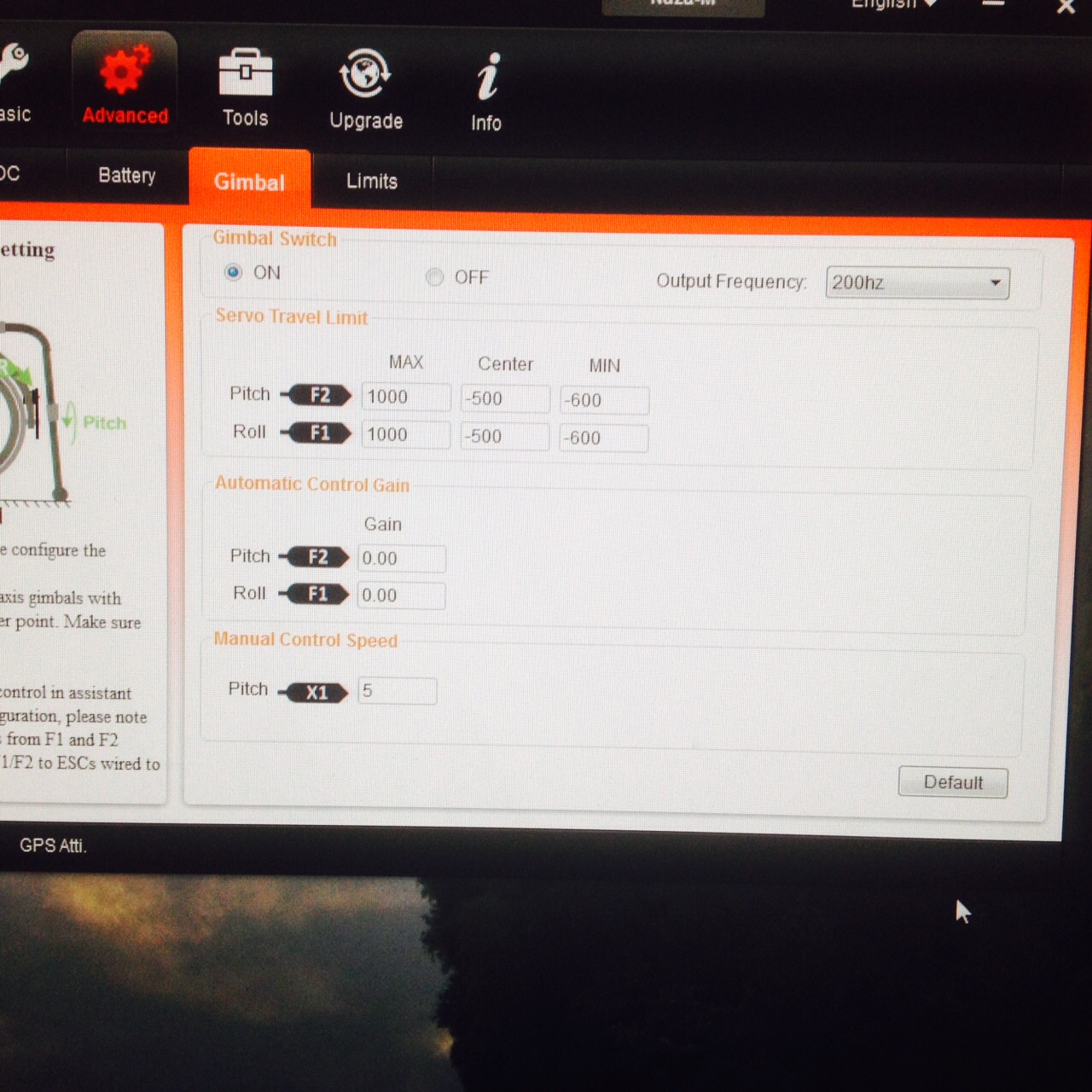

Just got back Mike . I did mine in here in assistant and here's what mine is set to View attachment 27483 ..
What ever works with yours leave it . You can play with the #'s up top while you are hooked up and see where full up is and I have mine so it does point straight down . Now these are with the RPG so they be different with the stock camera . The bottom # is how fast it pans up and down . Default I believe is 10.

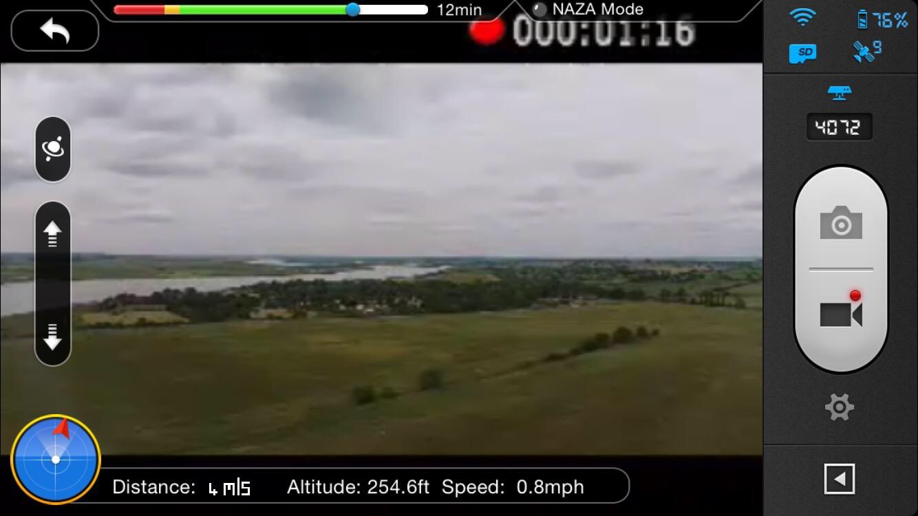

Here ya go Mike a screen shot of my best distance, nobody believes me though:D image.jpg don't know why..........:p

Here ya go Mike a screen shot of my best distance, nobody believes me though:DView attachment 27521

4mls o_O

Yep 4 miles, chuffed with that:p might go for a 6 mile trip today if I've got time, that voice is back!:eek:

Here ya go Mike a screen shot of my best distance, nobody believes me though:DView attachment 27521 don't know why..........:p

That's pretty far mate:confused:
