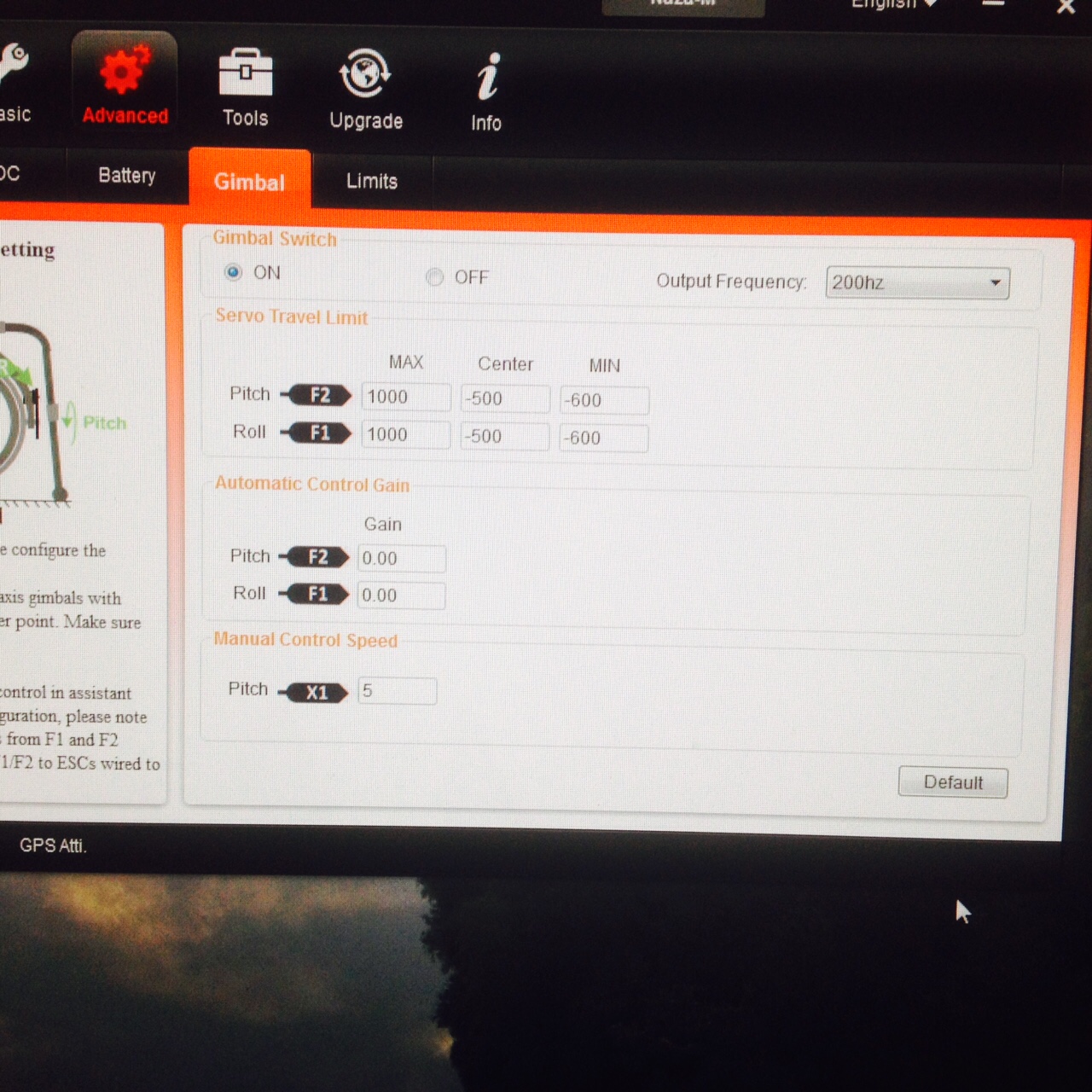

I have the Tx bound ok and the FE700. But with hands off the Tx the camera points straight down. If I roll the wheel down and hold it the camera pans up to level but when I let go of the wheel it goes straight down again. Any idea what's going on?
Hey bro figured it out. All I had to do was scroll it all the way up in the app on my phone and all is good:D

Just got back Mike . I did mine in here in assistant and here's what mine is set to FullSizeRender.jpg ..
What ever works with yours leave it . You can play with the #'s up top while you are hooked up and see where full up is and I have mine so it does point straight down . Now these are with the RPG so they be different with the stock camera . The bottom # is how fast it pans up and down . Default I believe is 10.

Just got back Mike . I did mine in here in assistant and here's what mine is set to View attachment 27483 ..
When you do change those #'s do hit enter .
