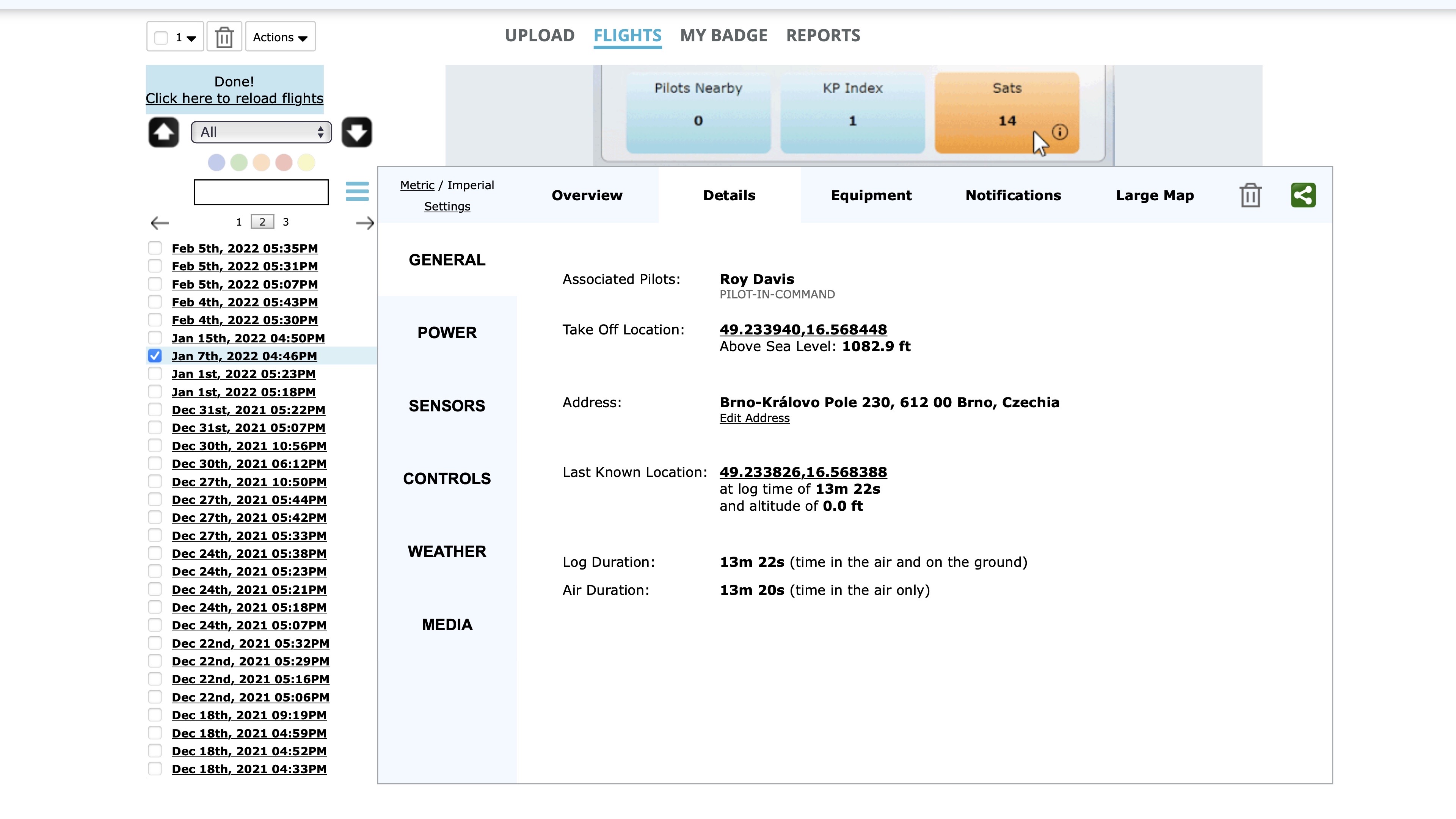

the thing that I found hard to reconcile (among others) is that I'm shown as PIC on the report
Where are you seeing yourself shown as the PIC?
Airdata defaults the PIC to the owner of the Airdata account. I see myself there too when I upload flight logs from other drone pilots.
Look in the "Equipment" tab. You should see devices with serial numbers you don't own if it's someone else's flight log (which seems to be the case).
