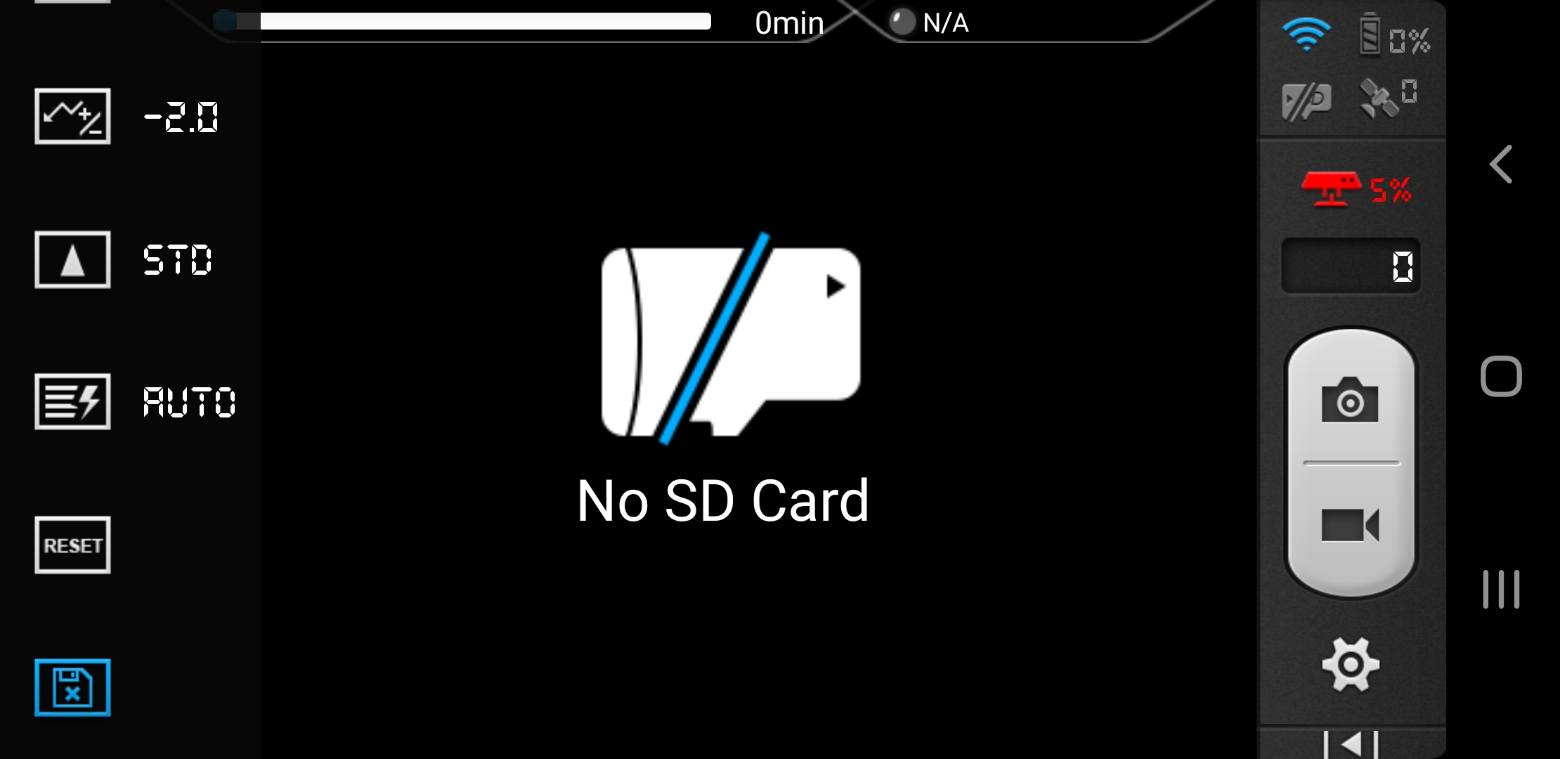

I keep getting a "no SD card" error message. I formatted a couple cards FAT 32, one 8gb and one 4gb.
I still get the error.

Going by the tiny capacities of those cards, they are likely to be slow, old cards and probably too slow for the drone.
Try a newer one that's U1 speed or faster
What is the specification of those cards? I would suggest, as has been hinted at, that they do not have the R/W speed to use in this application. From the manual:
Supported SD Card Types: Micro SD Max. capacity: 64 GB. Class 10 or UHS-1 rating required.
The 4gb card is the card that came with the P2V+
I'll try some large cards.
