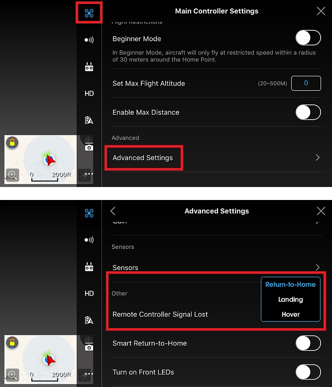

You could make your Phantom hover in place when the remote controller signal drops. To do that, set the "Remote Controller Signal Lost" setting to "Hover" in DJI GO.

As mentioned, regardless of what you do, turn the RTH setting to hover and not RTH.
