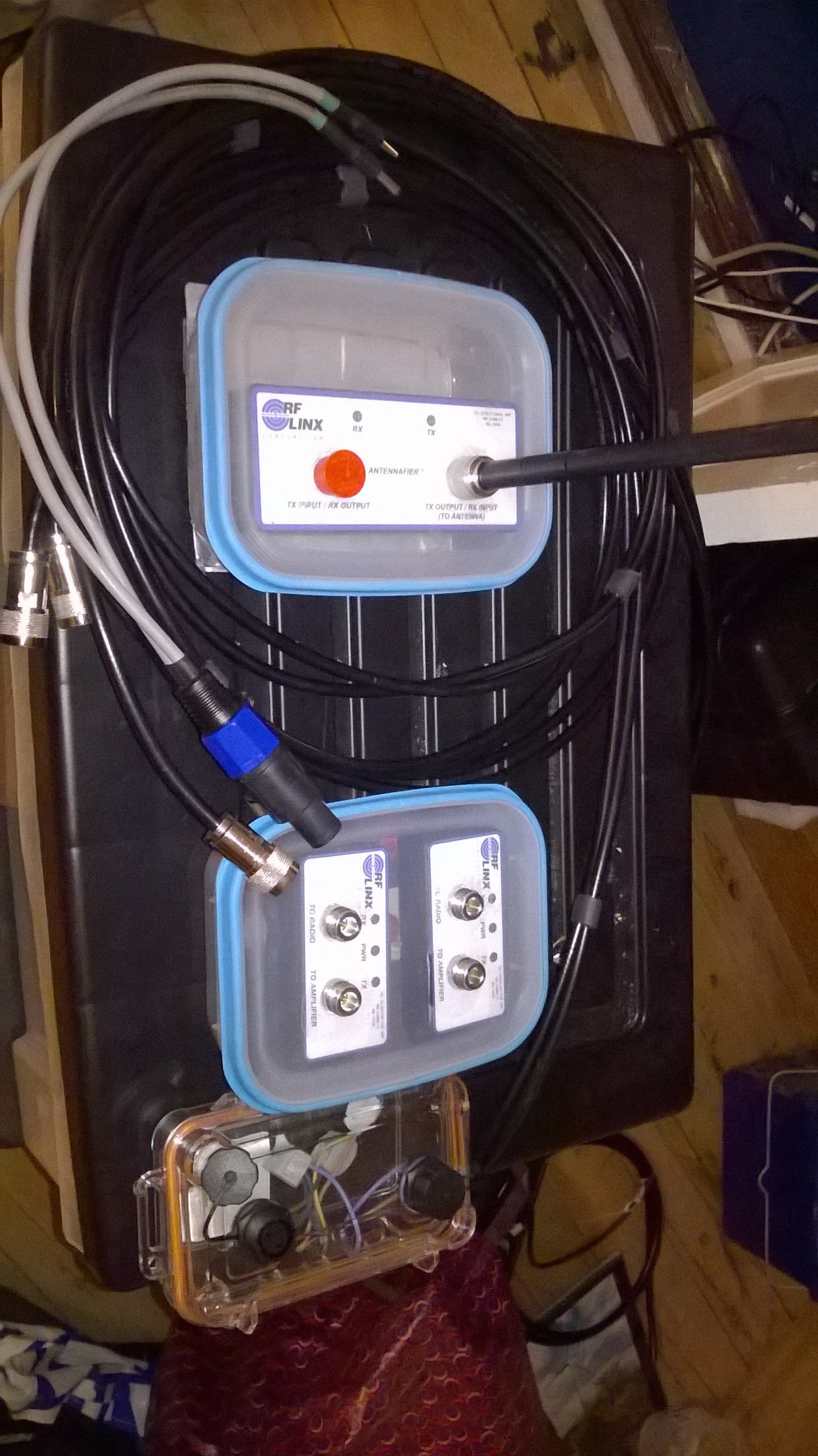

Short update on the antennas. After testing the various systems up and down the most efficient and strongest setup is the LTX2400 amps with antennas screwed on directly. The 20db antennas with the pan/tilt unit only for special missions along power lines. These simple plastic boxes are water tight so I keep them on the roof or on the tripod with rain or snow. Especially useful when getting the matrice 210 flying this summer! :)
Short update on the antennas. After testing the various systems up and down the most efficient and strongest setup is the LTX2400 amps with antennas screwed on directly. The 20db antennas with the pan/tilt unit only for special missions along power lines. These simple plastic boxes are water tight so I keep them on the roof or on the tripod with rain or snow. Especially useful when getting the matrice 210 flying this summer! :) View attachment 77741
200 isn't out yet is it? Now a 210 !
