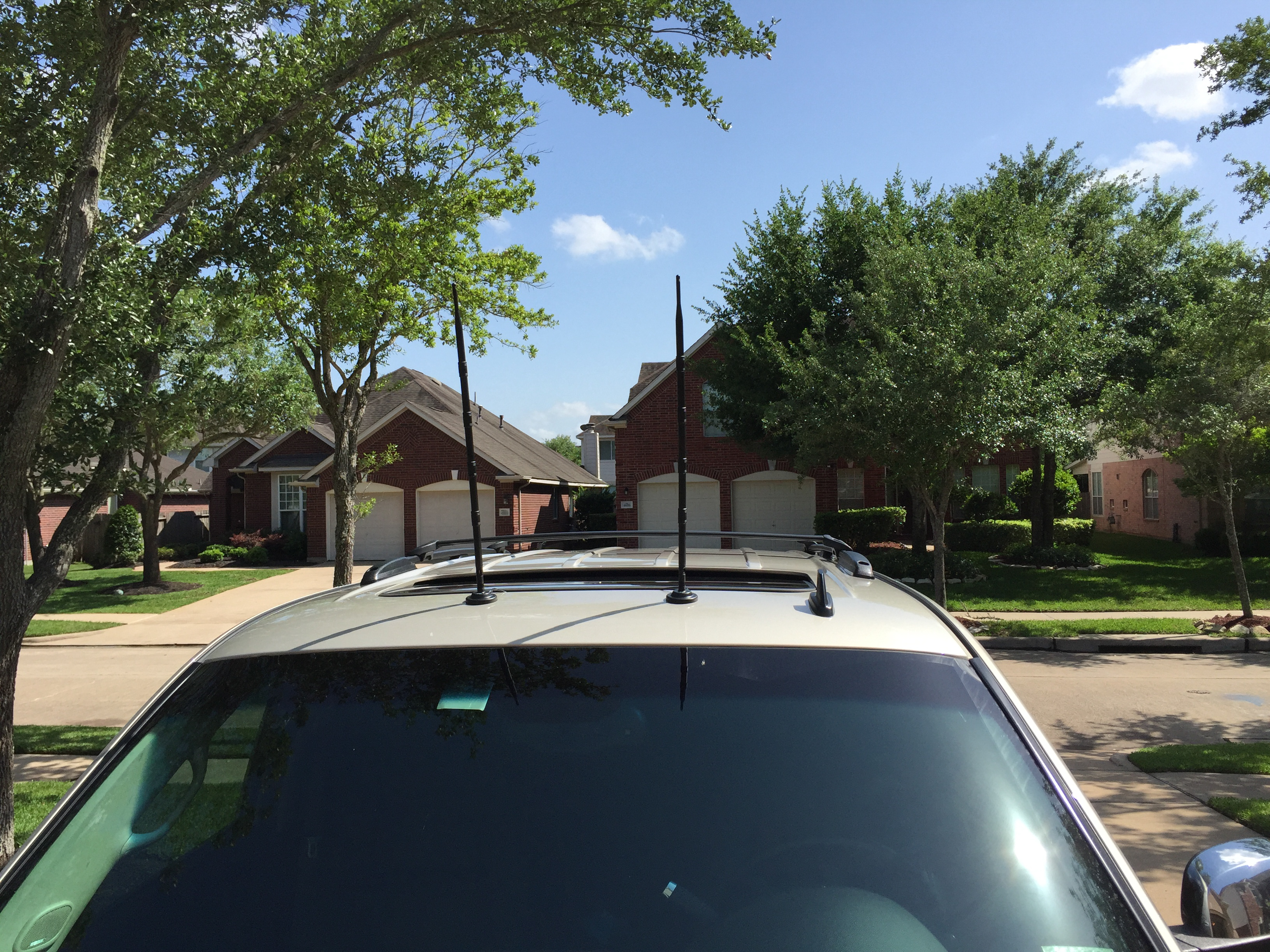

Just wondering if anyone else has done this? And if so what's your indoor setup? Here is mine on my car. 20,000ft with room to go further. I also have a setup just like this for my house using high quality low loss cable with the same results!

I flew from my driveway (while sitting in my Tahoe) and only went out to about 2000ft then came back because I didn't want to stay out too long. Lately, my drone has been attracting bees.
2000ft is not too bad considering my surrounding environment, i.e., wifi congestion, two-story homes, trees, power lines, etc.
I just disconnected the black cables from the antenna end of sunhans amps and connected roof mounted antennas. I forgot to take pics of that connection but the following pics shows my setup (without connection to roof mounted antennas). I like this setup because it come apart very easily and amps, battery, and cables, all come off together and stay together.
I thought it would affect signal performance, but so far all is good.

Thanks! Another question before I order from L-con. What is the connection type from the antenna to the magnetic base?
The antenna I used for my test setup has RPSMA male to connect to RPSMA female on magnetic base...which is a crappy one too. It doesn't stick well on my Tahoe. Weak magnet! And the cable length is only 5ft (supposed to be 6.5ft) with RPSMA male.

Its an n connector. The l coms stick very well.

Remember, range will vary based on surrounding environment. So, with the little amount of time I've had to fly with the setups you've mentioned; cheap $25 external setup from Data-alliance, and from my home, I can say this:
1) Not as far as my DBS antenna mod (unboosted).
2) Very poor. Maybe my Tahoe has very thick metal...lol.
3) Worse than my number one answer.
Please keep in mind that I haven't flown enough times with these setups, and they were just one-offs. I'll need to spend a little more time flying to give you a better answer....which I hope to do soon. I'll update this when I do so.
