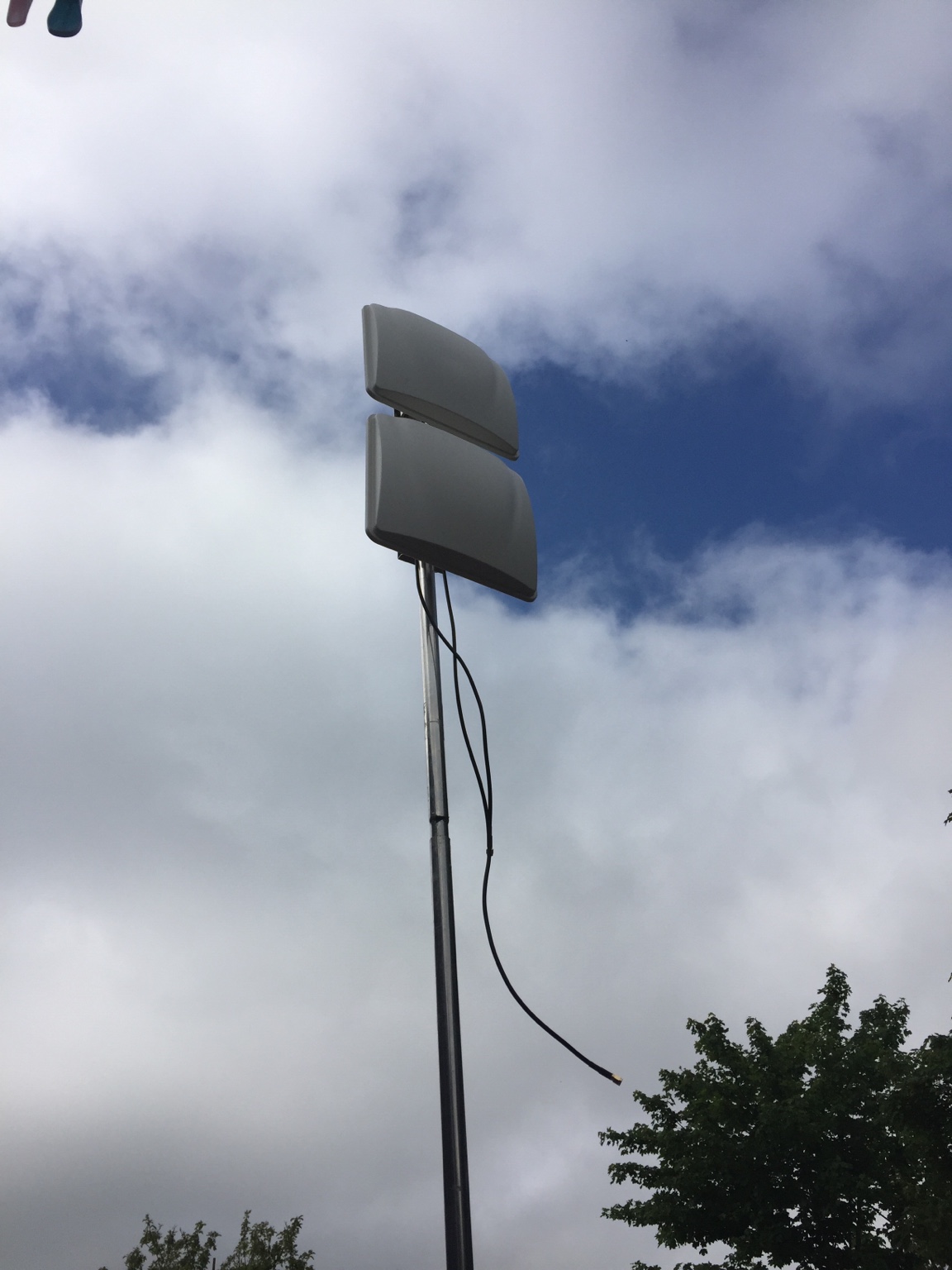

I’ve got 2 questions. 1st, does anyone know which antenna in the P4 is the video downlink? I have a bird side booster but can’t install it because I don’t know where. Then 2nd, is there any way to have a wireless connection from the RC to a ground station (router, booster or whatever) that is then wired to the big antennas? I love the idea of the house antennas but would like to keep the flexibility of not being tied to the wall.

The antenna will be easy to check, you can even do it without tearing P4 apart. Pry the legs loose and disconnect one, that's all you have to do, u don't have to do both, after disconnect fire it up and see what channel isn't working, I'd guess if it's like it should be, number "2" should be the downlink, or black one, but that's a shot in the dark really.

It's best done with an RF power meter, so no tear down is necessary. I have one, but haven't learned how to use it yet. Be aware that it can potentially vary from bird to bird, as there is inconsistentcy in their location, depending upon the whim of the assembler. Another gem from Tony. :cool:

Yes, the four antennas on the bird are either send and receive for control, or send only for FPV video. There are two of each and each pair should be on diagonally opposite legs for best signal, regardless of aircraft orientation, as that way, one antenna for each will always be on the RC side of the aircraft. The power meter will show continuous power on the video antennas, and there's a YouTube video on how to use it on a DJI Inspire aircraft, as I recall.
