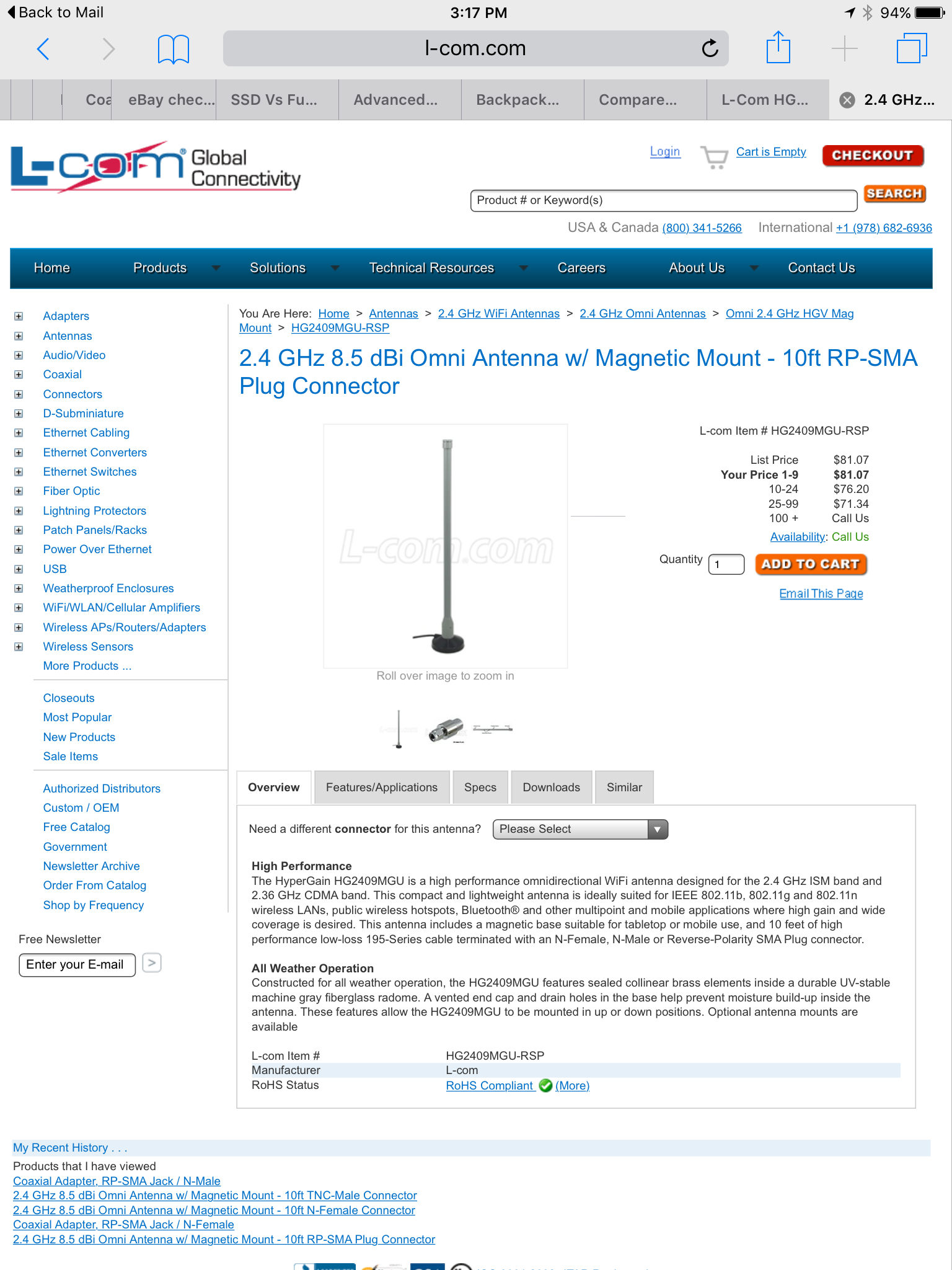

Unfortunately, the connectors I was told to order are the jack style and not the plug style SMS, so they arrived but it's a no go! The combination is really very heavy, adding even more weight on a cable, so I am going to return everything and reorder with the correct lightweight connector, which will be available next week. Here's the correct one:HG2409MGU-RSP

So, your going for the car first gadget? I just talked to the company that has the 5' Hawking's for $45 to see if it was his last one or not, if not I'm going to get two for that price, cheapest around. Good job, to bad they messed up the order though man.
The correct antennas with the SMA plug connectors have been back ordered for a month or so. The conversion connectors were a workaround that just didn't work out. Way too heavy with the N plug alone on the end, and even heavier with yet another converter connector, even if the correct one. Also, by ordering them factory installed on the end, there is no additional signal power loss, from adding additional converting connectors, changing the end piece configuration. The complete correct setup for our transmitters should be available to order next week.
I've had a ton of different adapters at times and notice no loss in range. Sure it would be better to use as few as u can but makes no noticeable difference that I've seen.

It was told the power loss would only be 0.3 dB. That really wasn't the issue. It was the huge additional weight the N connector with the proper converter adds to the end, straining the already heavily overloaded transmitter, pulling it further apart. The screw holes are stripped. Granted, inside the car, it's sitting and supported on your lap, and not hanging from a lanyard around your neck, but the less weight hanging off the connectors, the better.
