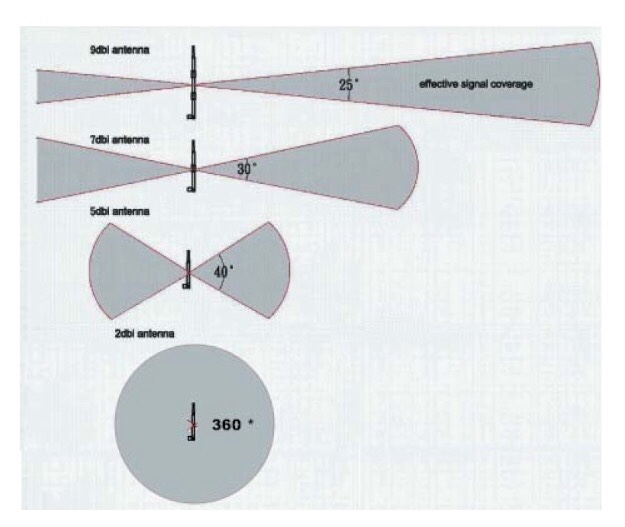

People are getting excited because of the potential for increased range using this huge car mounted antenna, but its usefulness is questionable if not limited.
Antennas do not amplify the signal. They just focus the energy in a particular direction. So an omnidirectional antenna like this will achieve a much longer range, but at a much reduced vertical angle of coverage.
Best is to look at the following image to get an idea:
The 9dbi antenna has a much bigger horizontal reach, but at a 100 ft distance, it can fly only at an altitude of max 22 ft! If the antenna is angled backwards 12.5 degrees, then the max altitude is 44ft. Anything above that, it will get outside the radiation zone and lose connectivity. Since the car antenna is mounted in a fixed position, hence cannot be aimed, the phantom will be able to maintain connectivity only within the 25 degree cone.
In that sense, a flat antenna, or a windsurfer is better because it does not have any radiation going the opposite direction of the phantom and has an increased cone of transmission. (BTW, the 2dbi antenna radiation pattern, is incorrect. It is not a full 360 degrees. It does dip at the poles. All omnidirectional antennas do. The actual 3D shape is of a doughnut.)

I didn't say that you could not achieve that distance, nor did I say that your videos are a fabrication. I do believe all your setup and your results, other than the flying on top of an omnidirectional antenna. If it worked, you may have had signals reflected from other objects, or your antenna was tilted.
However various people such as hzl are trying to twist what I said into something I didn't. That's trolling.
My original contributions, which I stand by, are:
A) antennas do not amplify signals, they distribute energy.
B) a taller omnidirectional antenna has a narrower vertical radiation pattern, and a further horizontal radiation pattern.
If you or anyone claims that they can, by changing an antenna , increase coverage in a direction without reducing coverage in another direction or axis, than they are claiming that they can create energy out of nothing. This, if can be achieved deserves more than a Nobel prize..

As to the facts: regardless of the technology, there needs to be a wave emanating from the controller that will reach the bird. If it does not reach it, the handshake is irrelevant. I have to reemphasize: I am not debating his range. Being at 1000ft high, when you are at 20,000 ft distance, is definitely within the radiation cone.

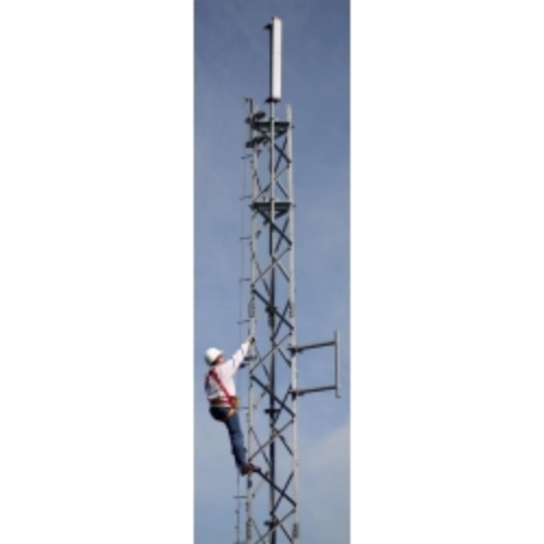

As to me calling his BS, use whatever better term you want but look at his roof and tell me if that is a 50ft antenna. For comparison purposes the following is a real 50ft antenna tower:
