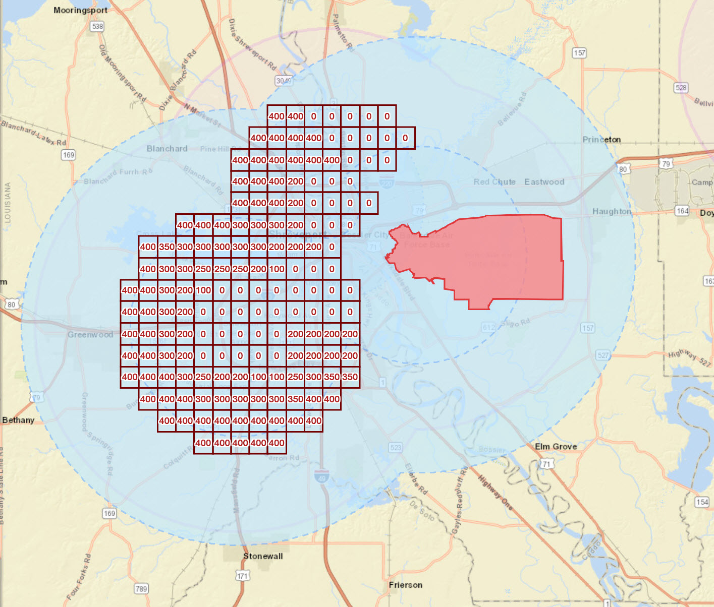

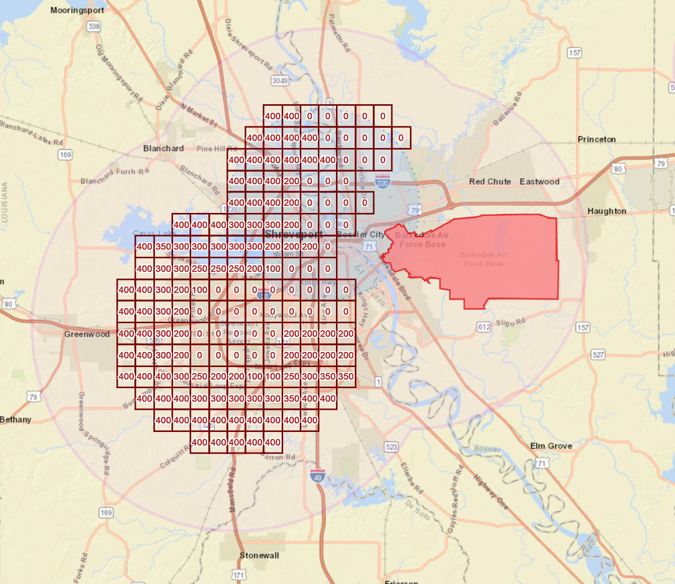

Here are the screen shots:
One with the blue is the class "C" from the regional airport and the other one shows the class
One with the blue is the class "C" from the regional airport and the other one shows the classView attachment 86934 View attachment 86935

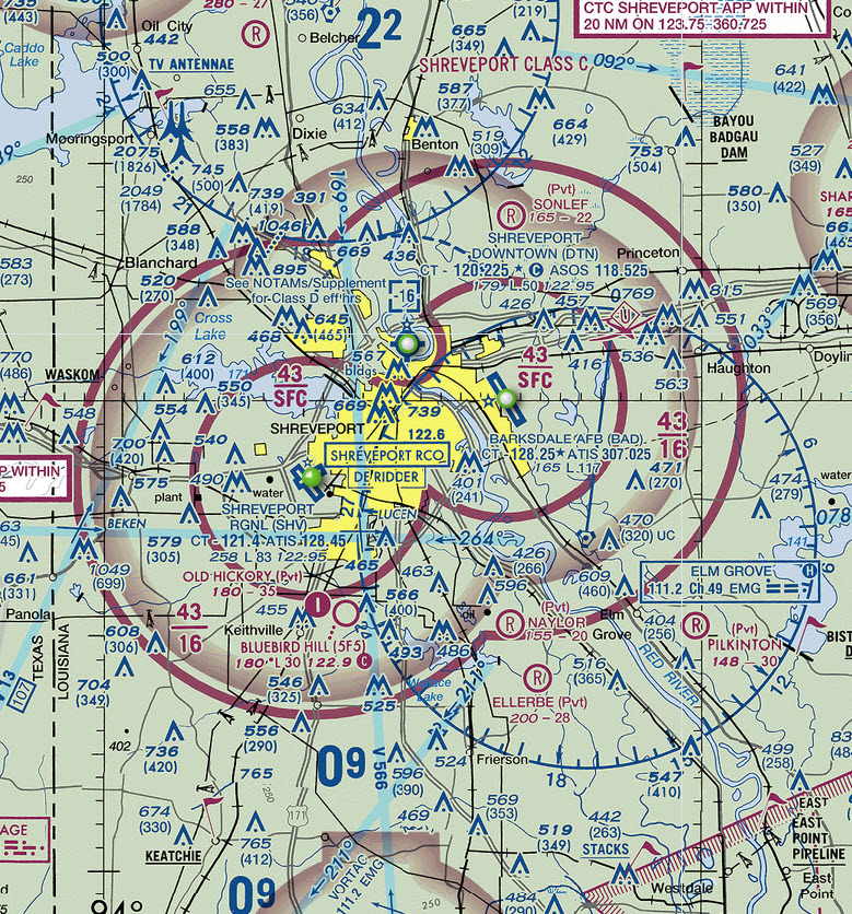

I agree, I also looked at the charts on Sky Vector but it is a little hard to determine your exact spot but it looks like there is conflicting information between the charts as it kind of looks like you might be in that inner class "C" from the regional airport.

Actually Sky Vector looks more like you are in the class C outer circle of the AFB and maybe the AFB has declared all their space restricted and the charts have not been updated to show that??

Well I have gone to skyvector, airmap, arcgis and none of them show me in that Class C Airspace. I'm in the outer circle which starts at 1600 ft. You may be right about updates but mean while I should be able to fly where I'm at. This sucks with dji. I guess I well try and contact them since they have my drone shut down and not able to fly in this area

I agree, I also looked at the charts on Sky Vector but it is a little hard to determine your exact spot but it looks like there is conflicting information between the charts as it kind of looks like you might be in that inner class "C" from the regional airport.View attachment 86936
The outer ring of class C airspace (solid magenta) is from 1600 to 4300 feet. Below that there is Class E (shaded magenta), as you said, from 700 feet to 1600 feet, and below that, from the SFC to 700 is Class G. At least thats what I get from the chart.......
