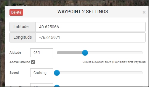

Flying a prescribed route using Litchi, you can choose to set all the waypoints at a certain altitude "above ground". Then your craft will always be at the chosen height relative to the ground. See the notations on the waypoint settings here...
Note: The steeper and more rugged the terrain, the closer-together you'll want to set the waypoints.
On this flight the waypoints were never set to more than a couple hundred feet "Above Ground", yet the range of altitude was about 800 feet.
