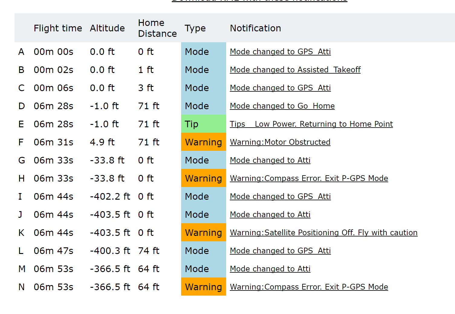

Ive synched my flight data with HD but can't find where to export the text file or maybe I have to convert the csv file? While I work on getting the flight log in the correct format, here is what I'm seeing..... It does not look like my home point was updated.
in the log file after the crash everything seems to be okay until I attempt to start the AC and see this:
does anyone know if this is indicating an error with the motor or is is the ESC?

Ok, so the AC was 22m from the home point when the low battery RTH initiated. Expected behaviour.
Your home point is recorded as the middle of the road. Presumably, as you were attempting to land, you had moved from the original launch point (you could see the AC from where you were standing).
How did you reset the home point (or at least try to). Was it set to aircraft, user or dynamic. Does your IOS device have cellular service (inbuilt GPS receiver).
Did you see a new home point recorded?
To the extent you can't demonstrate an issue with the home point updating I suspect you have very slim chances with DJI for any warranty coverage.
