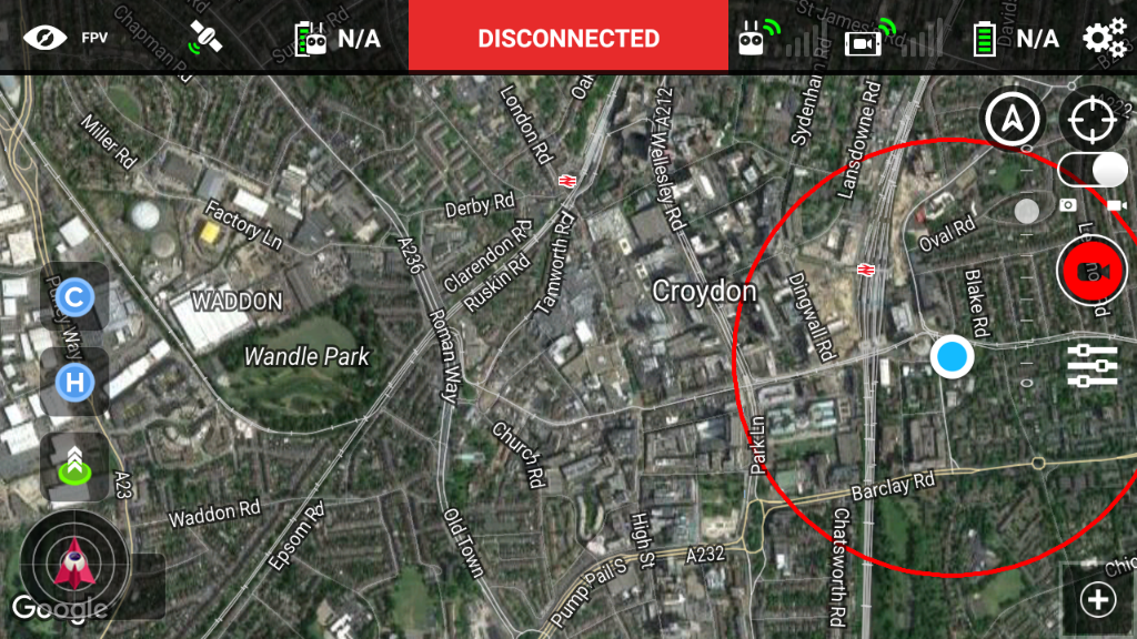

DANGEROUS bug -With drone off, not connected I opened my Android Go 3.1.2 app and on HERE maps blue dot is 1+ km west of my actual position, try this yourself
Omg your right. The arrow is where I am now, look at the blue dot. This may also explain why litchi flew my mission then after it completed it randomly flew away. Luckily I was able to get it

From what I have been reading .. people seem to be narrowing the problem down to the change from Google Maps to Here Maps .. which is an old Nokia programme now owned by Microsoft .. if you wind back you get Google Maps back which appear to be ok so I have read.
Must be an Android thing .. or does Apple use different mapping ..
Another suggestion I read was switching mobile GPS off and setting RTH via the drone.
Let's hope DJI sort this .. they apparently know about this and everyone is saying email them when it happens so they sort it out.
