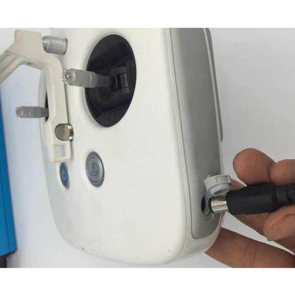

I don't see where the flight battery charger hooks up to the controller...I use the USB cable into my computer to charge the controller. The controller IS holding charge so far.
On the right side of your controller there is a round plug, remove the plug and insert the AC adapter on your DJI charger.
EDIT to Add:
A P3 Standard will charge with a usb cable may take up to 3- 4 hours to charge.
