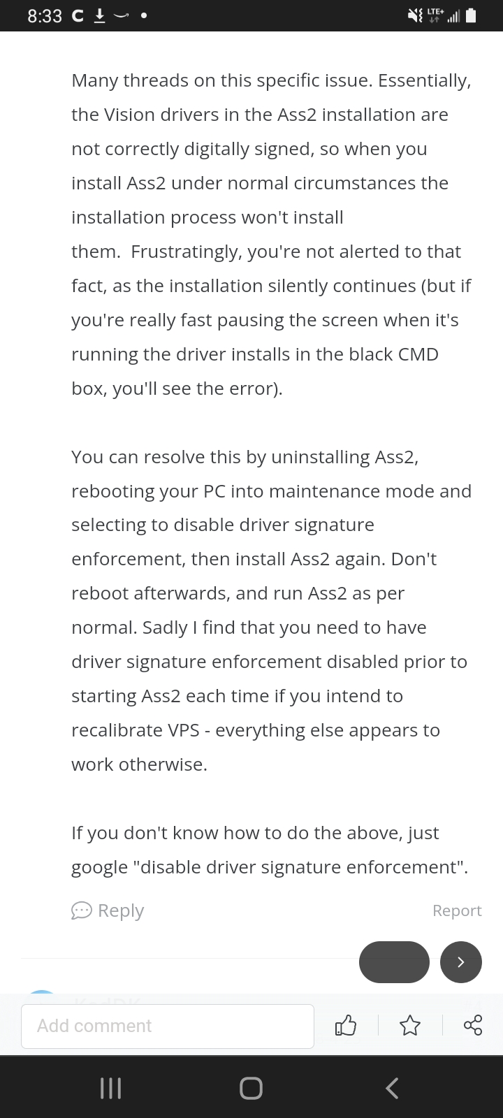

I like a bunch of other folks finally got the vision sensor calibration error so I've been looking for a solution and I'm happy to report I found it. The issue is with DJIs Assistant 2 and the drivers not being digitally signed, so they don't tell you that since there not signed they then don't get installed lol. I found a post on the DJI Forum discussing the problem from 2018 and also how to fix it. I was skeptical at first but I followed the directions and then successfully calibrated my vision sensors on the first try. You have ro uninstall Ass2 then boot your computer into safe mode and disable driver signature enforcement, you then reinstall Ass2 but this time it will actually install the proper drivers lol. You can then calibrate your vision sensors as normal. Hope this helps anyone still having this issue. Not surprised to find the problem was DJIs janky ( mod removed language) language software lol.

Thanks for that info. I found the attachment to be a bit confusing, however. The way it reads, you would boot up in safe mode, disable the driver signature enforcement and reinstall Ass2. Then it says to NOT reboot when you recalibrate your vision sensors! Does this mean that, whenever you need to recalibrate your vision sensors, you must do it in safe mode? Sounds a bit nuts to me...

You’re not confused. You read it correctly lol. I did find a little easier way to get it done, you hold the shift key and then restart your computer is an easier way to get to the menu that toggles driver signature enforcement. After turning it off you boot computer and install Ass2 and then calibrate your vision sensors. As far as being nuts I agree I guess it all boils down to how bad you want to calibrate your vision sensors lol. To be honest it sounded a lot worse than it actually was.

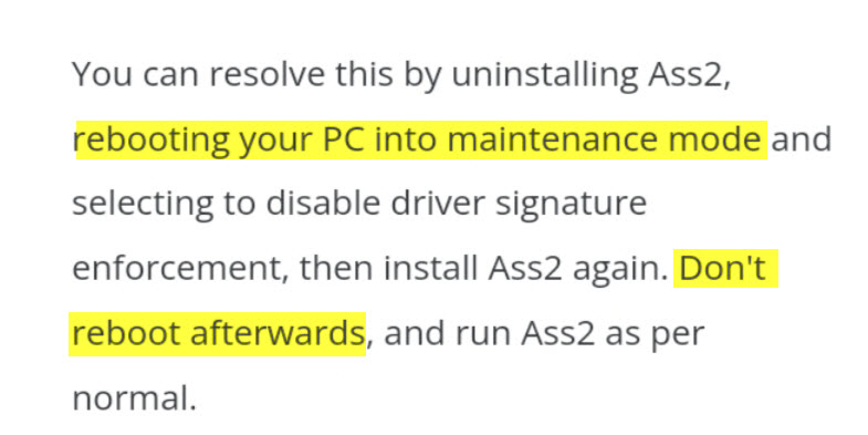

I guess my problem is understanding, if you have turned off driver signature enforcement, why you would need to still run Ass2 in safe mode to calibrate the vision sensors. Wouldn't disabling driver signature enforcement make safe mode unnecessary?

You turn off driver signature enforcement and then boot the computer out of maintenance mode and reinstall Ass2. You got lost somewhere along the way lol…. You don’t have to run Ass2 in safe mode at all. After you turn off DSE the computer boots normally.

OK, got it now. But, just so ya know where I derailed, here's an excerpt from the instructions. I read it to say to boot in safe mode, disable driver signature enforcement, reinstall Ass2 and then DO NOT REBOOT as you run Ass2 as you would normally but in safe mode.
