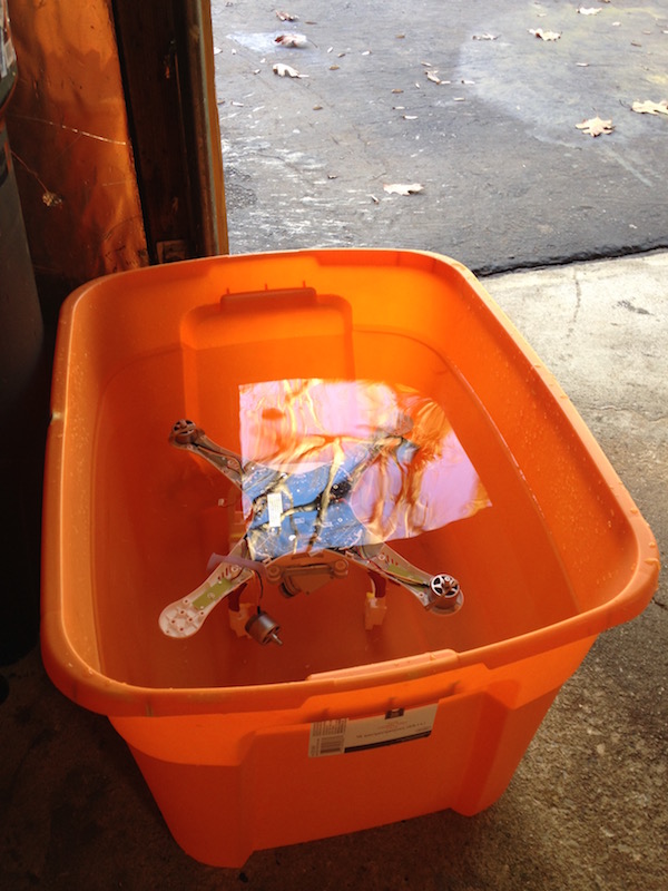

Very painful to look at. So is this taken today from my garage of my P3S taking a bath after being in salt water.
IF you get good results, please have a conversation with me on this site to help me out (don't know how, but I see it)
I am happy to report back that a new fresh water soak WORKED!: I was replacing the fresh water gradually by having the hose trickle water in and over-flowing out on to the driveway for 10 hours, then compressed air blow-through and did 2 fans and dehumidifier in a very warm (small) room for 2 days. Did the "RC Link" thing once I got the new battery in, and it seems to work. Now, I will not be flying it over my grandmother or populated areas mind you, but the signals and camera image and gimbal all work. For now.
So soon I will closer it back up, and try the voters (without props) and do more testing before trying a take off.
But good news for me so far! Thanks everyone.

It may go against the grain but if any electronic item has had a dunking in salt water soaking it in fresh water will not make it any worse - it can only help!
