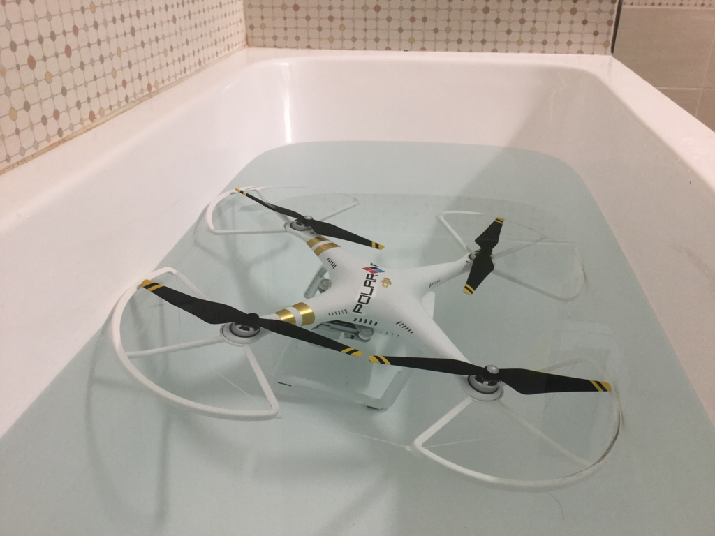

Very painful to look at. So is this taken today from my garage of my P3S taking a bath after being in salt water.
IF you get good results, please have a conversation with me on this site to help me out (don't know how, but I see it)
I am going to do a rice bag experiment...
