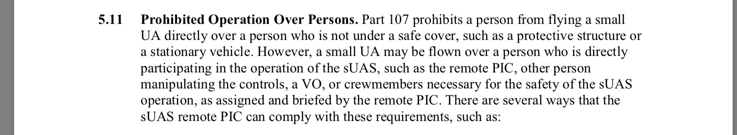

I just noticed this. Can anyone clear this up for me? Both found on FAA website
Part 107 Summary, dated June 21, 2016
- Small unmanned aircraft may not operate over any persons not directly participating in the operation, not under a covered structure, and not inside a covered stationary vehicle.
Link: https://www.faa.gov/uas/media/Part_107_Summary.pdf
AC_107-2AFS-1_Signed (Circular) 5.11, dated June 21 2016
- Prohibited Operation Over Persons. Part 107 prohibits a person from flying a small UA directly over a person who is not under a safe cover, such as a protective structure or a stationary vehicle.
Link: https://www.faa.gov/uas/resources/policy_library/media/AC_107-2_AFS-1_Signed.pdf
Thanks.

There is no contradiction in the two references you have provided- at least not with respect to flying over persons involved in the operation.
You might have missed it but if you go back to 107-2 it seems to be covered clearly;
  1. 5.11 Prohibited Operation Over Persons. Part 107 prohibits a person from flying a small UA directly over a person who is not under a safe cover, such as a protective structure or a stationary vehicle. However, a small UA may be flown over a person who is directly participating in the operation of the sUAS, such as the remote PIC, other person manipulating the controls, a VO, or crewmembers necessary for the safety of the sUAS operation, as assigned and briefed by the remote PIC.
