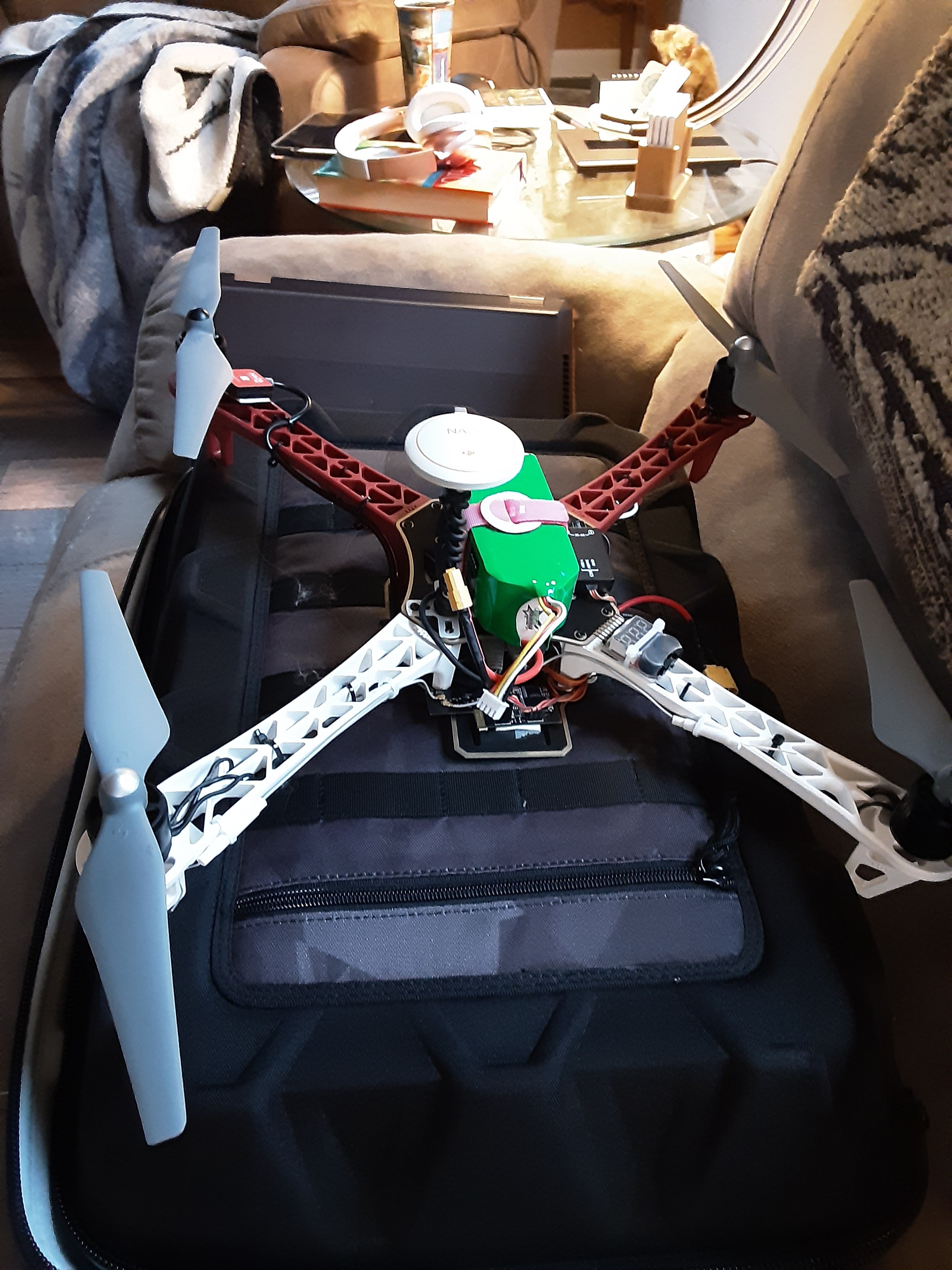

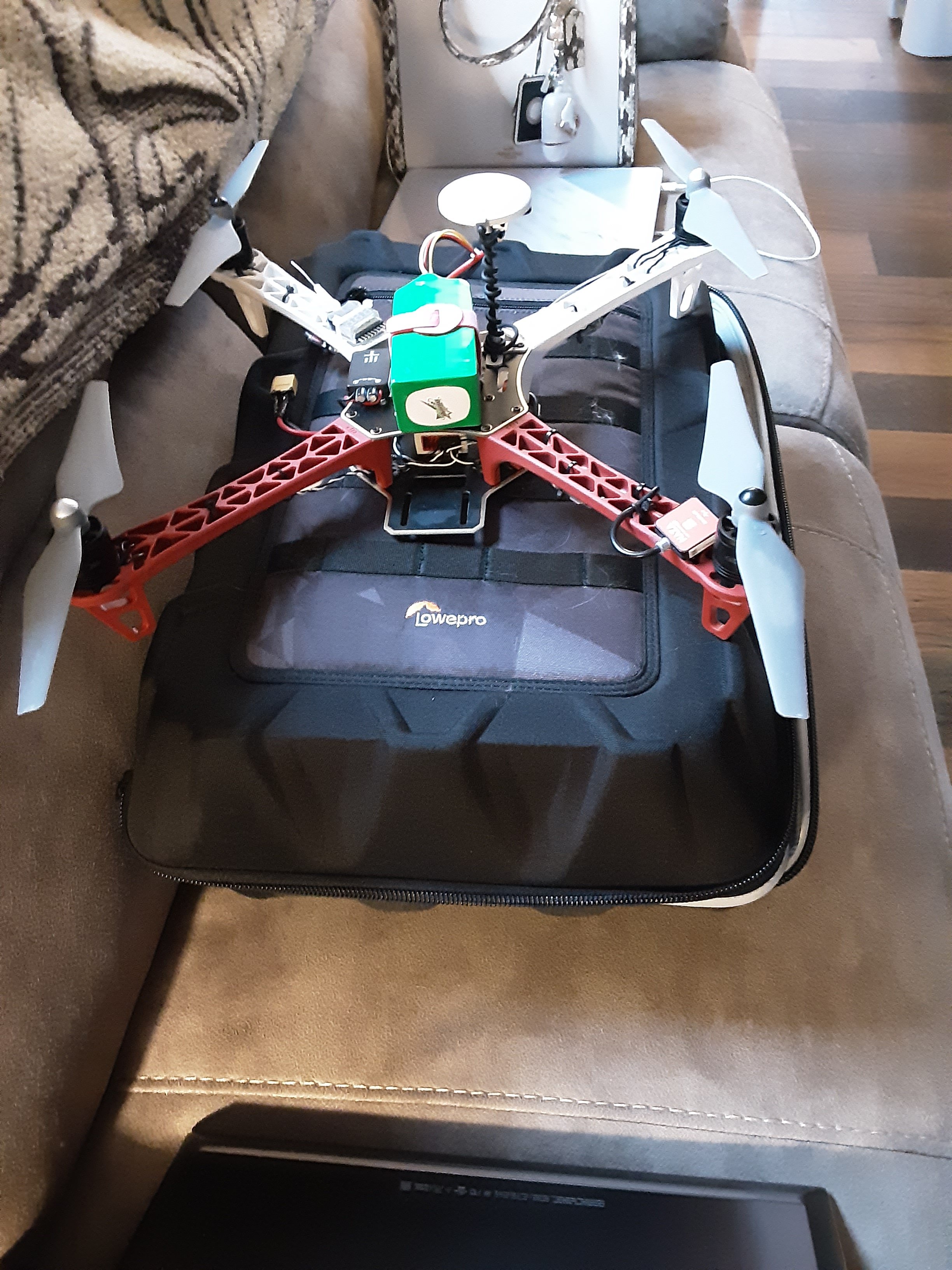

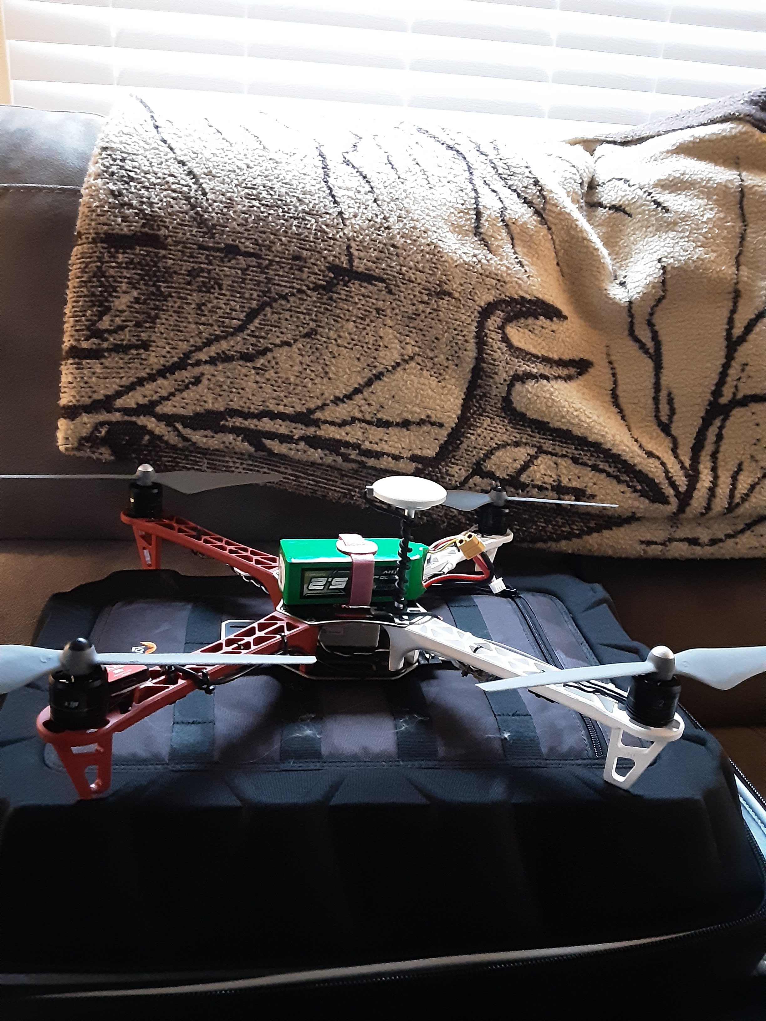

F450 flamewheel naza m lite 2312E motors from DJI 420 lite ESC multistar 5.2 5200mah battery does not hover it toilet bowls tried different gain settings same tried factory settings still toilet bowls everything is centered even bought another flight controller any input is welcome thank you

Hi, most likely the magnetometer (compass). Could be damaged or broken, needs calibration, could be placed too close to power wires, or not placed in correct orientation. Flight controller and gps must be positioned correctly for magnetic declination. Check compass numbers in software. Good luck !
Compass numbers are good flight controller and compass face the front I'm thinking bad compass and it won't let me check the IMU in the software
Careful adjusting your Naza compass if you move it u have to measure it again from your naza module and input the correct distance unless your GPS wont work correctly. I have a F550 and I didnt have toilet bowl but I had a issue with it going back and forth really fast I had to adjust some of the expo and gains mine are almost all around 140 140 140 140 but when it was being weird it was at 155 110 455 145 so check all your settings and stuff in the naza assistant program. Also try advanced calibration.

Thanks for the reply bought another compass should be here today. For some reason I cant do an advance calibration in the firmware
Okay keep me updated I'm curious about you getting it working also it should let u do advanced imu calibrate even if it doesnt need it.
Got the compass brand new still no change buying landing gear mounting the battery on bottom when it comes and still no advance calibration .My wife thinks I'm nuts spending money on this drone since I have the mavic zoom it's like hunny it's about the build plus keeps my mind occupied during lockdown
