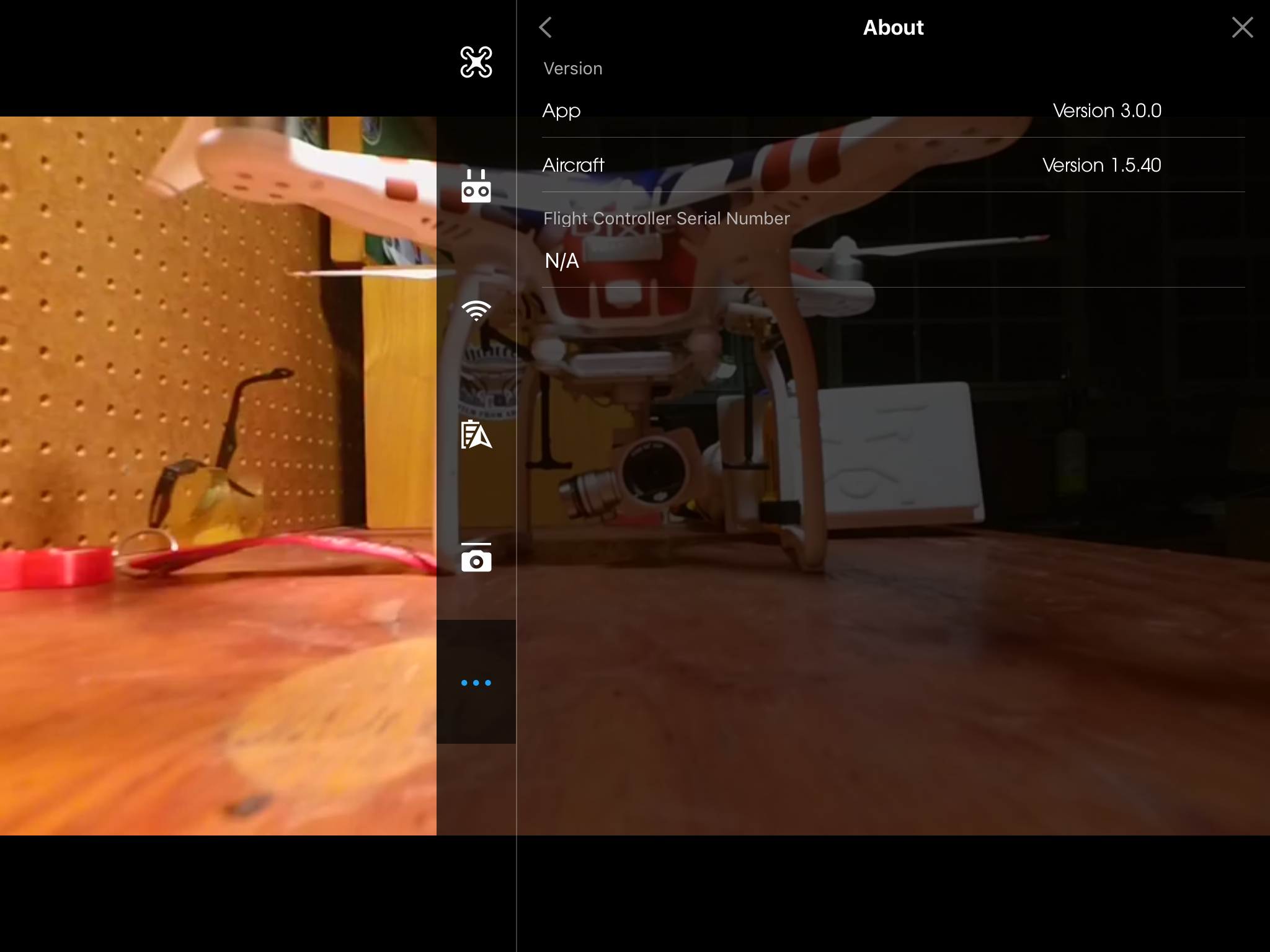

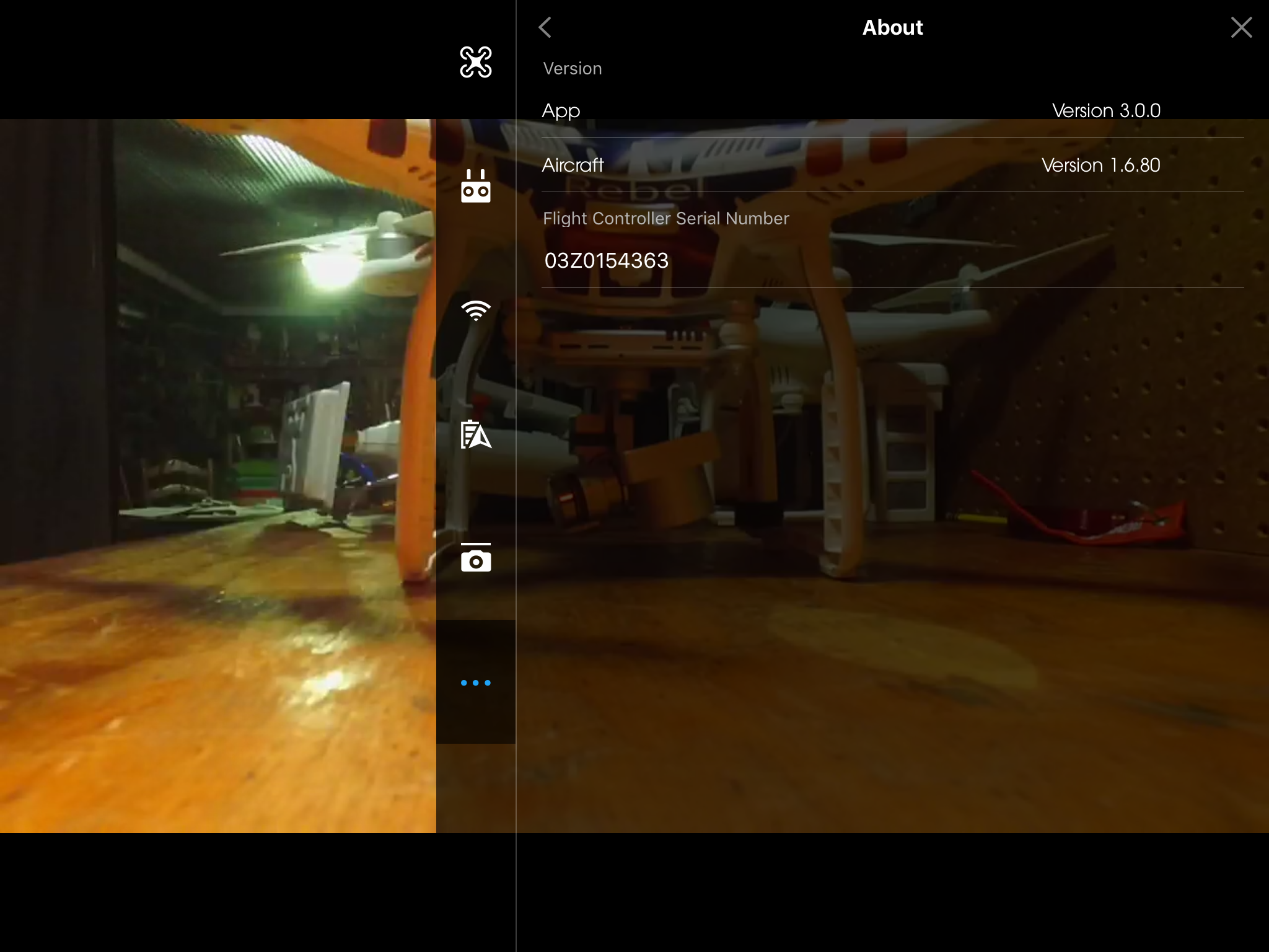

OK now I'm confused . Maybe the P3 4k has a different firmware My 4k is on this rebel.PNG Standard on this dixie.PNG I just assumed both were
the same as I always when I see the banner update . My range has not been affected any . Have been flying my 4K more lately and the last long run I made with it was 16,187' The Standard's was 10,300' . I'm just not seeing no issues ..

OK now I'm confused . Maybe the P3 4k has a different firmware My 4k is on this View attachment 66279 Standard on this View attachment 66280 I just assumed both were
