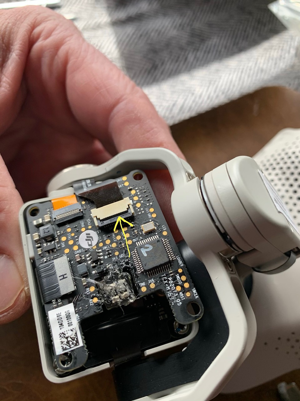

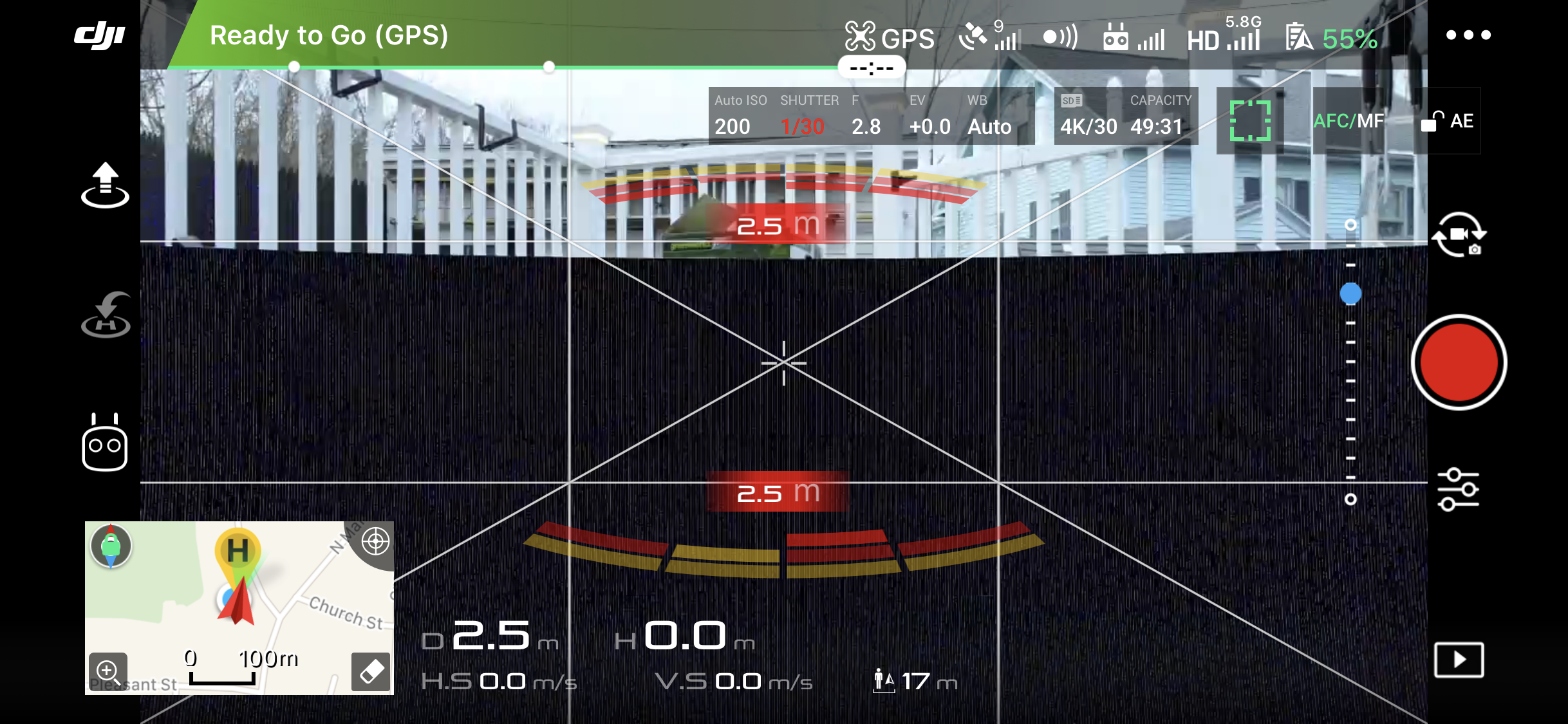

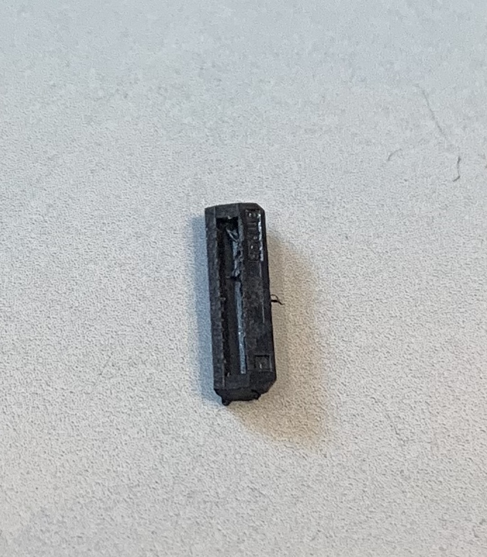

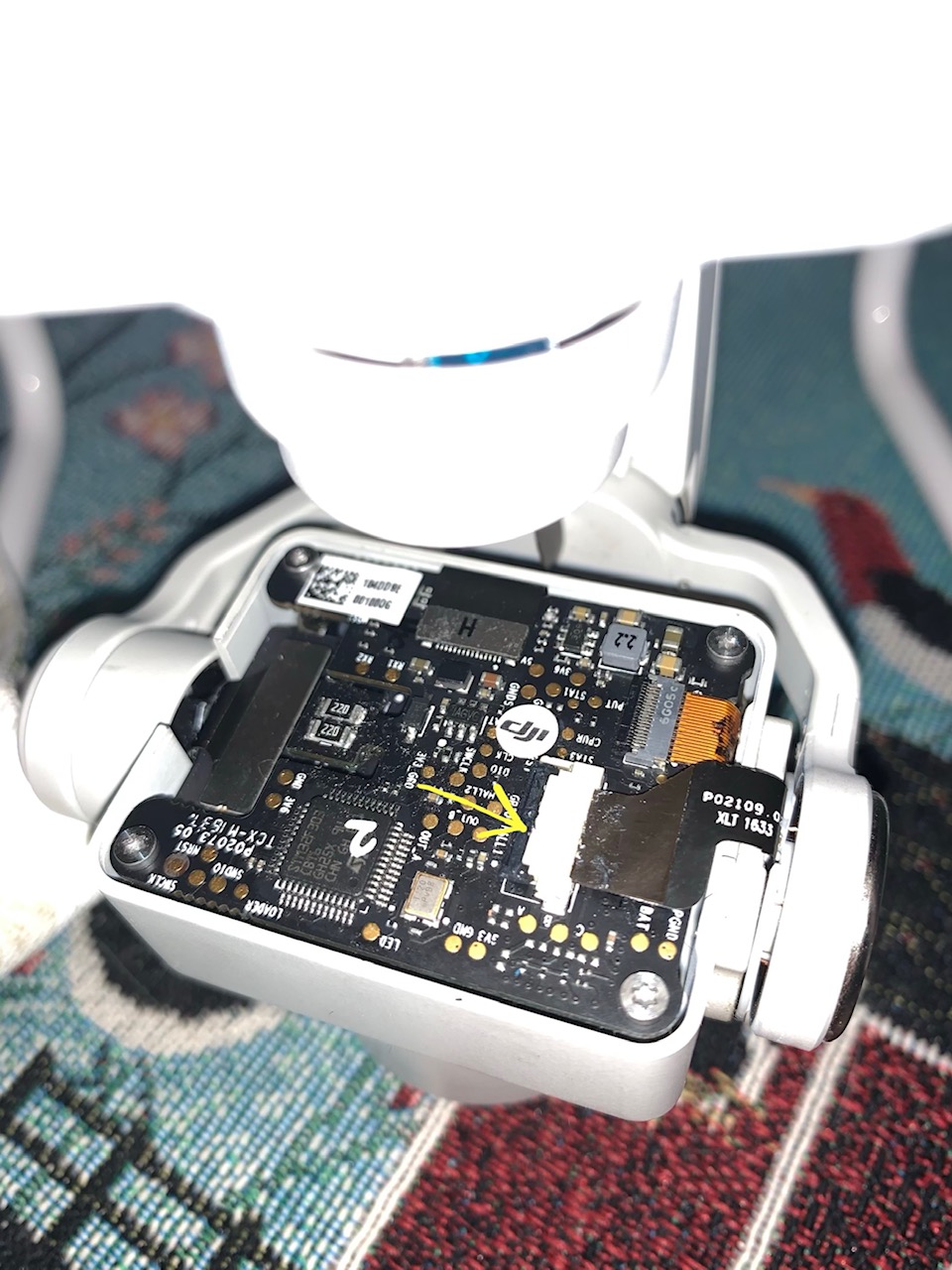

Everything about the ribbon replacement went fine if you TAKE YOUR TIME. I did have one problem. On the circuit board for the camera I broke a very small connector tab that holds in the connector tightly. Without it, it will not compress the connections and it WILL NOT WORK. I could not get the gamble to work and it kept saying that my drone was disconnected when I tried to power it up. I did notice that if I pushed on the ribbon that went into the connector with the broken tab, the nimble would move. I eventually bought some superglue and glued the broken connector tab on to the connector. I waited 24 hours, crossed my fingers and now everything works as it is supposed to. I no longer have any dots in my pictures and the flickering in my video has stopped completely.
The replacement of the ribbon worked for me. The whole process was a bit frustrating but I'm glad I did the replacement myself. It saved me a few hundred bucks in labor and waiting 2-3 weeks to get it back from a local drone repair shop. I have attached all the pictures of the broken connector problem so you can see what I am referring to. The tab on the connector is supposed to be "lifted" and I tried to pull it out, which is why it broke. I have also included links to the video I watched and the person I bought the flex ribbon from. If anyone needs further clarification on my thread please reach out to me. Thanks.
