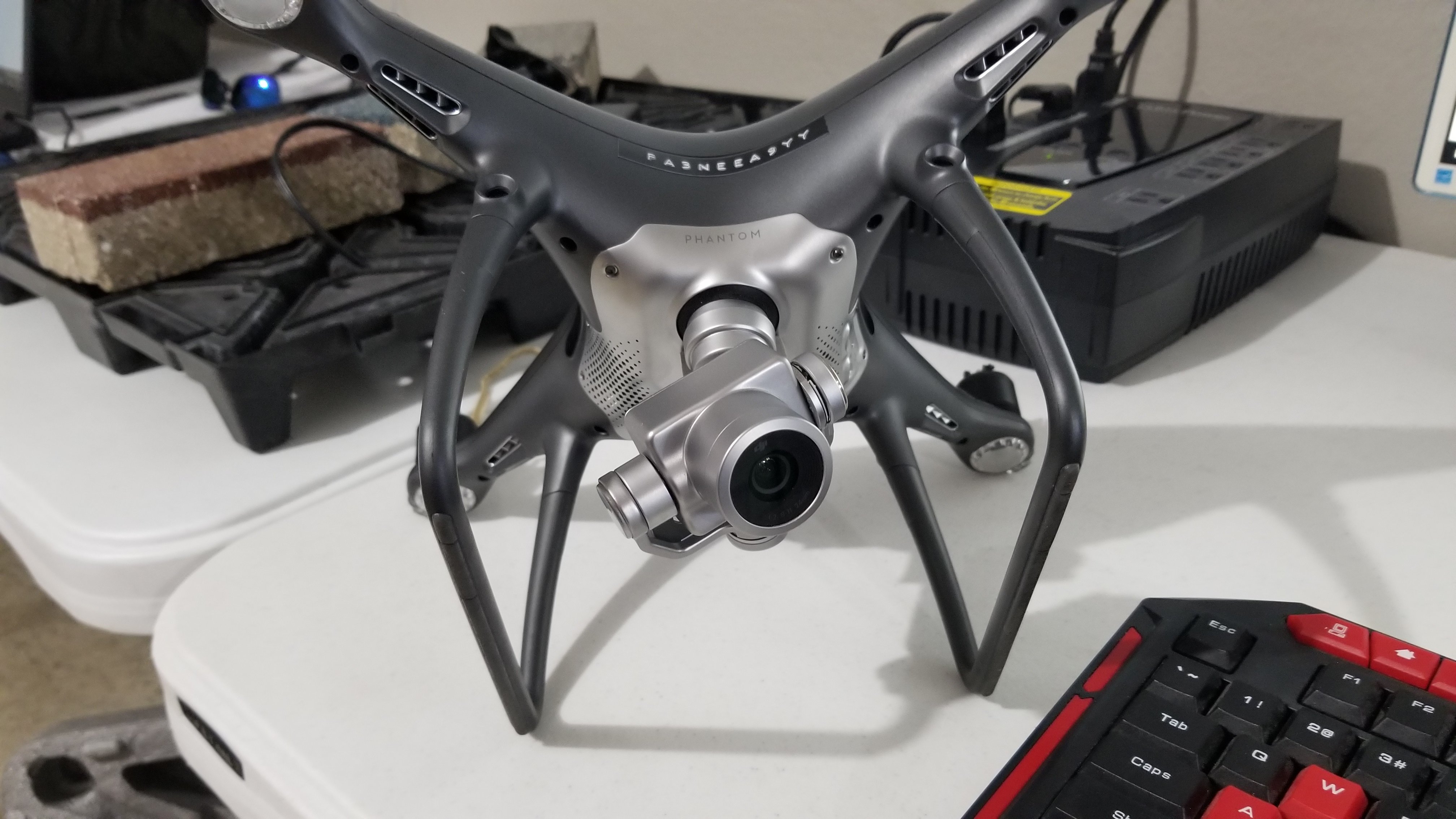

Sorry for the delay. I leave my Obsidian P4P at the office. Here is an original one. The motors are black, the hull isn't as dark and the camera area is a different type of gray.

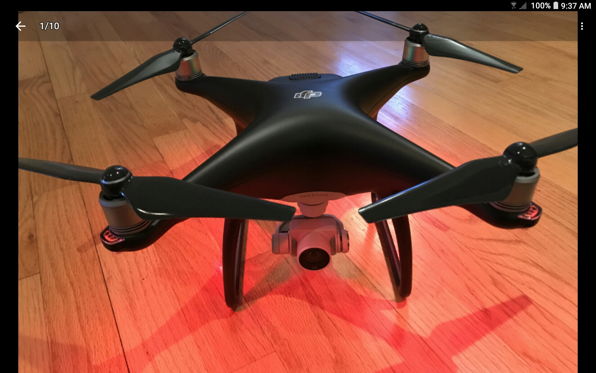

UPDATE: So i contacted Cloud city drone and they said that i have a limited edition phantom 4 black model not the obsidian. Good news right .... Well the body parts are twice as expensive there is the bad news.
Why not tell them to just use the normal white parts? They should fit perfectly and work. Save money. I have never heard of this limited edition Phantom 4 black.
Edit: I just googled it. Apparently it does exist. Still stand on using normal parts.

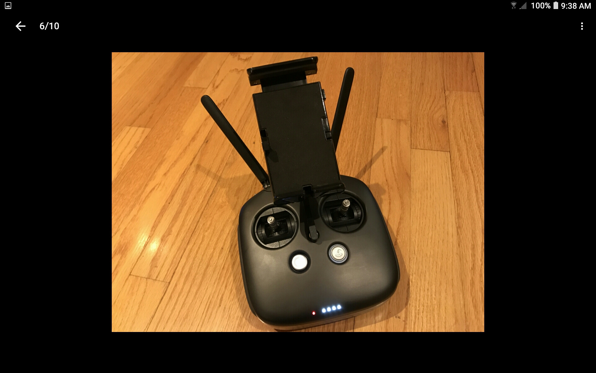

I am everything inside is the same internally, just the color is the only difference. I know mine looked professionally painted and the remote and the batteries are black also.
I am everything inside the same internally just the color is the only difference. I know mine looked professionally painted. and the remote and the batteries are black also.
Wow I did myself forget about this limited edition,,sorry for any in corect info but now we know what it is,,yes I do remember these were expensive and still are,,not seem to hear of these much anymore,you have a good drone

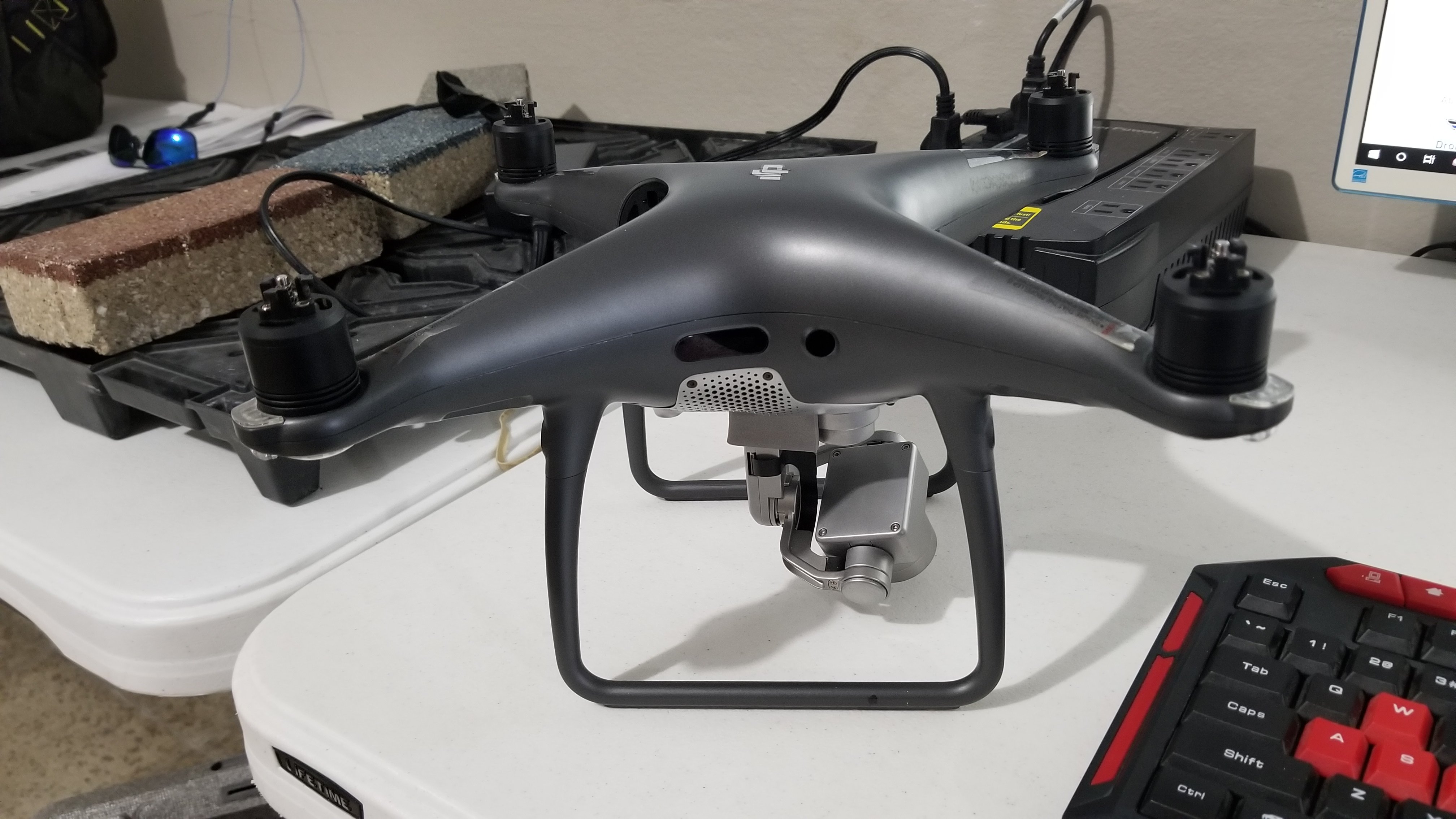

Nice,,yes found one ,still has the silver motors unlike obsedian
Reactions: Ansia
Nice,,yes found one ,still has the silver motors unlike obsedian View attachment 111912View attachment 111913
Yep that is it and it looks awesome cant wait to get mine fixed. Just got the ribbon cable in and installed it now all for led are on and working. I cant test it any further till i get the legs because it will not start with a compass missing.

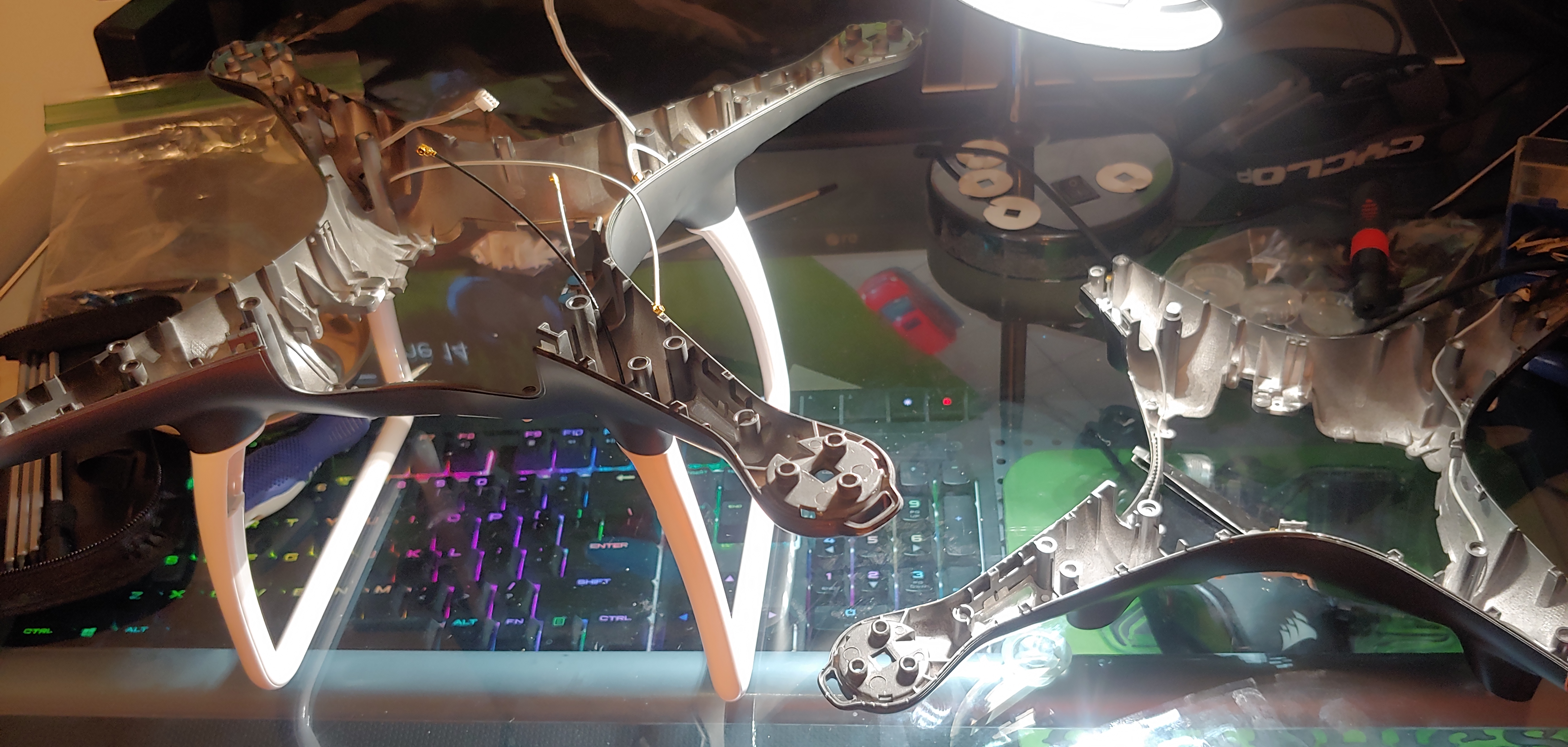

Out with the old in with the new. I'm done with the wires and I'm still cussing the compass connections they were a pain to hook up.

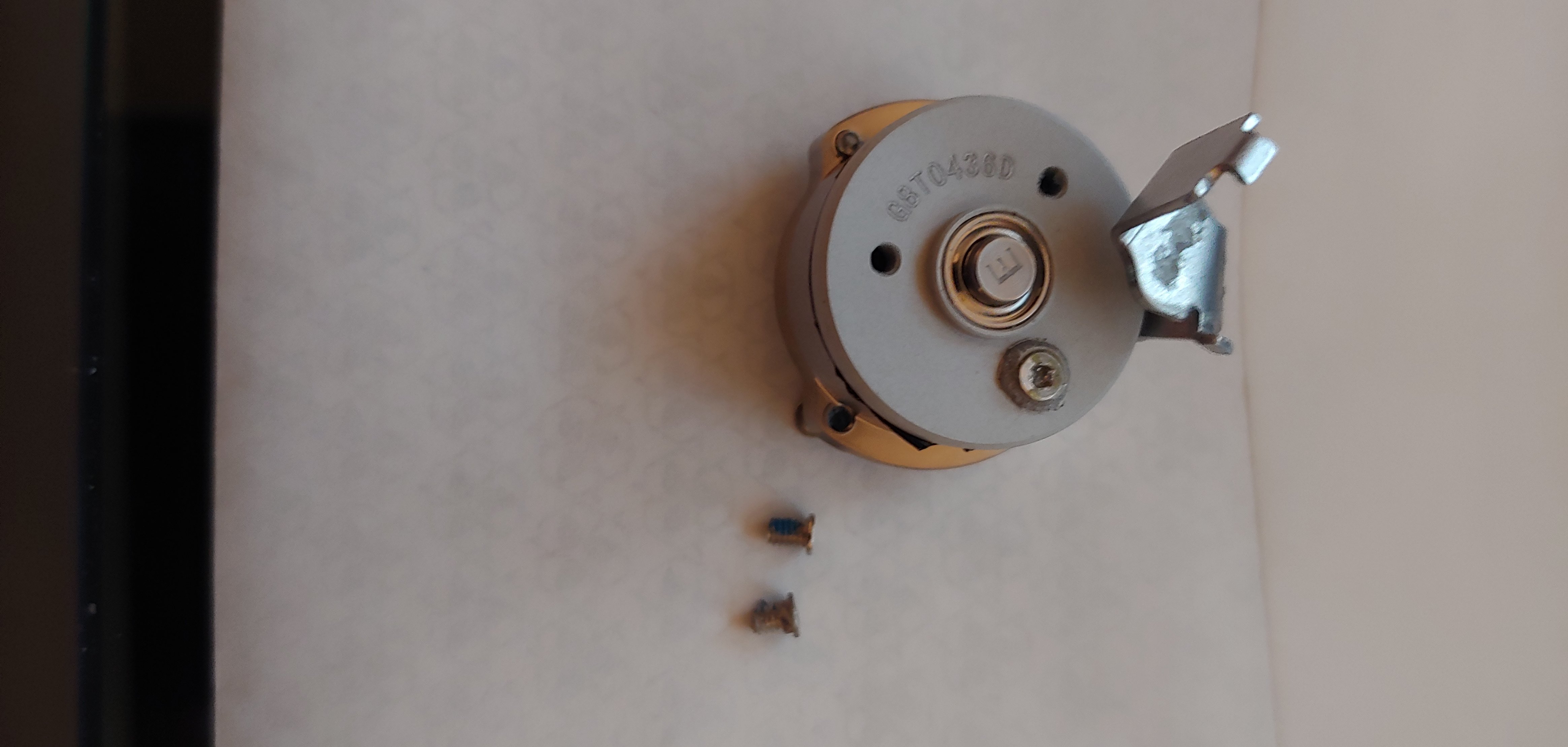

Does anyone know what size these screws are. I have one that is stripped and cant find them anywhere.

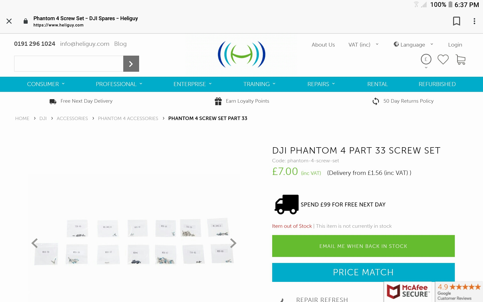

This just picture but came up with Google search ...I could not find 2 screws but this set has all p4 screws
I called cloud city drones and they said that the one I need are not in that screw set and if I find them to let them know where to get them.
I may have what you need. Do you have a micrometer to get the dimensions so I can verify sizes? May not need to do that, but it would help. Three of them?
