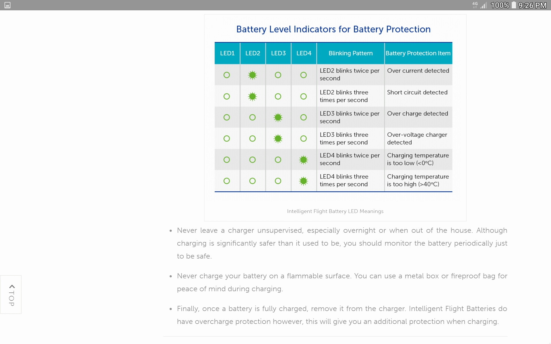

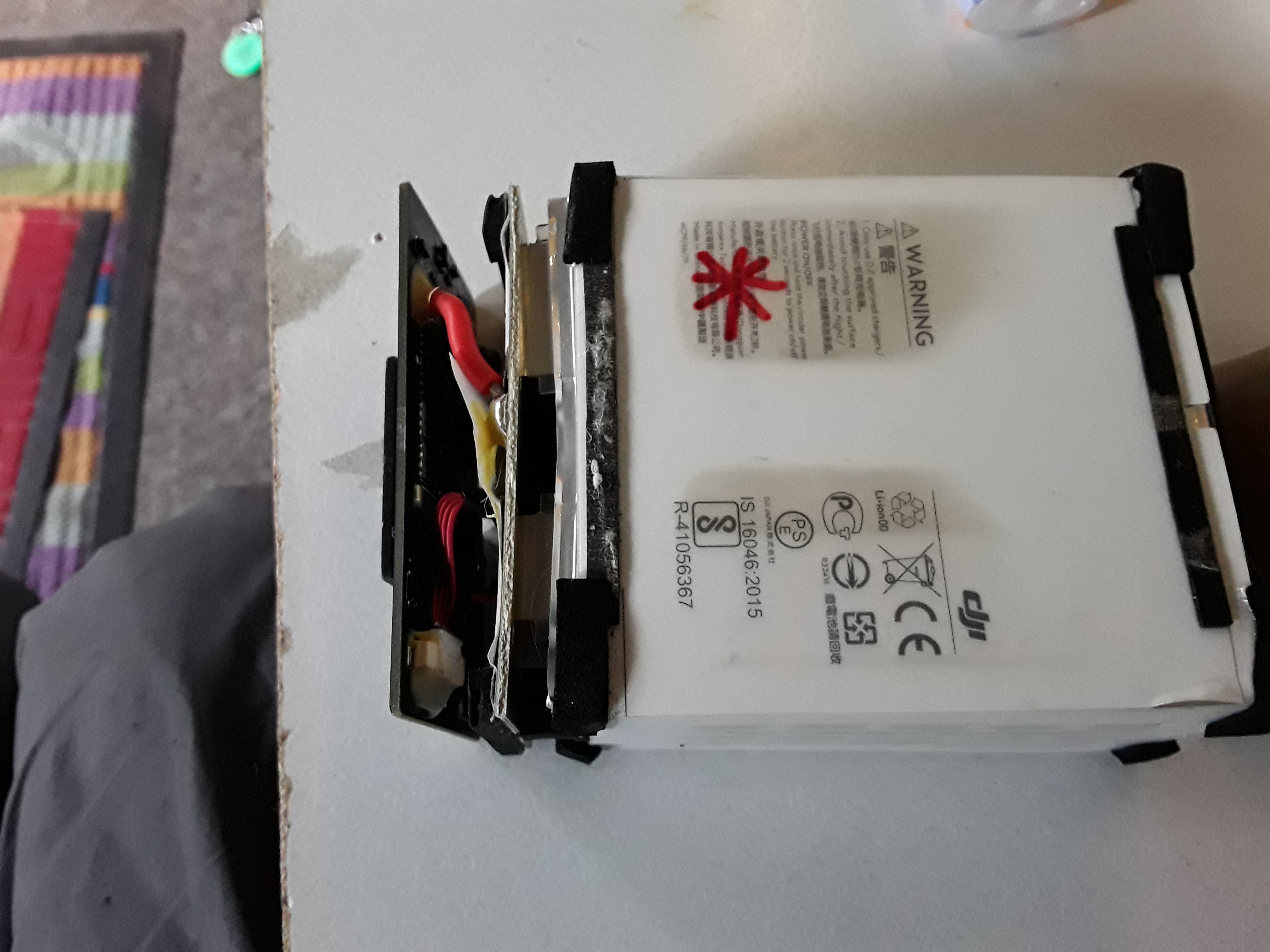

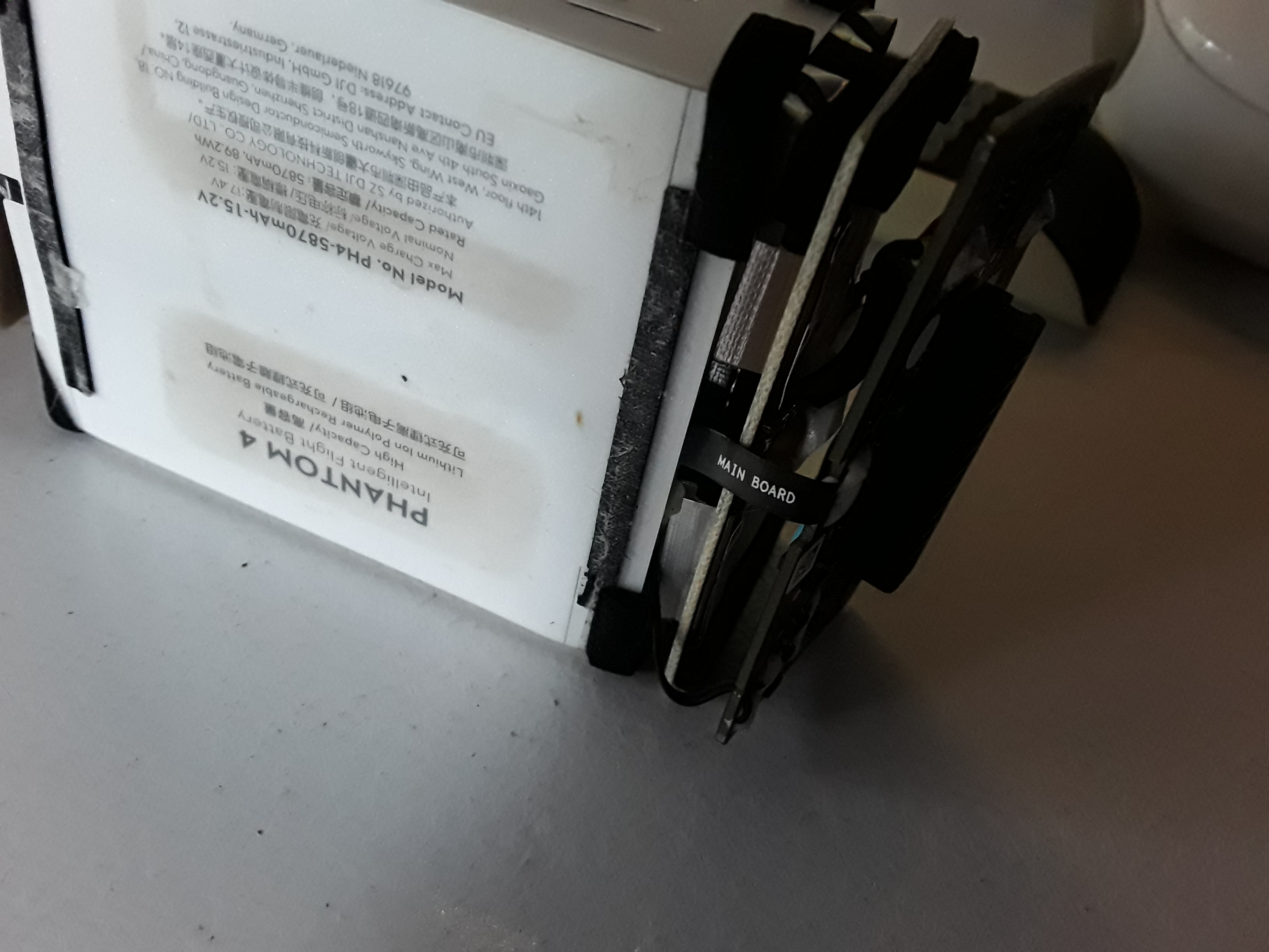

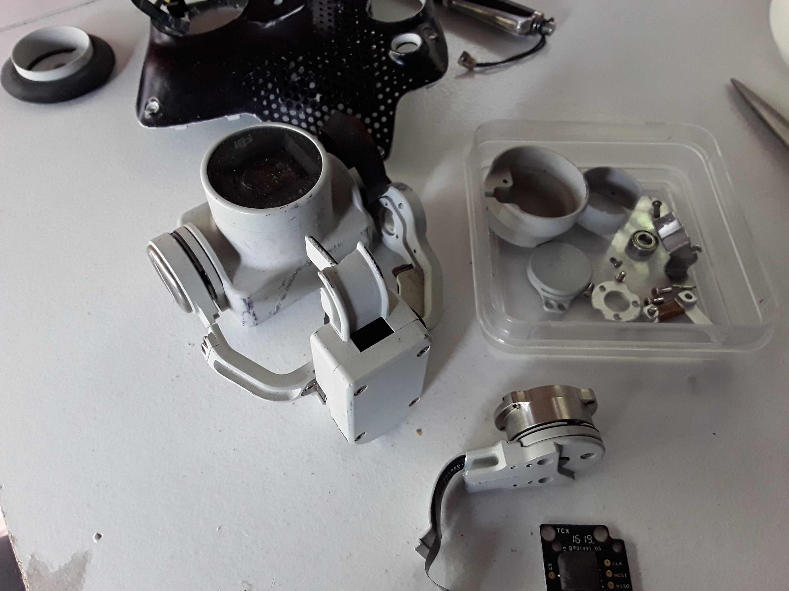

OK that batt got issues,like mine that won't charge because it discharge to just over 2 volt,,day on charger only made it to 2.23 volts,,to low for charger to engage charging,,as can see with my batt there bit of stuff under the cover ,circut board and ribbon cable,,,when at this stage plug with 4 wires needs to be removed and a trickle charge like car charger can be used to get some volts back so dji charger will charge again,,,in saying this it's a dangerous process and need to be treated with care,,I did not go further with this process due to no other charger but working on it,,,if you can start looking for another batt,,or some good used ones,,,battery's not cheap and at 320 each here I plan to try fix this one since it near new ,this batt display no lights,you could pull the covers off and check for visible damage
OK that batt got issues,like mine that won't charge because it discharge to just over 2 volt,,day on charger only made it to 2.23 volts,,to low for charger to engage charging,,as can see with my batt there bit of stuff under the cover ,circut board and ribbon cable,,,when at this stage plug with 4 wires needs to be removed and a trickle charge like car charger can be used to get some volts back so dji charger will charge again,,,in saying this it's a dangerous process and need to be treated with care,,I did not go further with this process due to no other charger but working on it,,,if you can start looking for another batt,,or some good used ones,,,battery's not cheap and at 320 each here I plan to try fix this one since it near new ,this batt display no lights,you could pull the covers off and check for visible damageView attachment 111880View attachment 111881

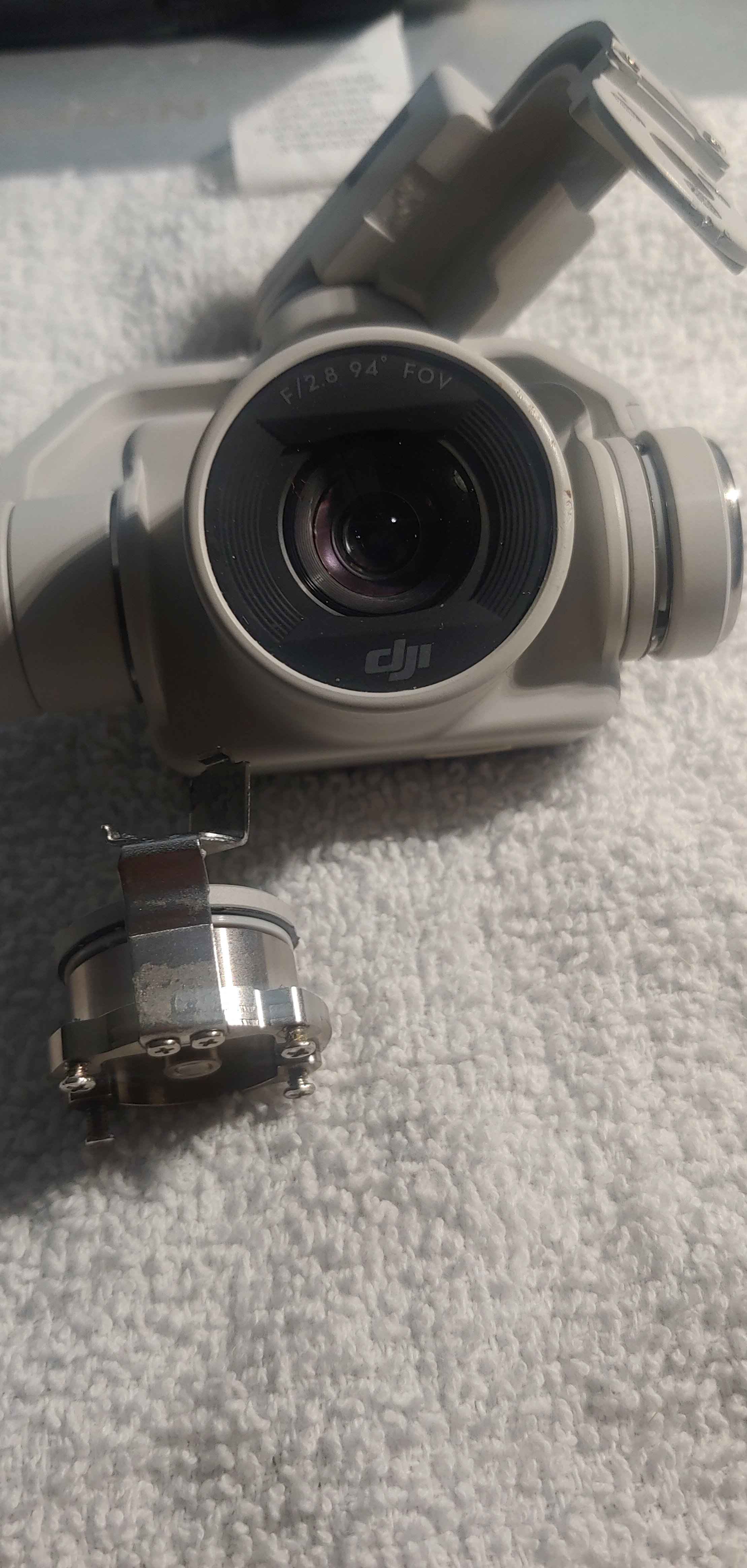

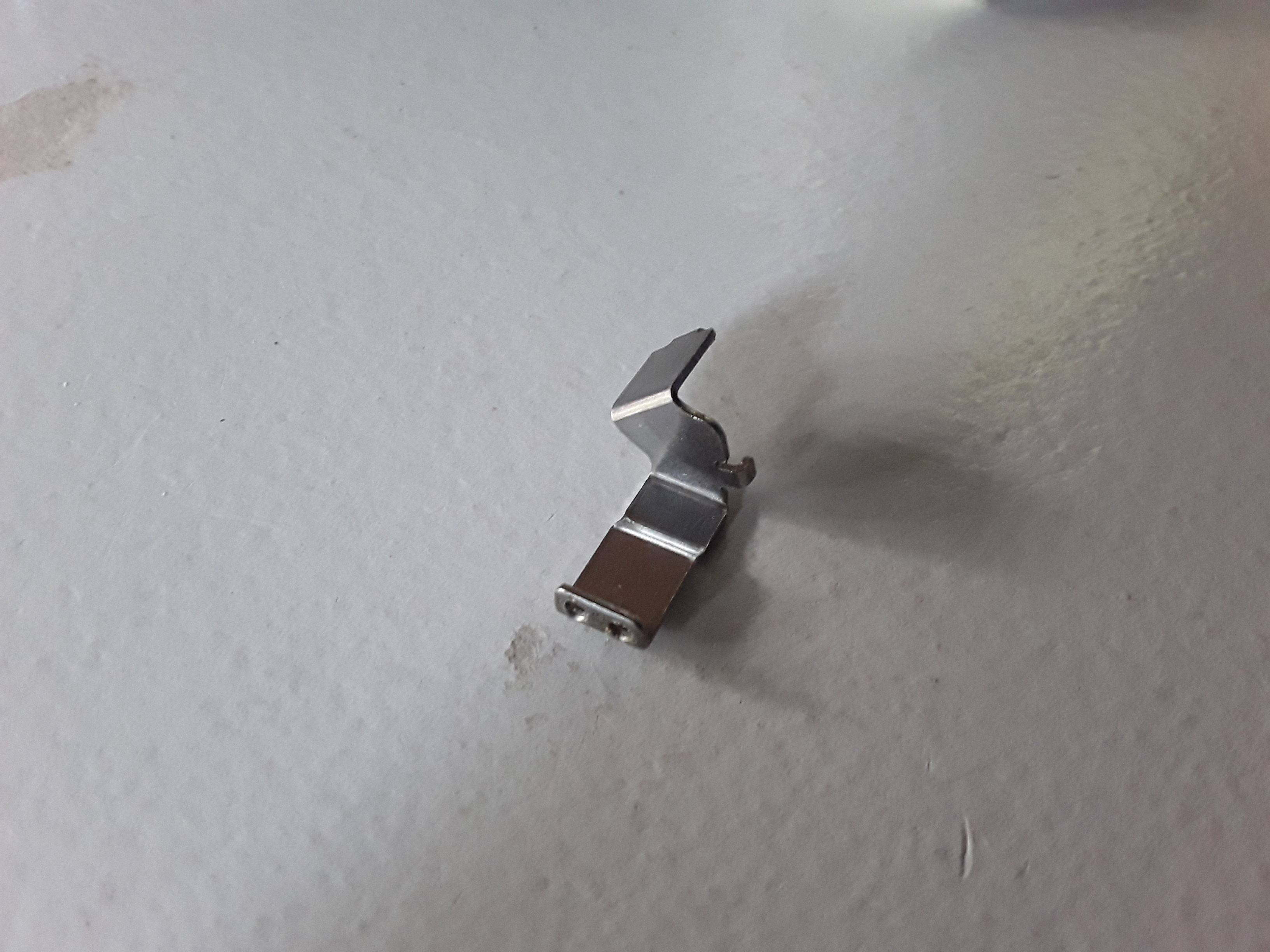

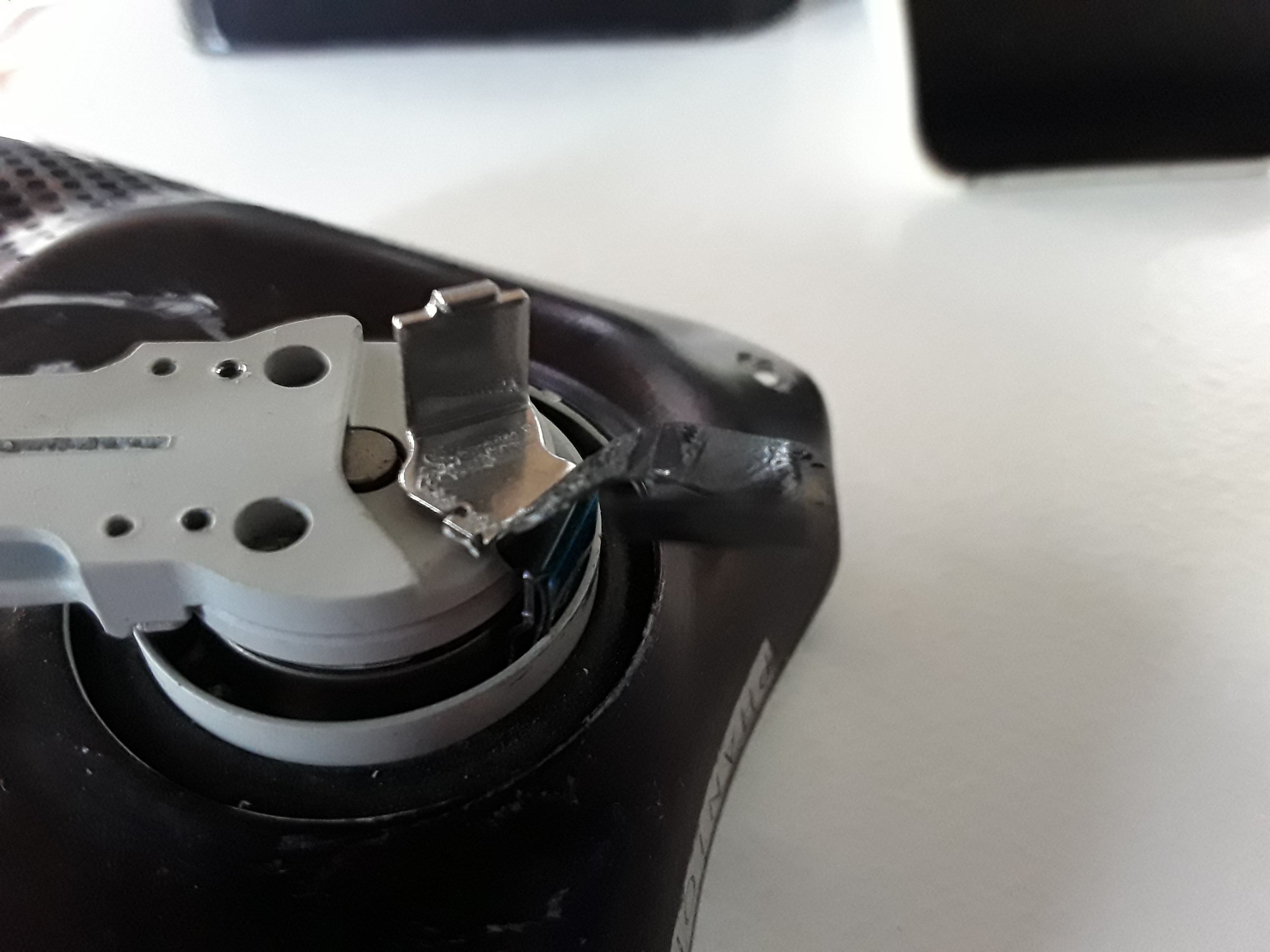

Ok I tore apart the battery was going to charge it with my other charger bit I have the wrong connections. I will have to buy them later. On a side note do you know where I can get the bracket that is on the yaw motor I cant find it on the internet.

OK this one off ebay but there a few on there,amazon might have cheaper one,,I just got a do something so I check back soon ,I see if I can find moreView attachment 111886

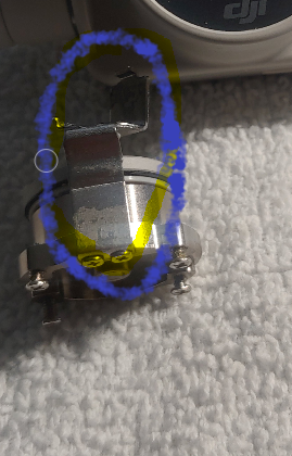

Thank you i found the yaw arm all ready i need the metal bracket that is on the yaw motor in the picture above.
OK me had quick look but unable to locate this part,,I'm doing 3 things at once so I have good look shortly and post when I find it,,yes everything but this
Reactions: mreidiv

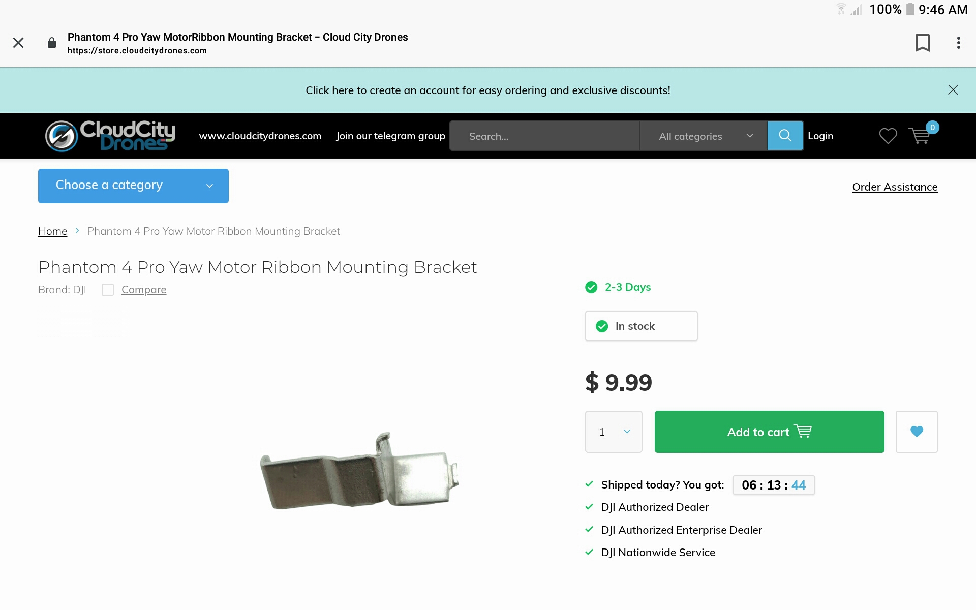

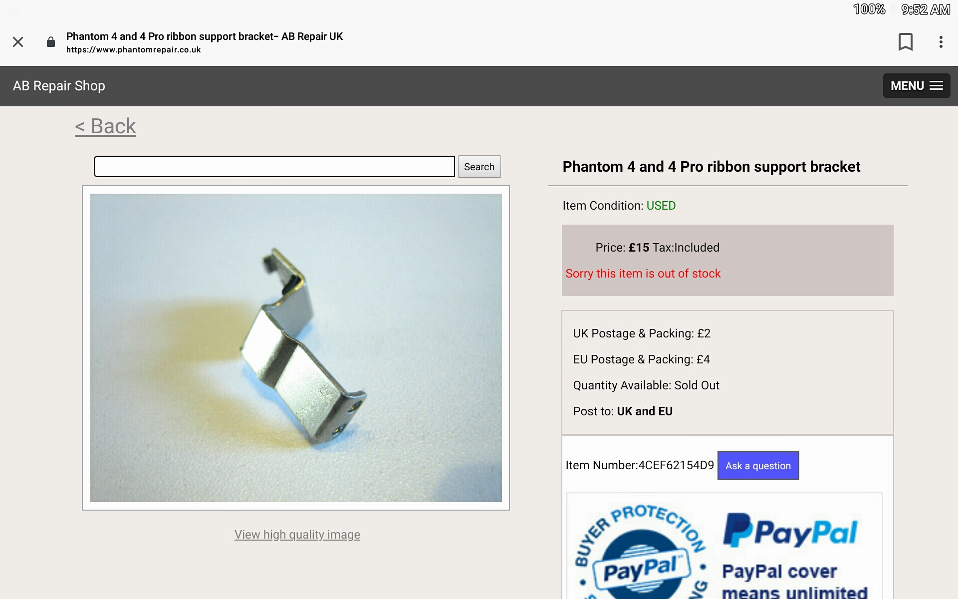

I found out what it is called just cant find one to buy lol. (phantom 4 ribbon support bracket)
OK now we get somewhere....top pic shows for p4p,,bottom pic show p4p and p4 are compatible with this part,,,personally I would try fix other aswell,,being a panel beater I love to reshape steel
That is it. I just ordered one but thankyou. What is wrong with your gimble?
Um,,nothing,serious , snapped cam off on impact from free fall from bad battery,,was my own fault ,,to much in hurry to fly and put wrong batt in it,I knew straight away what was coming but I was already at 400ft,,100%on take off but critical voltage alert ,,it was bit up the road and manage to get it just over head before big wobbles start uncontrollable down to 72ft where the batt turned OFF,oh well at least it hit my concrete roof,shatted the tile and me p4,,bounced off on to the lawn below,gezz you should have heard the impact,,that's what tore my esc cable,,I have slowly been buying bits just to have 2 xp4s up and running,,this why me not like these batteries,,they got mind of there own..
