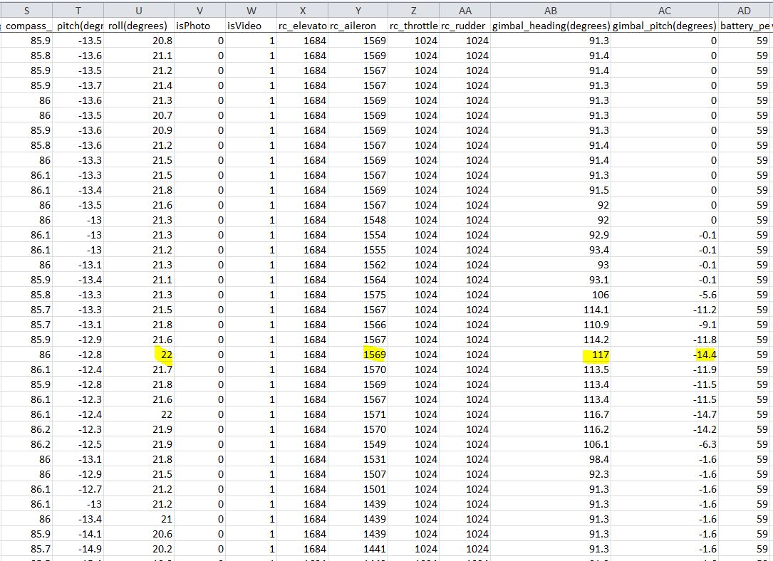

Dawg...I think I have it figured out.. following is a screen print of a portion of the .cvs file. The horizontal line with yellow highlighter is 8271 feet where the incident occurred. You don't see the 8271 because it is scrolled off the screen. Column U is the roll of the drone, Y is the control input for the aileron, AB and AC is gimbal heading and gimbal pitch. Drone roll and rc input for aileron are values are constant. The gimbal values however are all over the place. That tells me that you were correct.. this is likely a gimbal issue. It's not the most professional looking, but it works for me. Also I don't see any claw or teeth marks on the drone from a bird. And if it was a bird it would likely be erratic movement for more than a second or two. Thanks man... Have a good one.
