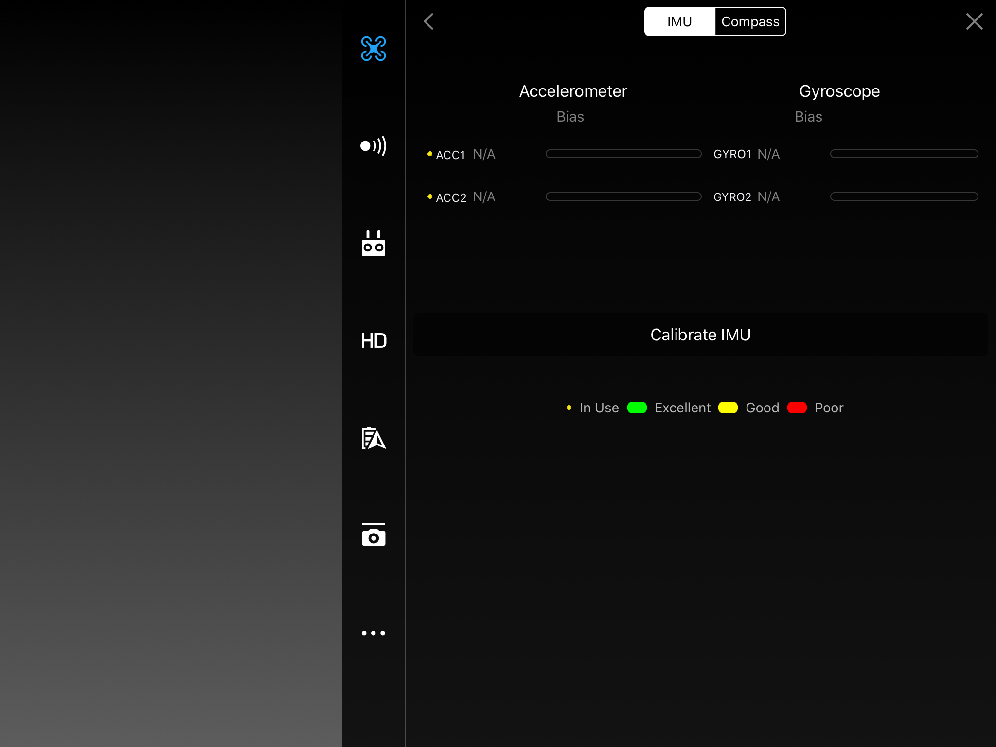

The imu calibration is done in app (takes few minutes). Not just the normal one done at startup. Can be done inside on a level table. Follow the directions exactly.
Main control settings, Advanced settings, sensors, gets you here.
