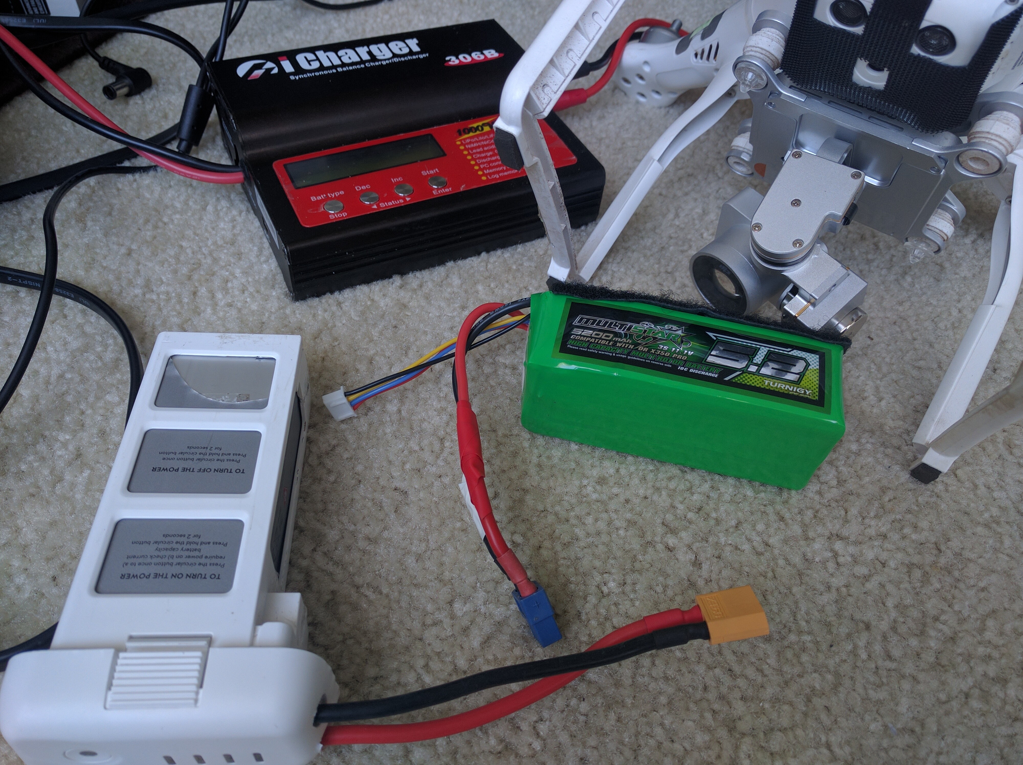

I've got the following setup:
- Phantom 3A
- Dual battery mod with multistar 5200 3S 11.1V
First, how are people charging the LIPO? I'm charging it with my iCharger (as can use the battery balancing) prior to attaching. I'm reading about charging it with the DJI battery, how can you do this w/out connecting the cell balancer?
And -- when finally getting this bird in the air, it quickly starts draining the DJI battery and I didn't have it up long (less than 5 minutes). Bringing it down, the DJI battery was SUPER hot to the touch. I've attached the multistar 5200 underneath the ultrasonic sensor, and the app didn't seem to like that - GPS etc never really locked in.
Thanks - any advice here on this setup would be a big help...
Check that battery again and let me know did you say 3S 11.1 V. Because that will not work with your PA 4Sbattery. And that would answer why your main batteries getting fried
Reactions: Mark The Droner

The app can't read the percentage of the externals it only reads the main battery so the percentage that it shows is the percentage that your main battery has left. Although your percentage will go down slower because of the juice being fed in by the externals. So your battery percentage should be correct. The only reason it would autoland with such a high percentage would be because of one of the cells being so low. I would definitely charge it all up again and give it a short range test. Personally I've had trouble with my horizon modded battery with the balance plug and so have two other pilots that I know of. My opinion is that charging the split pack through the main battery sometimes causes the main battery to be unbalanced and might be hard on the main battery. If you have an LiHV capable charger I would recommend charge in the split pack that way and the main battery with the DJI charger

Finally finished putting together my dual battery setup and wanted to share the final product with everyone. Its a Horizons FPV Battery mod with the 5200 LiHV split power pack. I got some cf trays from RCHobby, they turned out to be too small for the landing gear so i modded them and used some zip ties and a few holes in the legs. I think it turned out quite well, it fits nicely and looks good. I've put two, 8min flights on the batteries and its flying well. Hope to get more time later after family obligations are gone :)
Thanks again to everyone here for sharing information, this has been an amazing place to learn information and be with like minded folks.
