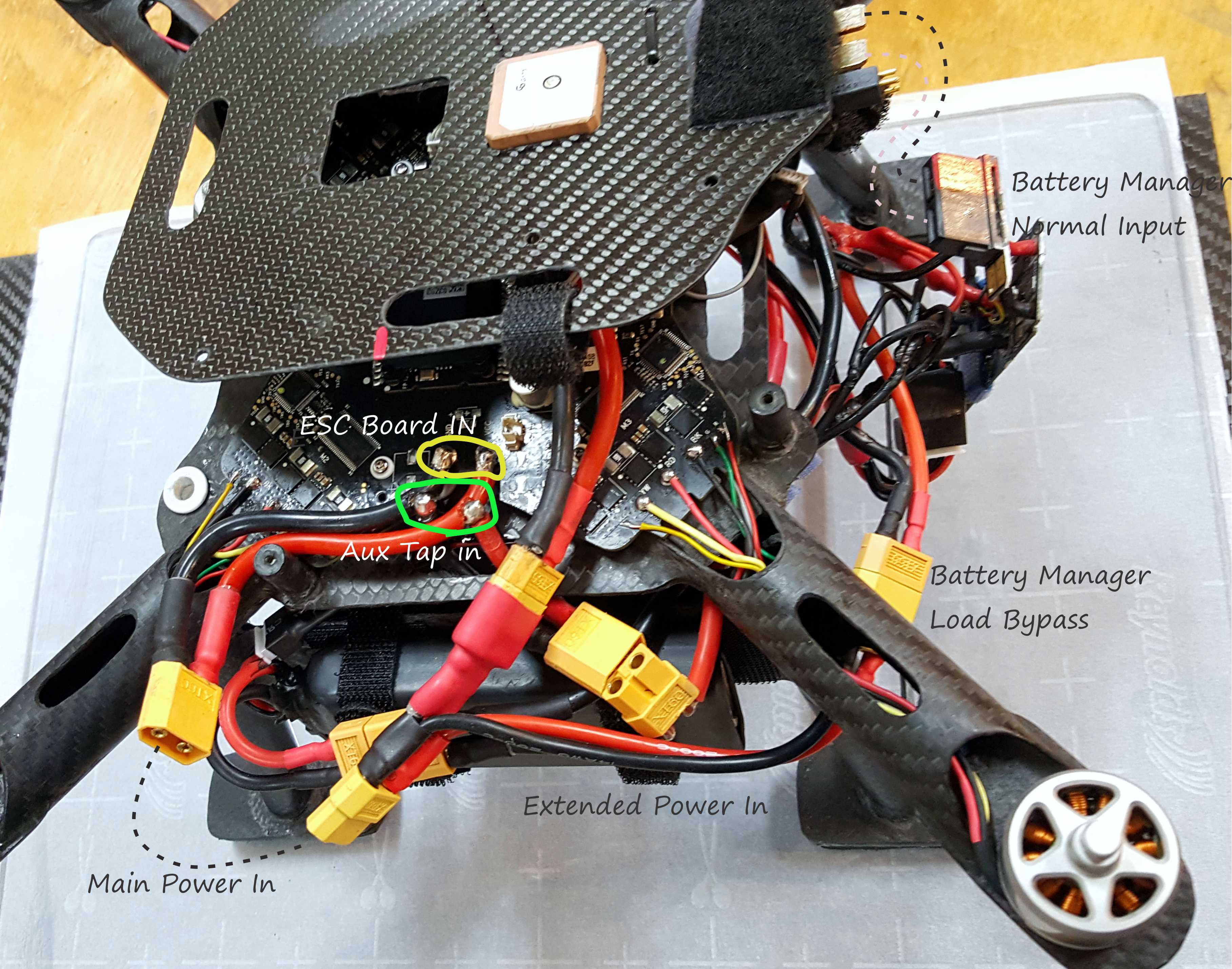

OK, to describe a little better, in this context, what I discovered: I created a connection very similar to the connection the extended battery has after the battery manager to the primary battery. The connection must be left open normally, otherwise the copter will start up. The copter needs the battery manager to arm, however.
So, I start the copter the normal way and it arms itself and initializes. The amperage helping circuit is simply a male/female plug I just connect at this point. It is 12 gauge wire. Knowing that electricity is going to follow the route of least resistance, how would you guess the real power is going to flow? This is also going to take a load off of that poor battery manager. It should stay nicely powered to keep the copter armed and informed of the voltage?
Copter lands, I pull the plug and turn the copter off. I want you to note that I was able to, for the first time, use a single battery, a Hyperion HV 5200 that I split into two 2s’s wired in series and I was able to fly it down to 3.33 volts. Before this, I did nothing but cuss at China… There is no reason this wouldn’t be appropriate for dual battery configurations. My next wire job will just have a switch, I think. What do we call the switch? (The screw DJI switch?)

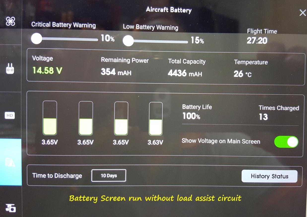

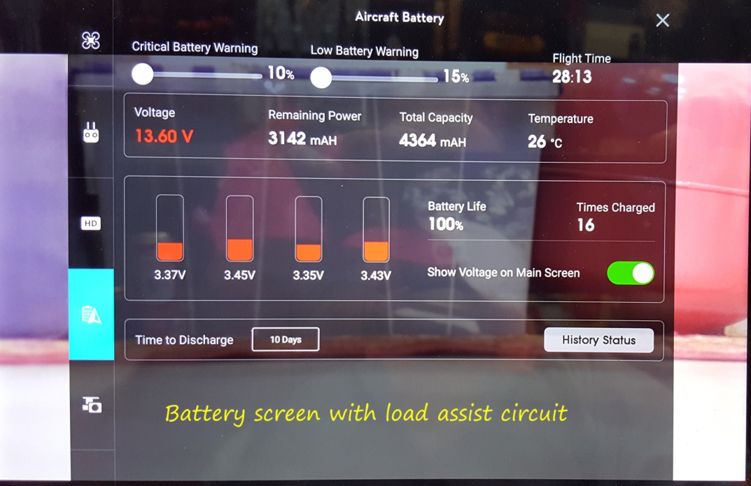

I ran a test with a dual battery configuration on my custom copter and was reminded that the dual setup works pretty well. I have attached pictures of battery screens showing results. The percentage system allows a pretty thorough discharge of both batteries.
Then I ran the same test with the load assist circuit (AKA ‘Screw DJI Switch’) and was reminded of how I got there in the first place. There was no comparison between the two flights in terms of stability. I could actually take my hands off the transmitter, and relax. I was testing in my basement. The copter was much more stable. The flight times were comparable.
As I mentioned earlier, this method is something I would only recommend for those that truly understand what it is. I see some potential safety benefits (but make absolutely no claims) of having a better powered drone with a shut-down logic with less to go wrong.
I plan on using this method and will post here if I find any safety issues as I use it.
