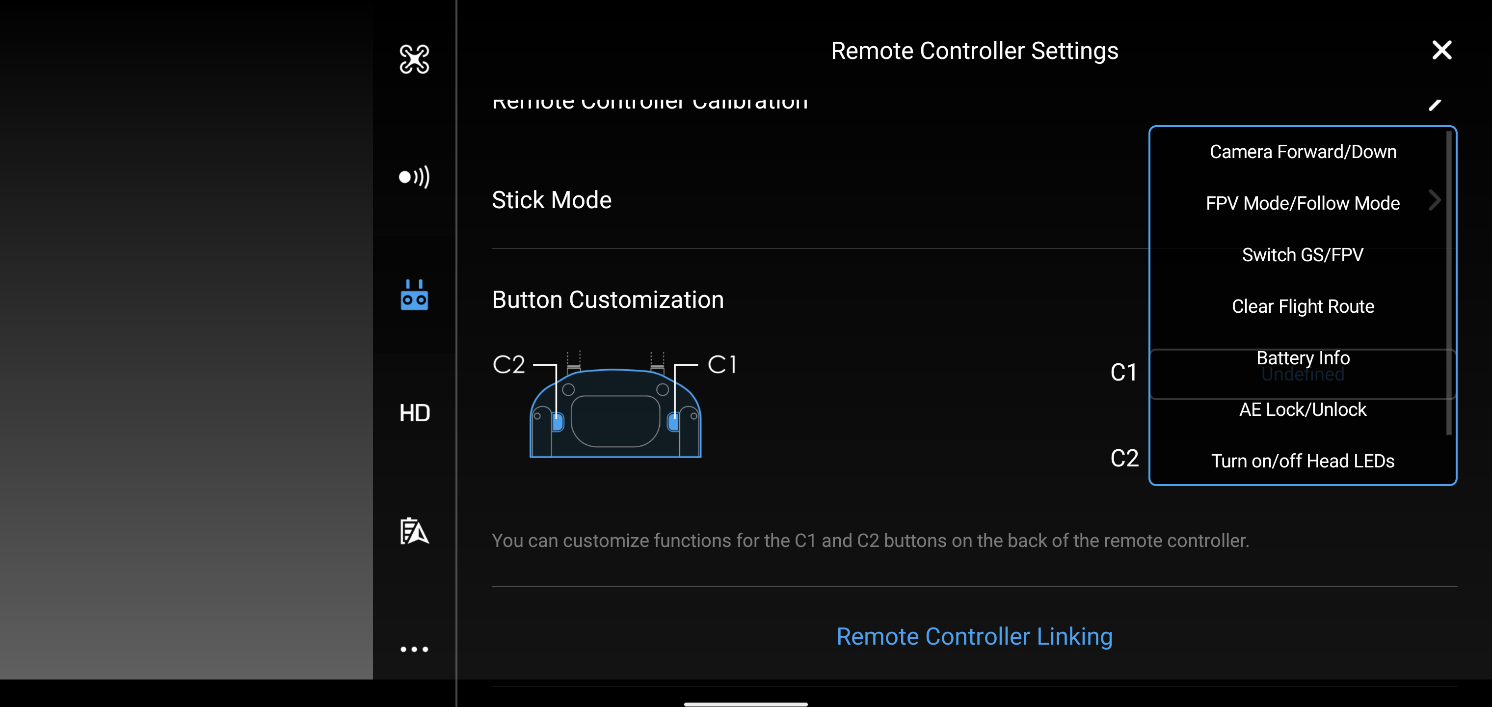

I don't have my Phantom with me, so I can't show you exacly, but in the screenshot below you can set what C1 and C2 can do. While the aircraft is connected, it will give you an option that says something similar to "narrow sensors".
