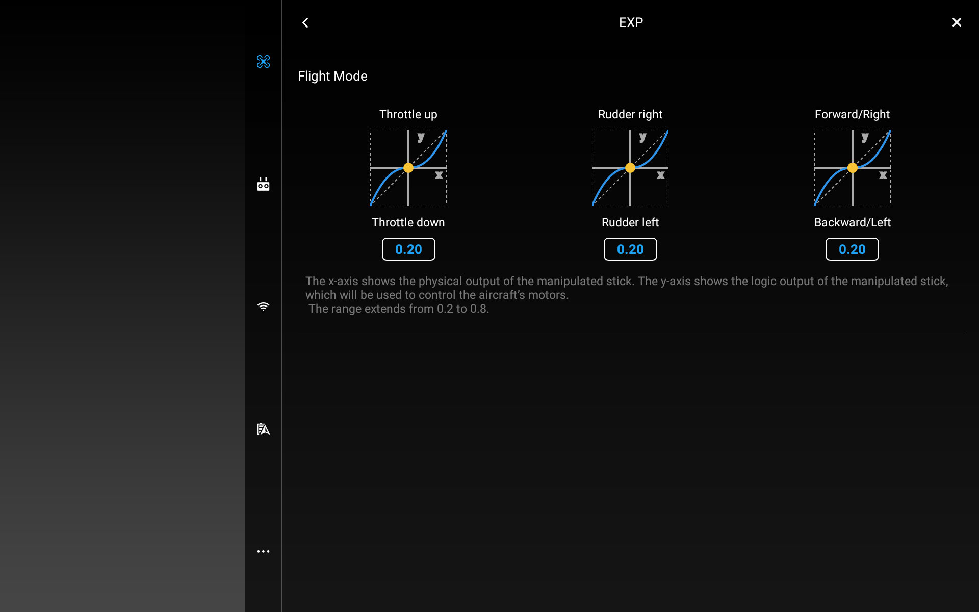

I get smoother panning by going to Main Controller Settings>Advanced Settings>EXP and setting it to Gentle
Or you can manually key in your single preference, Rudder 0.3 or 0.35
It helped me, also unscrew your control sticks to lengthen them.

"I get smoother panning by going to Main Controller Settings>Advanced Settings>EXP and setting it to Gentle
Yes ;)

Thanks for all comments but prefer to stick to DJI go? Eventually managed to work out how to get options to do POI but when I did as in youtube videos, Managed to get it to do 2 POI but it was on top of record button and it didn't save anything so not sure what I did wrong.
Screen capture showing what was quoted above but no idea what the figures mean. Just want to be able to do a 360 degrees rotation while video as though I was standing turning but 100 meters up lol. I have enclosed my fav pic that I have taken to date, ( 360 of this would look good ) only had the phantom for 2 months now. Had Hubsan x4 H501 and so impressed with what I could see, had to buy phantom.
