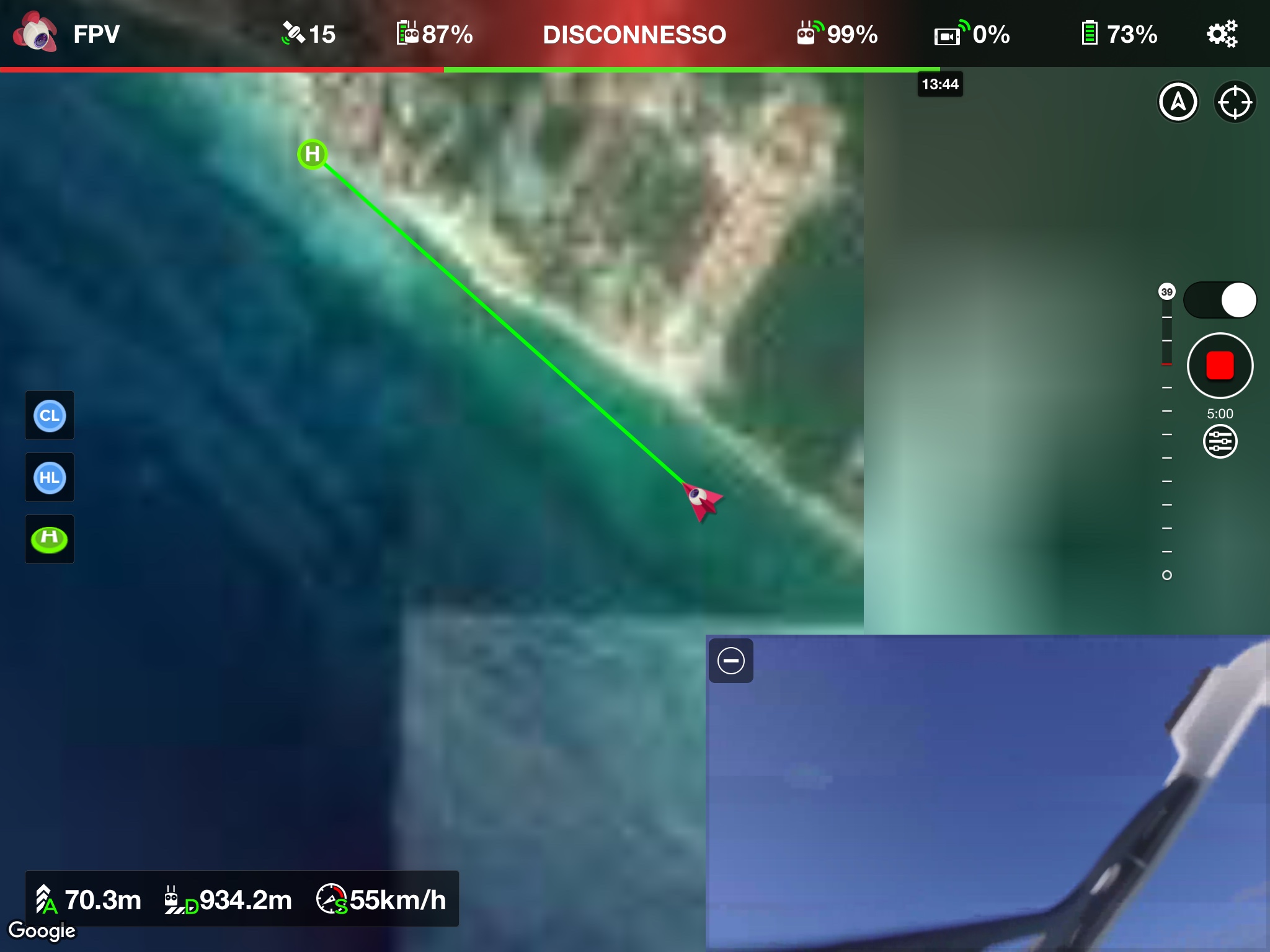

Then the trouble came yesterday as i decided to fly just one battery and i got to the seaside, after checking everything from satellites signal to windspeed i decided to take off and i tried to make a long distance flight of about 2km,
i remained low all the time reaching an altitude of 70m, after I got to 2km I decided to return home with full throttle same as before and at about 950m from me the screen suddenly stopped showing the shore and i saw only the blue sky with a drone leg on a corner.
i was 74m high and going 17.4m/s.
The drone has probably flown about 60m from when i lost signal.

We will need to see your flight logs. From your description, this sounds to me like a bird strike. It may be possible to make some sort of determination from the log. Upload your flight log to the link below ( Instructions are on the link ).....Then place a link back here to that.

If you can provide the flight data, it might be possible to give you a likely search location and some idea of what might have caused the issue.

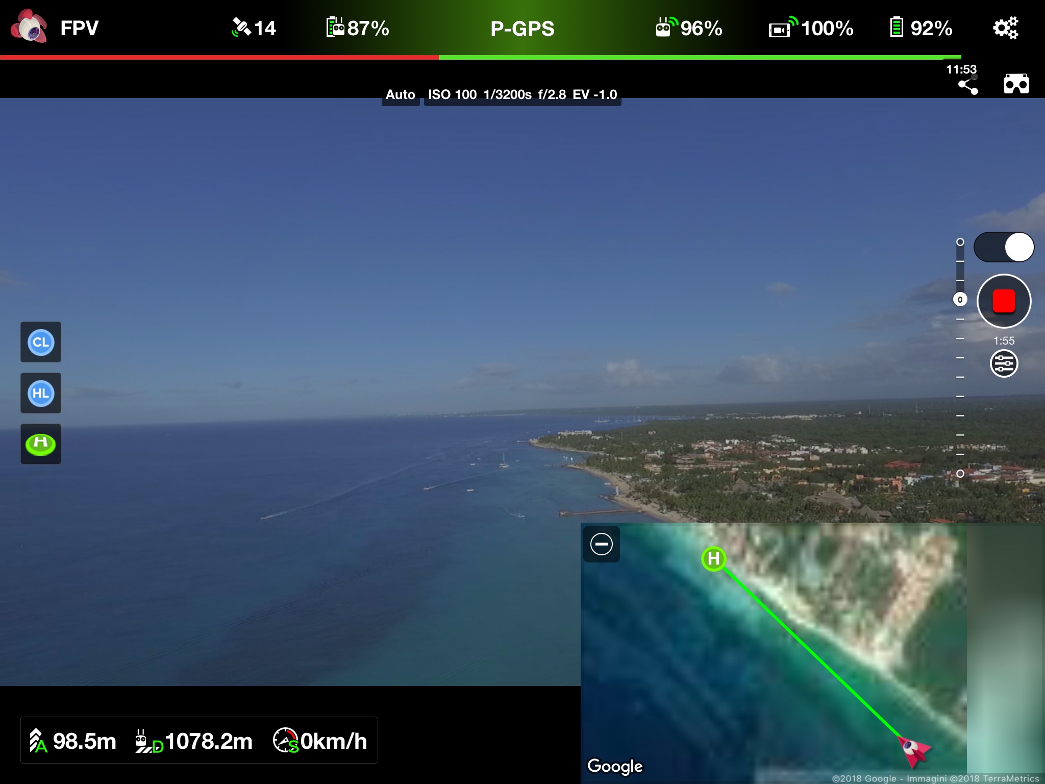

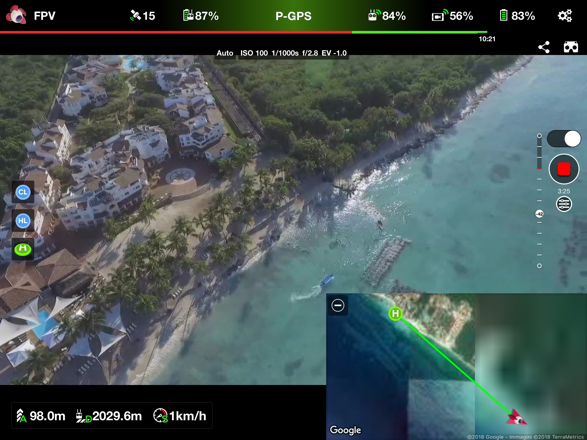

Also as a sidenote I would like to let you know that i was using litchi app so i didn't get any video of it, i just have 3 screenshots showing the drone view at 1000m - 2000m and the last frame given to me.
View attachment 106974View attachment 106975View attachment 106976
